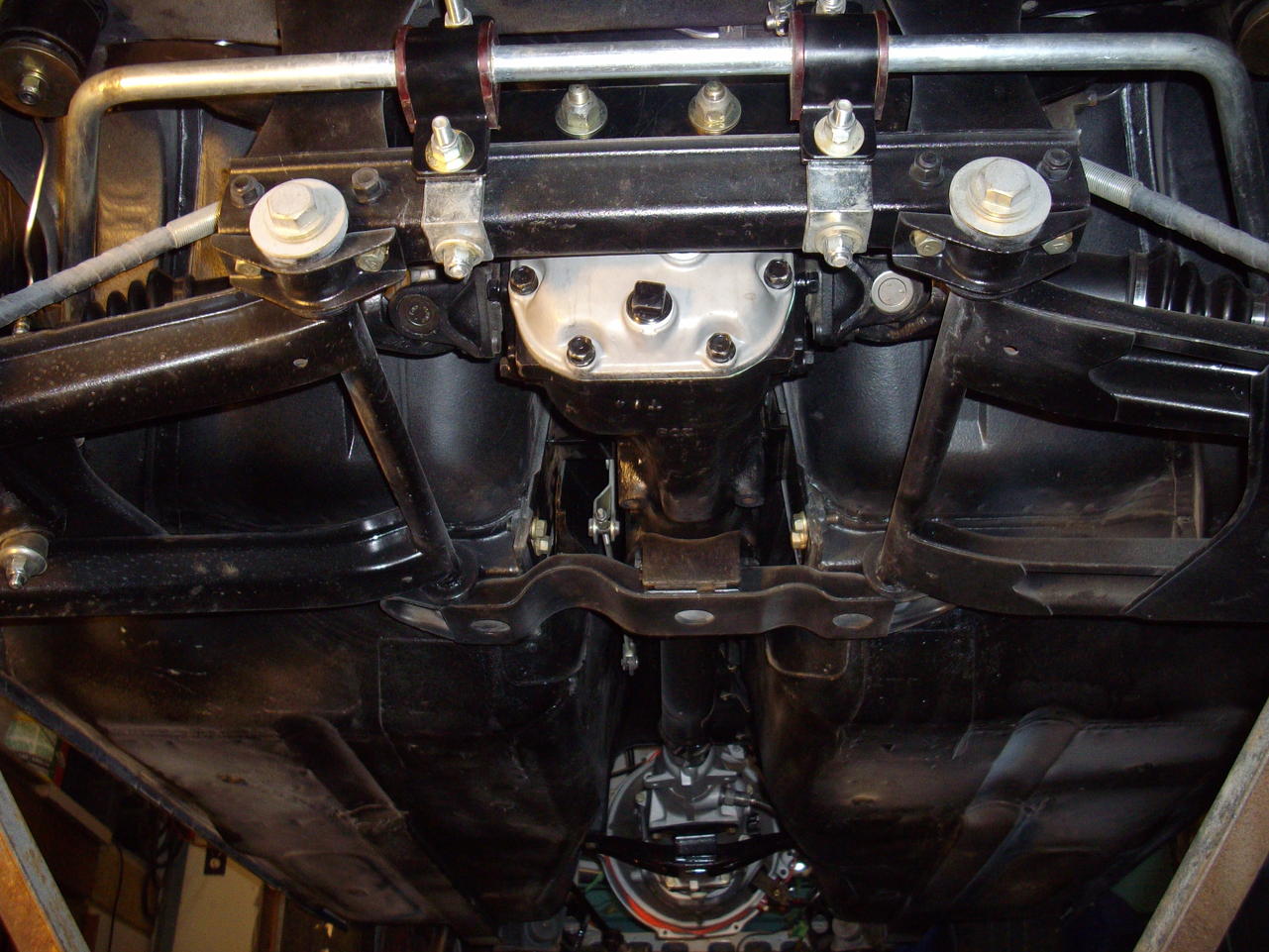

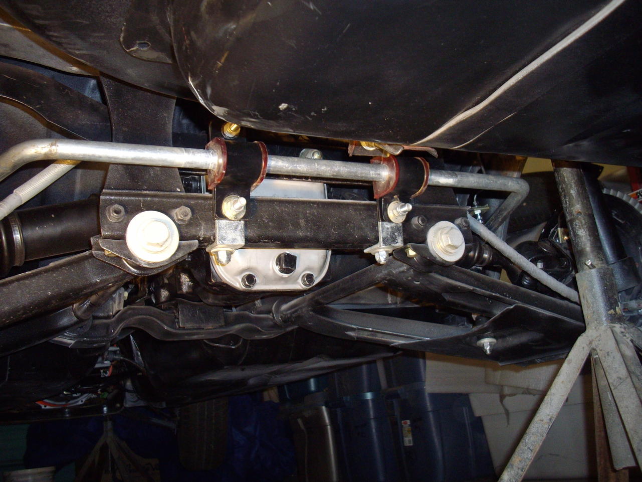

Your car looks fantastic. Did you replace or refinish your brake/fuel/clutch hard lines? Would you mind elaborating on that?
Thanks...
Sure, I used a brass wire wheel on a elec motor to clean them, and then used "never-dull" to polish them up. I then sprayed a clear coat. They are silver rather than the zinc-cad finish. My plating system is not large enough to do them so I will live with the wrong finish.
