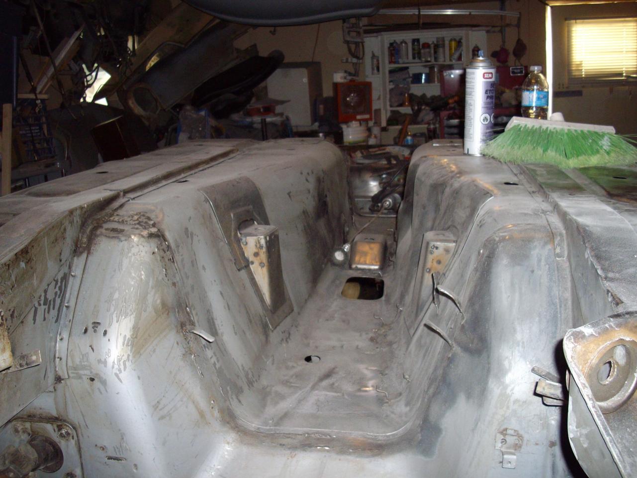

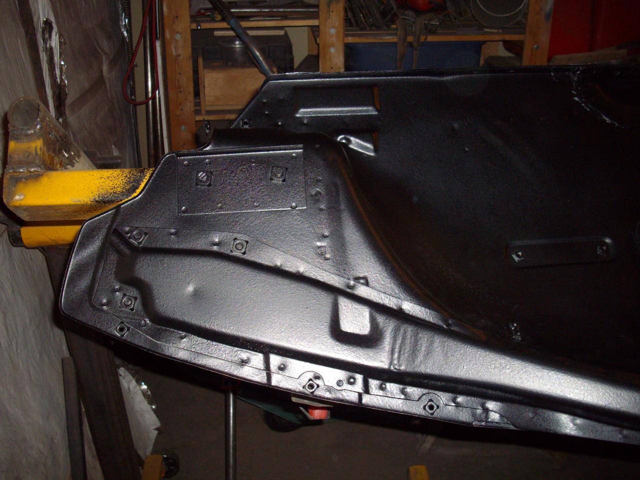

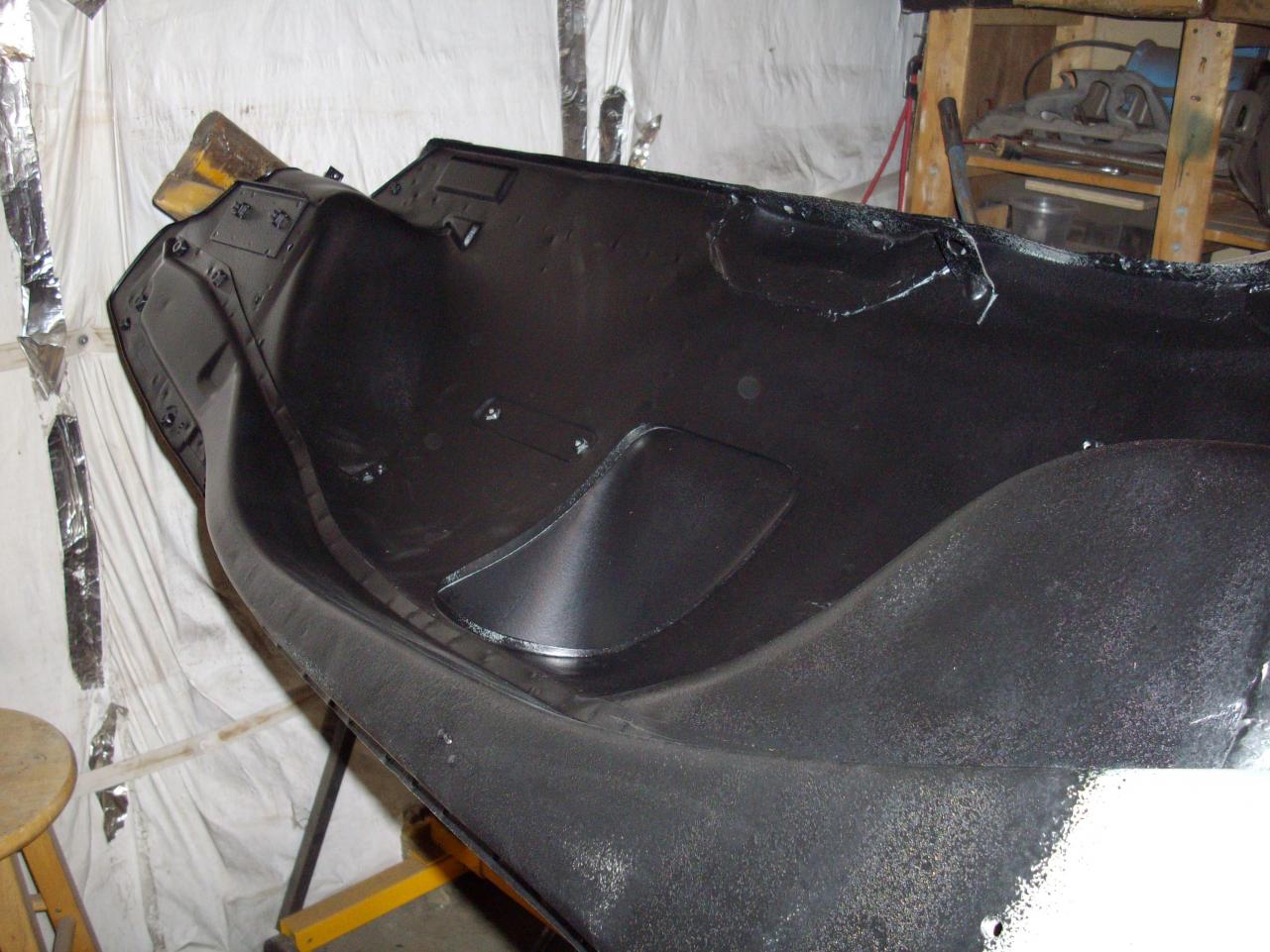

August 28, 201212 yr Author comment_399949 So, I finished the work on the hatch/tail light area and decided to clean all of the old undercoating off the bottom of the car. After getting tired of laying on my back and the stuff falling in my face, I put the car on the rotisserie and flipped it over. The job went better after that. Link to comment https://www.classiczcars.com/forums/topic/36693-progress-on-rust-repairs/?&page=4#findComment-399949 Share on other sites More sharing options...
August 28, 201212 yr Author comment_399950 I have decided to go with a etching primer and paintable spray on undercoating. It seems to have about the right texture. Here is how it looks on car. I will paint it with the same color as the car before I flip it back on its feet Link to comment https://www.classiczcars.com/forums/topic/36693-progress-on-rust-repairs/?&page=4#findComment-399950 Share on other sites More sharing options...

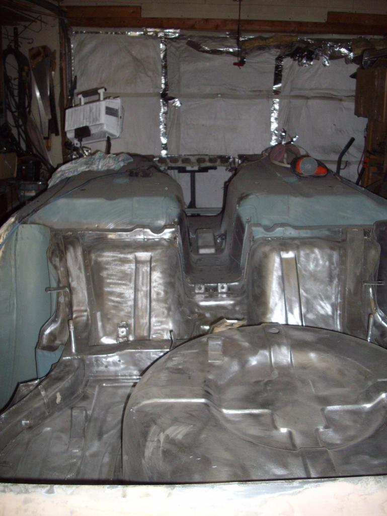

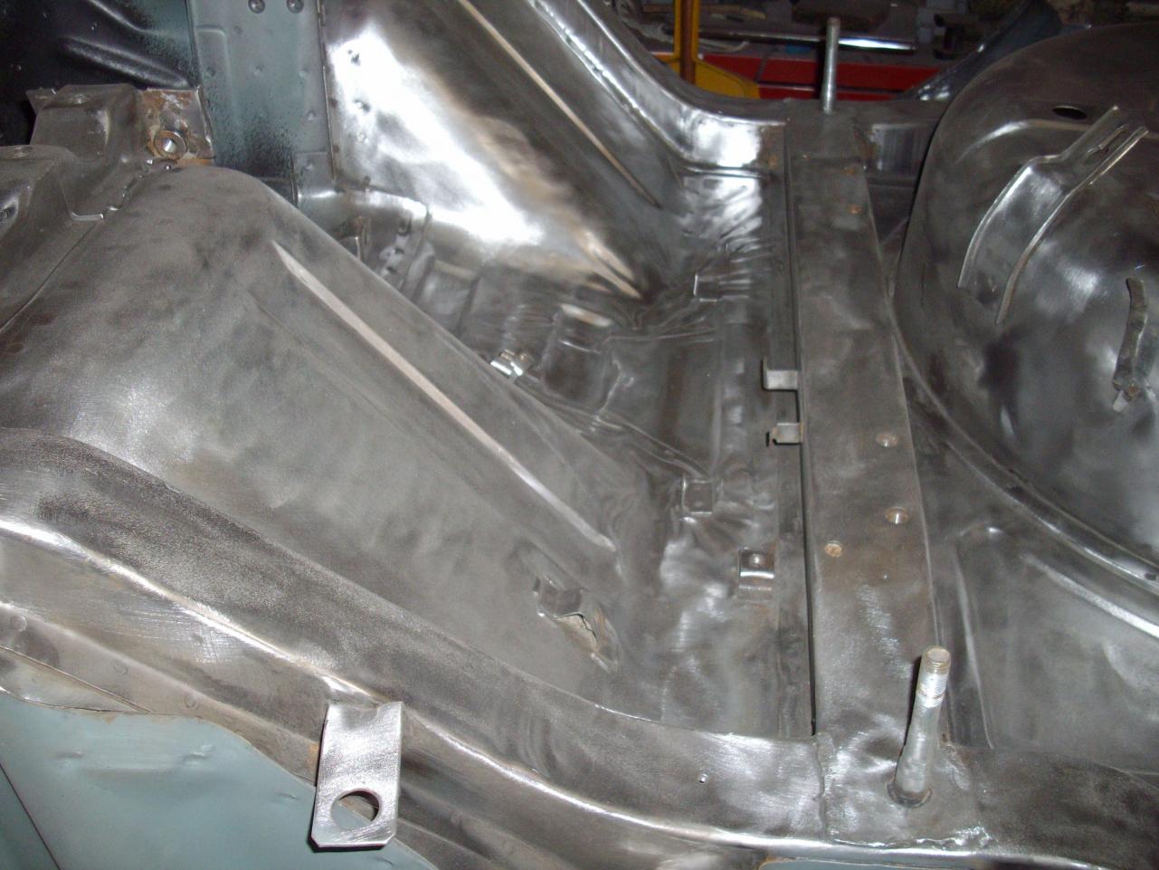

September 4, 201212 yr comment_400653 Time for an update. I have worked my way around the car to the right rear quarter, here is a photo of the old one removed. The only bad spot underneath was the dogleg area. After cutting out the bad, I treated everything with the silver POR15. next up is to weld on a non rusted rear rocker section and then the new rear quarter.These are awesome photos, first I've seen these types of pictures. I find the middle two photos especially enlightening. Link to comment https://www.classiczcars.com/forums/topic/36693-progress-on-rust-repairs/?&page=4#findComment-400653 Share on other sites More sharing options...

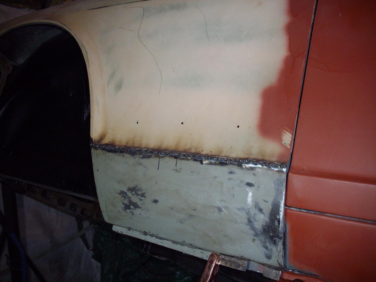

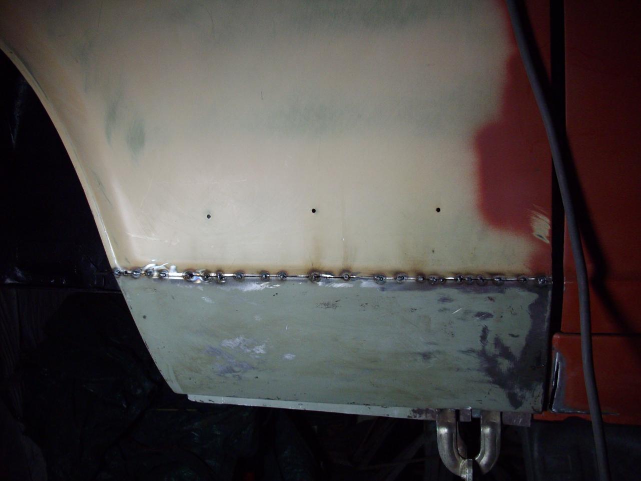

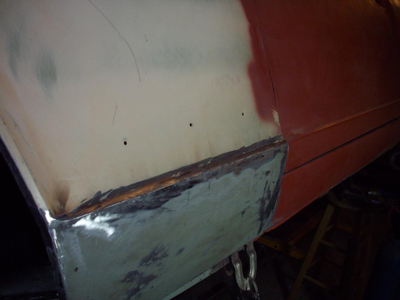

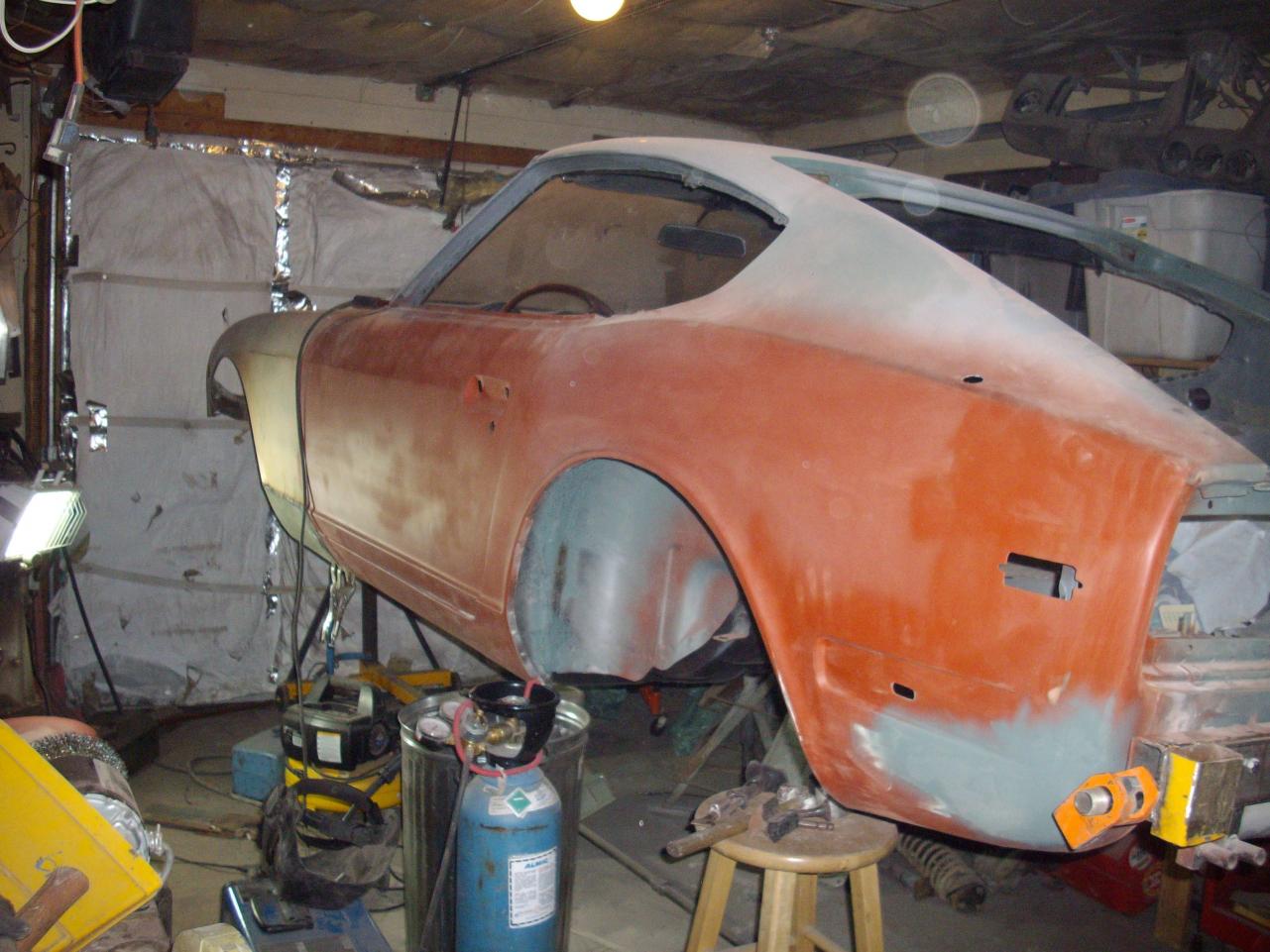

December 11, 201212 yr Author comment_408920 Time for an update. So I thought I was done with the rust until I pulled the fenders out of the pile in the corner. Lower panel behind the front tire not so good. Cut it out and welded a new one one. Photo one is the bad cut of, two is the new panel tacked on, three is the panel all welded up and four the finished job. As well here is a pic of the car so far. Link to comment https://www.classiczcars.com/forums/topic/36693-progress-on-rust-repairs/?&page=4#findComment-408920 Share on other sites More sharing options...

December 11, 201212 yr comment_409000 That is some great progress Dan! You are truly neck deep in that car. I have been tackling some of the rust repair on my '72 as well and yours gives me more motivation to carry on. Can you tell us what kind of welder you are using and what you have it set at? When I have welded some butt joints together I am still blowing holes through it. I have Hobart Handler 150, set on 1 for power, 5-6 for wire speed, using .024 Hobart wire, and my gas set at around 25-30. In some of my repair work as can be seen in your pics there is no way to put a backing plate on the spot you are welding. If you do blow a hole through the metal how do you go about repairing it without making the hole bigger? Any info will be greatly appreciated by all! Link to comment https://www.classiczcars.com/forums/topic/36693-progress-on-rust-repairs/?&page=4#findComment-409000 Share on other sites More sharing options...
December 12, 201212 yr Author comment_409040 That is some great progress Dan! You are truly neck deep in that car. I have been tackling some of the rust repair on my '72 as well and yours gives me more motivation to carry on. Can you tell us what kind of welder you are using and what you have it set at? When I have welded some butt joints together I am still blowing holes through it. I have Hobart Handler 150, set on 1 for power, 5-6 for wire speed, using .024 Hobart wire, and my gas set at around 25-30. In some of my repair work as can be seen in your pics there is no way to put a backing plate on the spot you are welding. If you do blow a hole through the metal how do you go about repairing it without making the hole bigger? Any info will be greatly appreciated by all!I use a Millermatic 140 with the automatic setting. The wire is .024 E-Z grind. Is 25-30 CFH or PSI, my gas setting is about 5 PSI as I do not have a flow meter, but even 25 CFH seems high. As far a welding , patience, patience, patience. Do not try to lay down a bead, just a whole bunch of tacks. I use five or six tacks and then move to the other end of the panel and do the same while the first one cools. I jump back and forth and keep checking the whole panel for temp and if it starts to feel too warm take a break and let it cool. Same goes for if you blow through, STOP and let it cool right down before trying to fill in the hole with more little tacks.This link might help, http://www.mig-welding.co.uk/thin-metal.htm Link to comment https://www.classiczcars.com/forums/topic/36693-progress-on-rust-repairs/?&page=4#findComment-409040 Share on other sites More sharing options...

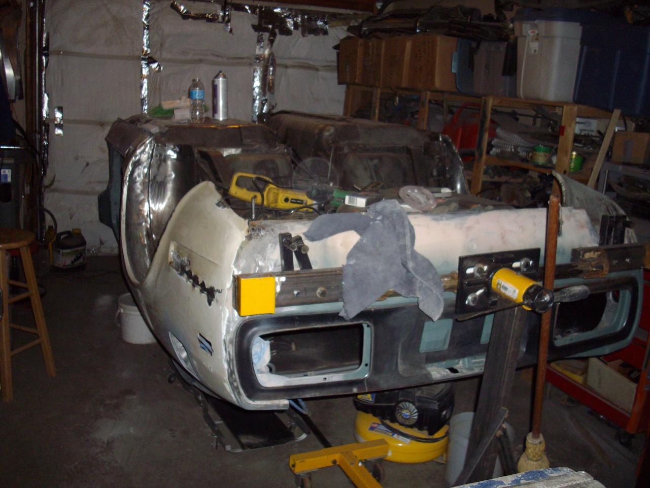

March 17, 201312 yr Author comment_418026 Well, had a small setback, while trying to fit the front fenders, I did not like how everything was lining up. I did a poor job of welding the rockers where they met the back of the front fenders. So out came the cut-off wheel and the welder. After a while everything lines up a lot nicer. Next I went over all of the seams under the car with a sealer and then did another coat of undercoating. Not sure if I am going to leave it like this or give it a coat of paint. Link to comment https://www.classiczcars.com/forums/topic/36693-progress-on-rust-repairs/?&page=4#findComment-418026 Share on other sites More sharing options...
