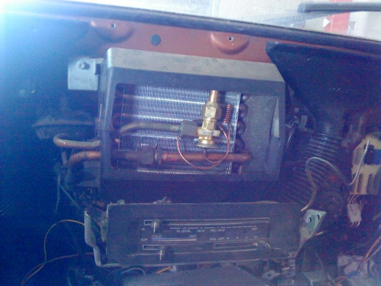

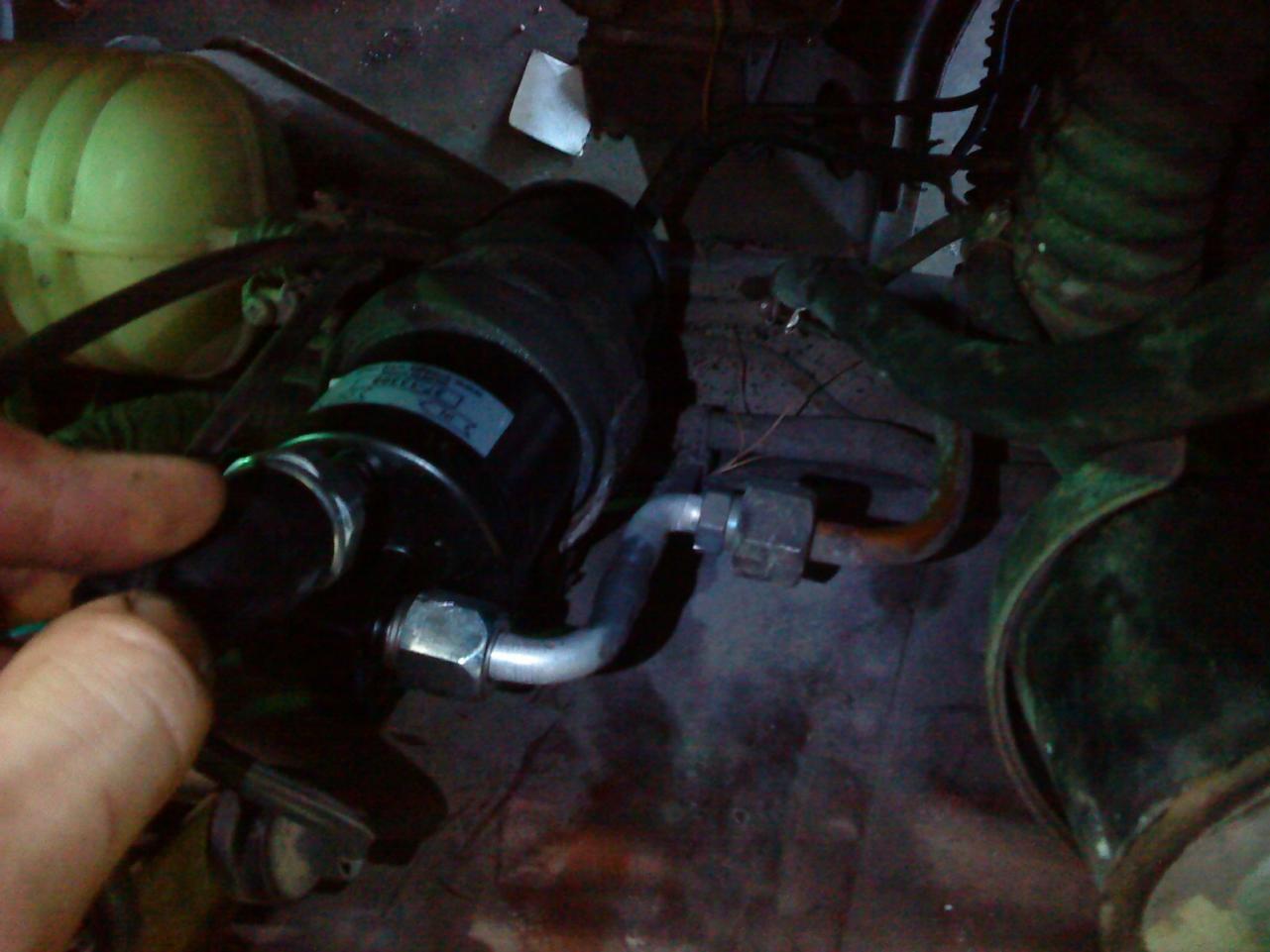

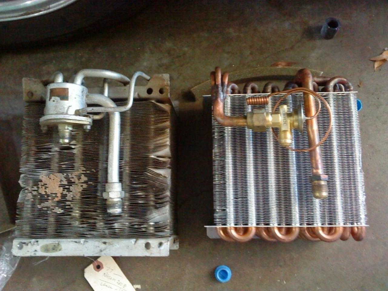

September 14, 201113 yr comment_366386 Figured I would go ahead and update my progress with this. The a/c shop (Austin Rebuilders in case anyone is curious) told me my evaporator wouldn't hold pressure, so I had them order a replacement in which I could install a modern expansion valve with. I also had them make me a line with 2 90* bends so I can use a generic universal drier along with a common pressure switch. The evaporator was pretty close to the original size, but I still had to trim the metal on the top of it to get the housing to seal up all the way. I hooked everything up but it still won't hold vacuum (loses 30" in 5 seconds so it's a huge leak somewhere). I haven't replaced the rubber discharge line between the compressor and condensor so I'll replace it tomorrow and go from there. Even if it's not the source of the leak, the peace of mind is worth it. Zcurves, once again, I appreciate your help with this topic. I have 3 pics of the setup (although they're cell cam pics): - Comparing the old vs new evaporator / expansion valve. The metal I had to trim is on the left side of the new evaporator in this pic: - Everything installed (dashboard removed, obviously): - Closeup of the line I had made for the drier: I do have a question about the compressor oil. I doubt it'd be good anymore since it's been sitting for so long. Do I need to remove the compressor so I can drain out the old stuff or is there a better way of replacing the oil in it? Or does that oil really not need to be changed? Link to comment https://www.classiczcars.com/forums/topic/36744-ac-expansion-valve-repair-and-setting/?&page=4#findComment-366386 Share on other sites More sharing options...

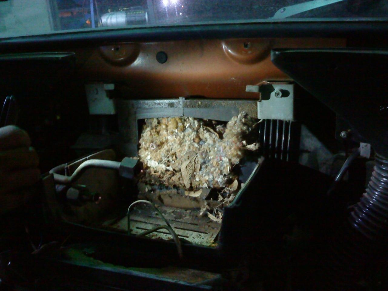

September 14, 201113 yr comment_366387 Oh yeah, and as soon as I removed the evaporator I discovered why my airflow was so poor Link to comment https://www.classiczcars.com/forums/topic/36744-ac-expansion-valve-repair-and-setting/?&page=4#findComment-366387 Share on other sites More sharing options...
