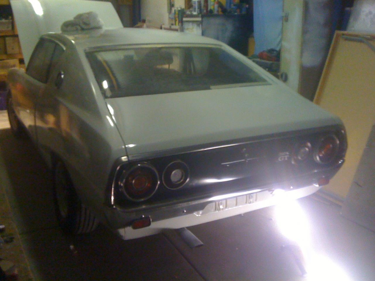

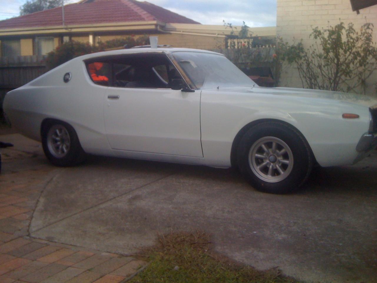

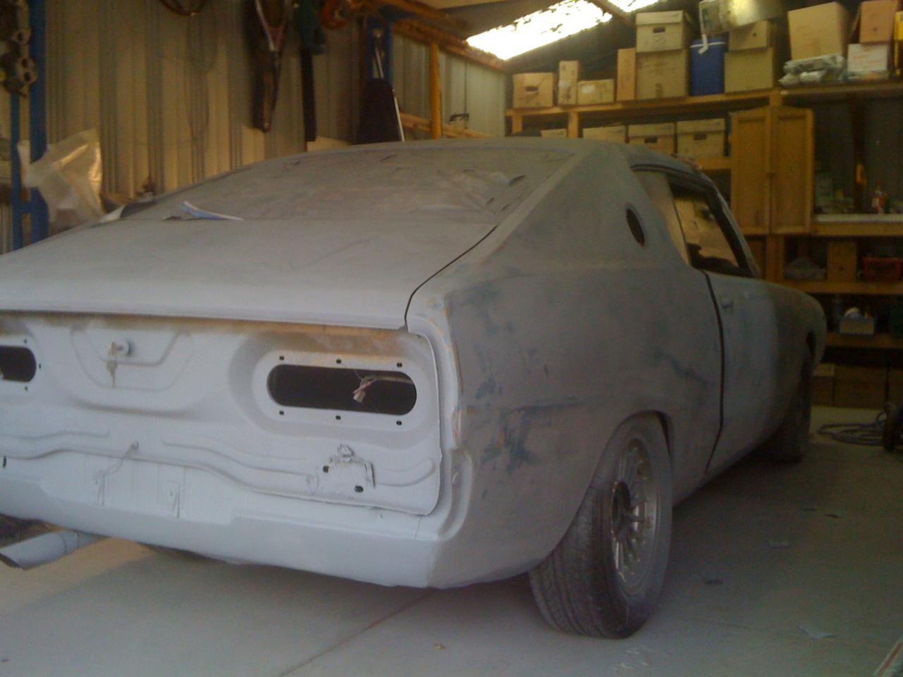

Thought you might like to see another work in progress....
Running F54 L28 overbored .040, flat tops, triple 40DHLA Dellortos, mild cam, 5 speed & 3.9 diff, lowered Kings springs all round.
Recently painted (not show quality but a far better sight than what it was), hoping to get it on the road within the next couple of months....cheers

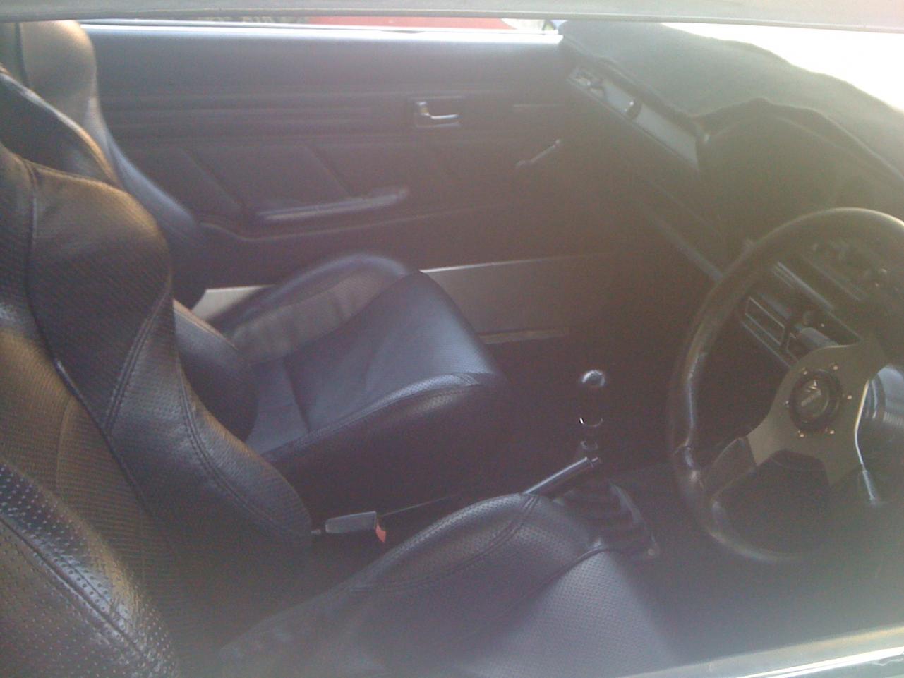

Front seats were from a ebay importing outfit in Sydney, $200 & shipped to my front door for both. Came with universal rails, but used the 240K rails as these only need a few mm drilled out from the rear mount holes, fits & works a treat...!

I'm not too happy with the paint job, initially I wasn't too fussed I was just happy to get it repaired, get the running gear strong, and looking "ok". Now I'm tempted to get it sorted properly, hey Kid K, you spray do you? I'm from Cranbourne, give us a price for a once over, I'll do all the prep work ;)
