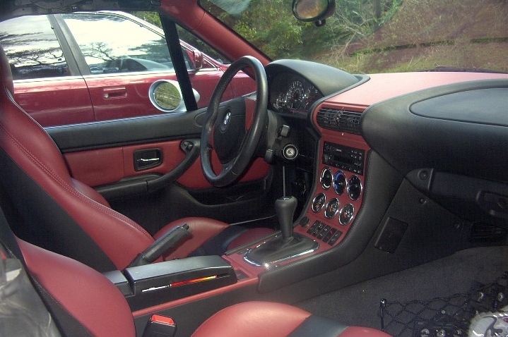

Alright guys. I want the interior of the car to look like this (well, with these colors and seats (http://www.zcars.com.au/userimages/user1093_1175231422.jpg). So I have two questions, both of which I am stuck on:
1. Candy apple or ruby red? I am thinking ruby red because it has an ever so slightly darker and richer look to it.
2. Here is the one I am really stuck on....what kind of car upholstery should I get? I am doing it myself, but should I get tweed or vinyl? I know vinyl holds up a bit more, but I like the feel of tweed a little more. Suggestions?
Thanks!

As far as paint colors go, I will say that Candy Apple Red is a Ford color, but is commonly referred to as a tint of red.
I would suggest looking through House Of Kolor for custom, deeper or more eccentric color tones with or without metallics and pearls. They usually have a less expensive custom line than just about any other major manufacturers color selections of the same nature.
If you want a deep red, I would suggest a tri stage of some kind.
