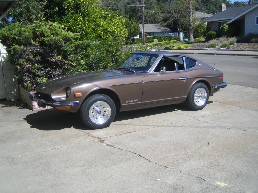

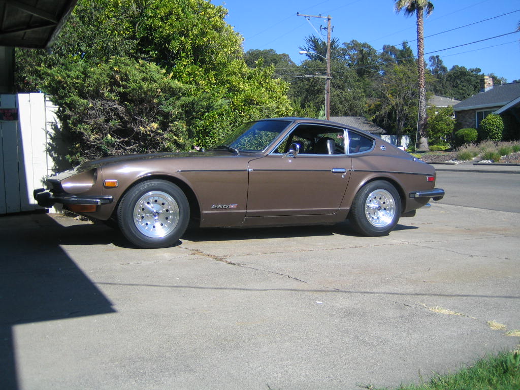

how does your car look with a 3" lift?
It doesn't look as good but it's lot more fun to drive, and not to have that exhaust smell....I'll take it. I'm going to try and attach before and after photos. I'm thinking the extra air passing under the car is disturbing the air in the back.
