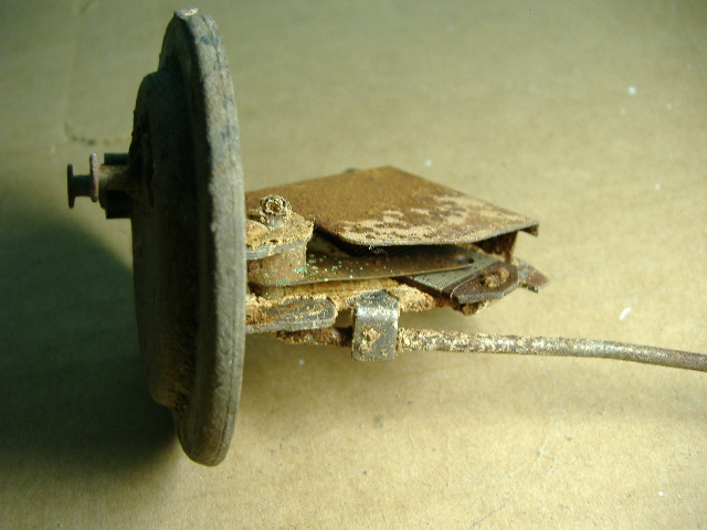

Start with the basics. Since you didn't tell us what Z you have, I'm going to assume it's an S30 (1st gen). Has the car been sitting for a long time? If it has, corrosion of the connections or the sender would be the first thing I would check.
Before you get to pulling the sender out of the tank, your problem could be where the wires are attached to the sender. Mine were broken, so I used solder to make the contact good between the sender and the wiring harness, then covered it up with silicon to protect it from the harsh environment where it is.
Anyway, read that post that was supplied to you and see what you can find. If your still stuck, someone here will try to help, but be as descriptive as you can with what you have done to find the problem. (and include the model of the car too)

The wires you mention coming out of the "tank thing" are the wires are doubtful as that part is the Fuel Level Sensor. They are typically a pair of "t" studs instead of wires coming out of the tank. There should be two wires connected to it for the Fuel Gauge to operate properly.

1) the Fuel Float Sensor doesn't have any wires coming out of it. It has a pair of "T" style connections that a locking spade connector connects to. One is the large size, the other is the smaller size. The two wires that connect to it are a Yellow and a Black. The Black is a ground connection.
2) the Fuel Pump receives it's power via a Green wire, and it's other wire goes to ground.
3) Have no idea what/where the Blue wire you have goes to. A WAG would be that it's the lead from the fuel pump that then gets the Green wire connected to it.
Get the wiring schematic for your year car and much of this will be much easier to trace and fix.
