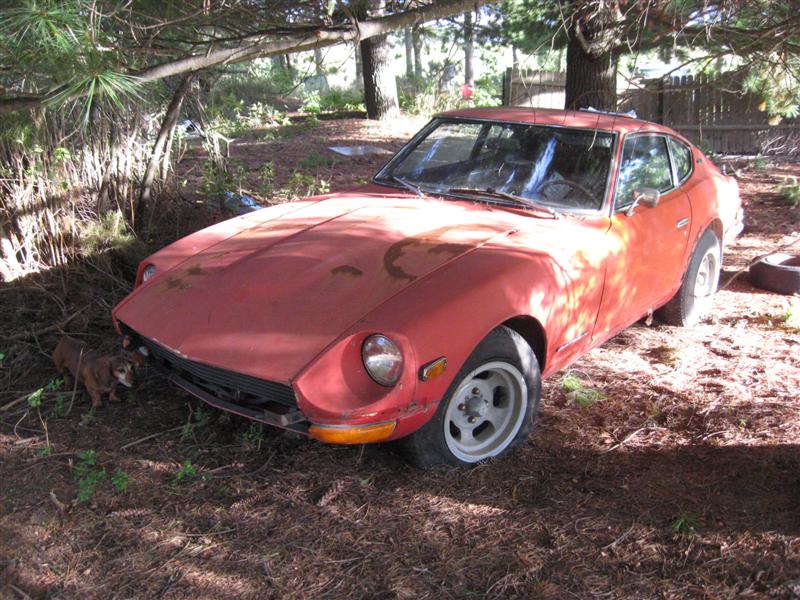

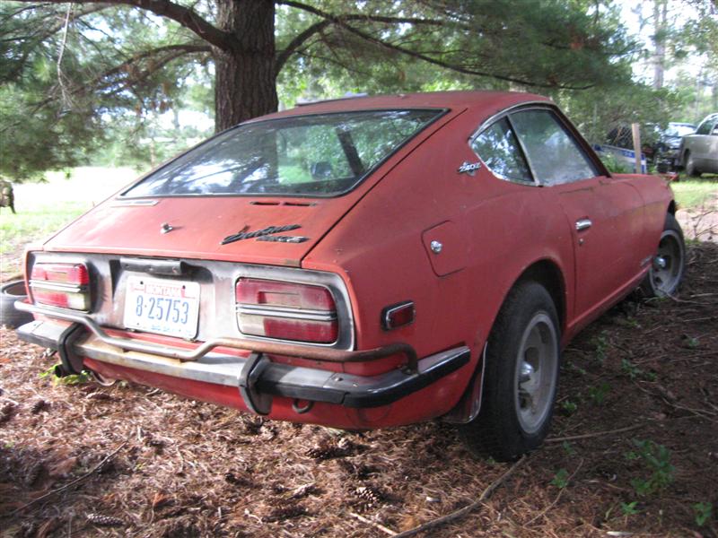

I bought another 240 today. It is pretty much original and numbers matching. I really cannot find anything that is after market exept maybe the bumpers. They both have over riders on them. Not sure if this was normal for 71 cars. I did find evidence of body work on the passenger quarter panel. Just a little paint flaking off but saw the original color under that so it must have been repainted.
The car is a 01/71 production Z and was titled in California for the first 19 years then in Montana for the last year. It has been sitting since 91. The seats are gone from the vehicle but the rest is there in its original glory.
Rust: It has some wheel well/arch cancer on the drivers side, floor boards are good, drivers floor support needs further inspection, Rear sill is great, battery tray looks good on top and feels good underneath and did not flex at all when I pulled on it, tire tub looks rust free from the top.
Glass: All original, non-tinted glass. No cracks or chips. Vertical defrost lines. All window trim is in excellent shape, no dings that I could find.

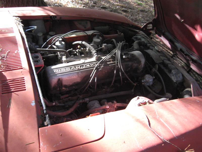

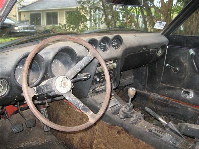

Hard to find/Expensive parts: E31 head, ash tray, seek scan am radio, original pointed antenna, hoodless map light housing, original bridgestone superspeed radial spare (appears unused!), grapefruit alternator, A/C unit and controls, original dizzy and plug wires, heater control panel in good shape, center console is in better shape than my current console, original exhaust system, 3 screw SUs, Series 1 guages, original finned drums, original slotted rotors, Series 1 dash for a core (3 large cracks), unmelted long pigtail fuse block and lid, series 1 fuel door, all badges except the hood badge are present and in pretty good shape, etc.

Here are a few pictures that the seller sent me. I forgot my camera so I didn't get any shots today.

That looks like a good candidate for a restore. Unless you find a show-stopper, I wouldn't part it out.

Looks like a great find and definitely restorable from what the pictures show. Is this the same car you were looking at last fall? The bumper overriders are aftermarket (AMCO). Are you sure the glass is non-tinted? I have only seen non-tinted glass on 1969 and maybe some early Jan 1970 production cars (for the North American market - JDM cars had clear glass for base models). I have also never seen a defroster with clear glass. All the ones I have seen had either clear glass with no defroster, or tinted glass with the defroster. I am also a bit surprised to see a Superspeed radial spare. I thought they switched to the RD-150 by 1971.

Mike, I am pretty sure on the glass and positive on the radial but I consider you to be an expert so you probably are correct. I am really hoping the glass is clear. I have a clear windshield in my car that has some sandblasting and 2 chips. My rear glass is clear without defroster lines but that is in good shape. I have some 73 quarter windows and they have a definite green tint to them. I could not deciper a tint at all in any of the glass on this car but it was a little cloudy today.

Like you mentioned, sometimes the tint is hard to detect under different lighting. The best way to tell is by the number etched in the glass. Non-tinted glass is M-214 for everything but the windshield. The windshield is M-34G. Tinted glass is M-224 for the doors and quarter windows and the hatch is M-2243 (on my 5/72 at least). The windshield is M-35G.

Mike you were correct about the glass. All the glass is perfect from what I can tell.

The engine looks dirty but complete with 4 screw SUs, grapefruit alternator, what looks like the original dizzy, radiator needs recoring, metal fan 3 pully HB, AC is complete, E31 head, common valve cover and oil pan, both engine slingers are intact as are all 4 tie downs/tow hooks.
The interior has the usual cracks in the dash, the console has some aligator cracking but might look better than mine after I clean it up. The heater panel looks great, hoodless map light finisher, seek/scan radio in pretty nice shape, shift knob is a little cloudy but the wood just needs some refinishing as does the steering wheel. The interior panels have a few chips around the edges here and there but I dont think they will show when installed. The wheel house vinyl has no tears yet.(I will see if I can remove it without ripping). The seat belts are original but the latches have some heavy rust. they are dated 12/1970. The straps look salvagable if anyone is interested.
