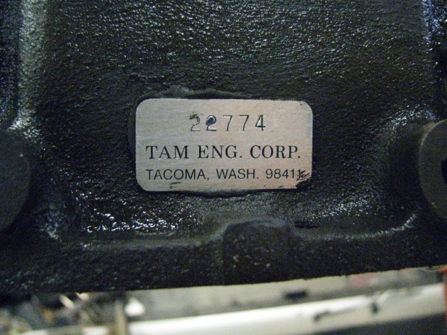

Hey again,
I took the L24 is all apart and it is beautiful!
It looks like it was rebuilt and then just sat. So I'm going to get all new gaskets, maybe new rings for the pistons, it's in such good shape I don't know what else there is to do!!! :classic: It still has the scratches in the cylinder walls from them being honed!
I also found a plate on it that you can see in the last picture. I looked them up online and they are an engine remanufacturing place. I'm going to try and get ahold of them to see what they can tell me about the engine since it has a number on the plate.
I also contacted a machine shop near by and they are going to look my head over for cracks and check the valves and all that.
