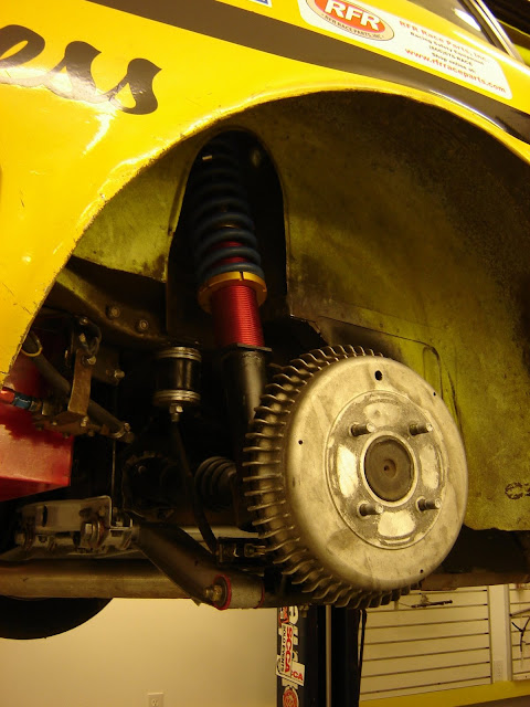

March 8, 201312 yr comment_417161 rxsleeper said: FWIW, I use Hawk HT-10 in front and Carbotech Green shoes. If you can change to discs all around, you should. Aluminum drums are unobtanium these days.There is a thread on the aluminium brake drums. They are still available, but they are getting hard to find.http://www.classiczcars.com/forums/wheels-tires-brakes-s30/48550-new-source-s30-aluminum-brake-drums.htmlDatsunparts.com Partnumber 2550 Datsun Z Car 70 - 78 & 510 68 - 73 Rear Aluminun Finned Brake DrumChas Link to comment https://www.classiczcars.com/forums/topic/37048-brake-recommendations-please/#findComment-417161 Share on other sites More sharing options...
March 8, 201312 yr Author comment_417162 Other than weight savings, is there any other advantage? Also, Rxsleeper suggested that we ventilate the rear drum backing plates. Where's the best place to get air to do that? The front is easy... just steal air through the headlights and fog lamp openings. Is there a tried and true way to get air to the rear drums, or should we just experiment? Link to comment https://www.classiczcars.com/forums/topic/37048-brake-recommendations-please/#findComment-417162 Share on other sites More sharing options...
