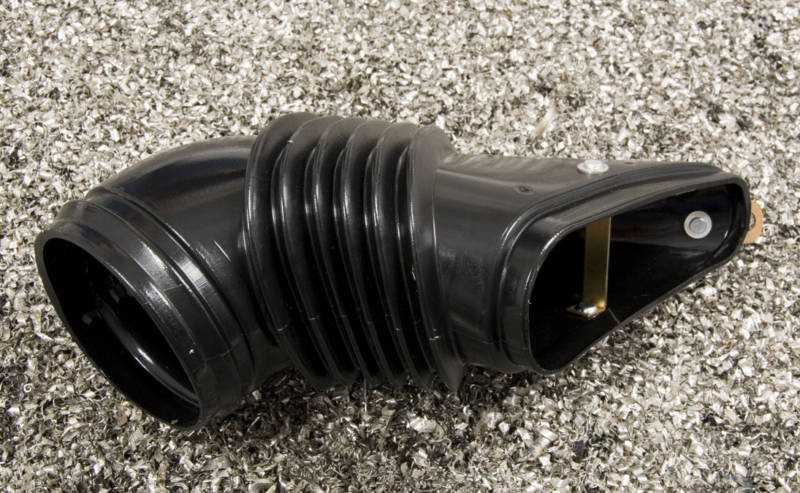

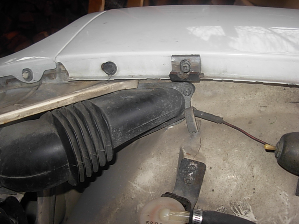

What's the difference Mike? Just wondering if my early 70 (which has a lot of the same parts as the 69's) has the rare version.
John
Instead of having a single tab that mounts to the inner fender, they have a metal ring that attaches with 2 screws. The intake has a lip that the goes under the metal ring.
-Mike

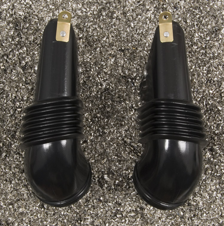

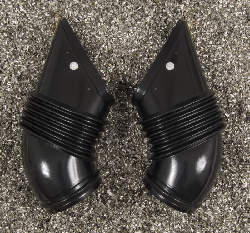

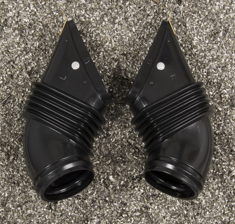

I was wondering about these being reproduced. Just a simple ABS plastic blow mold. The seller isn't too far from me. From his eBay feedback it looks like he bought a set in Mar 2010 and perhaps used these to make his mold. And to think, I paid almost that much for a set of good used ones.:cry:
Any idea of when the change over took place? My radiator support has the small hole for the sheet metal screw but I have the later style. Wondering if they were swapped out at some point.
John
From the pictures of various early cars I have, it looks like it may be around VIN# HLS30-00500. I could be wrong though. I know #882 and #1590 had the later style on them, but they could have been replacements.
