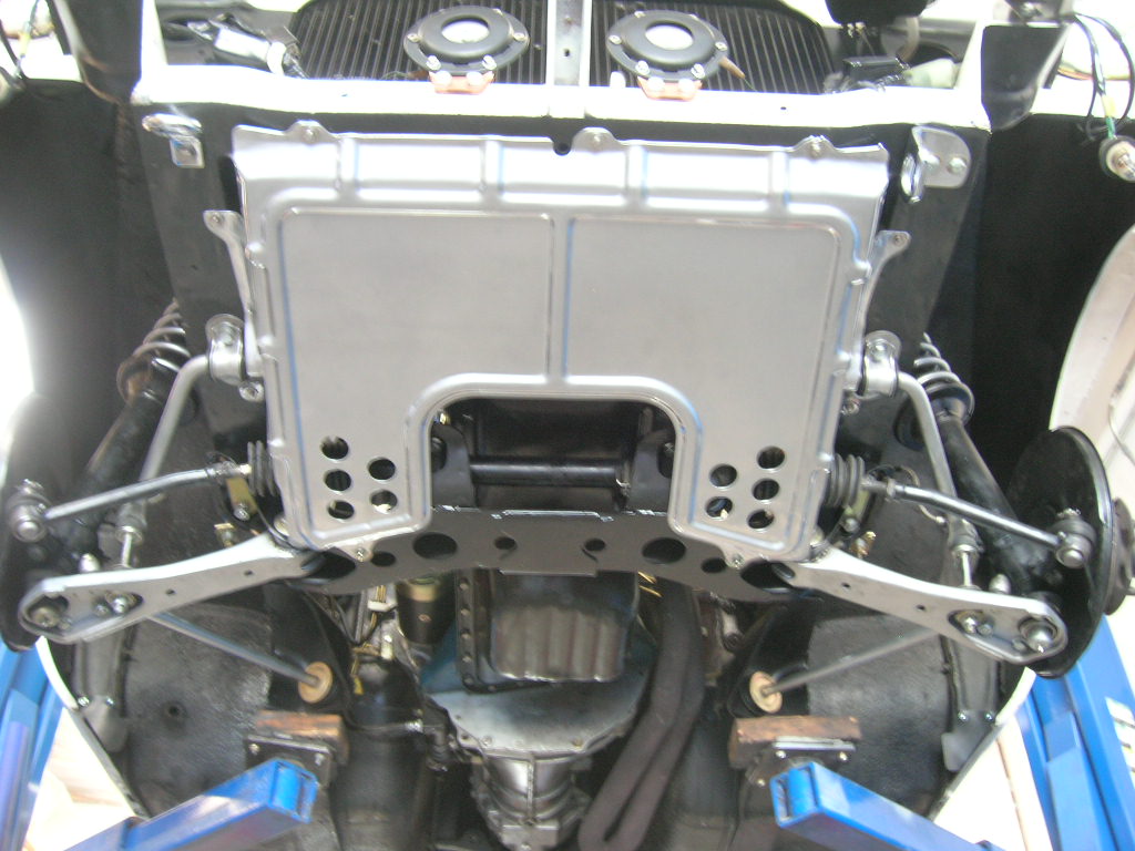

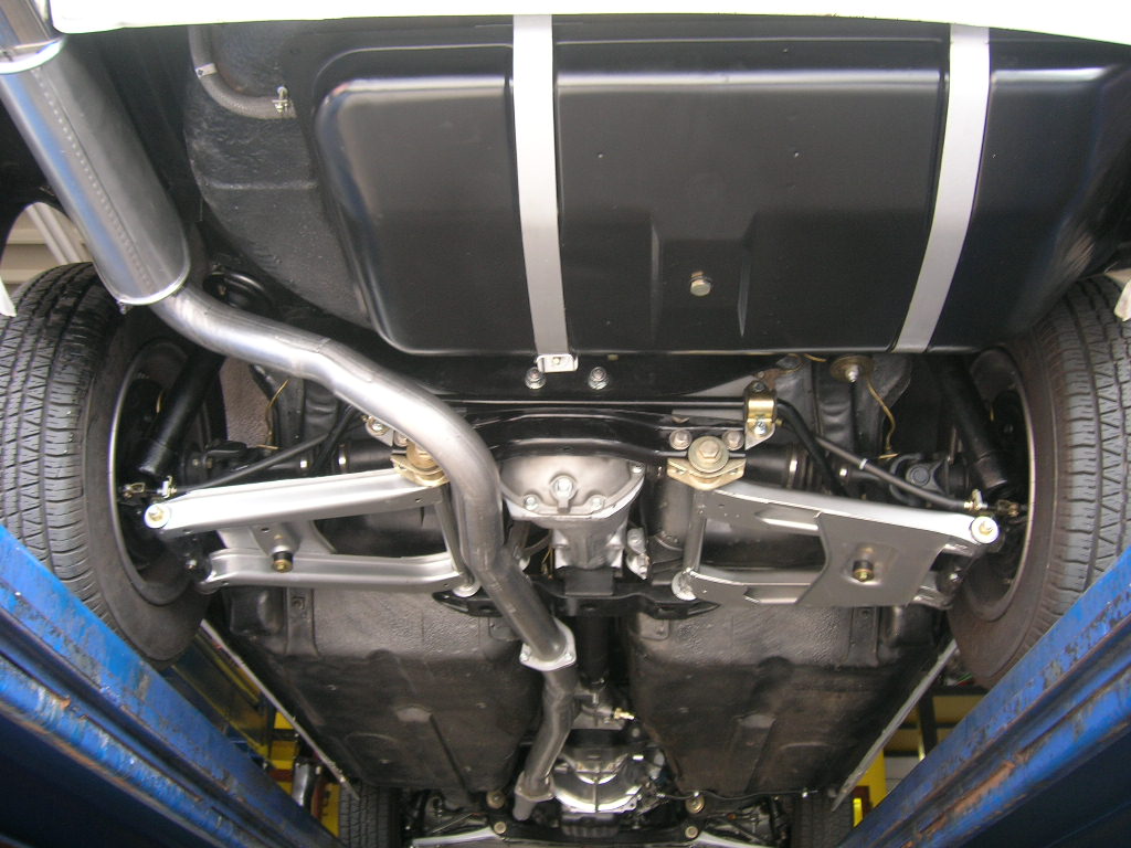

September 27, 201014 yr comment_331857 My 240 is nearly painted, and the body shop is begining to work on the car's suspension components.What do most of you prefer-- powdercoating or painting for the supension pieces? Are there pros/cons to each approach? I had originally opted for paint--but after looking at some of the shop's undercoating work, I may go that route instead. On a similar note: Has anyone tried powdercoating the grille and tail light panel? If so, how close is it to the original gray color? Thanks! One thing about powder coating is that it will dis-color against chemicals. So watch out for carb cleane, coolant, oil spill, degreaser, or brake cleaner. And it is a good idea to cover any threded areas and clearance critical areas when you do it. Otherwise you will have problem installing some of the parts. Otherwise, I have done: all the members, arms, and coil springs, and so on as shown here. Edited September 27, 201014 yr by esprist Link to comment https://www.classiczcars.com/forums/topic/37211-powdercoat-or-paint-it-black/#findComment-331857 Share on other sites More sharing options...
