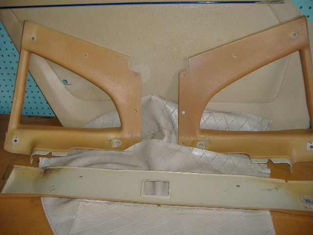

October 2, 201014 yr comment_332307 This is a good photo showing what age can do to a 73 'off white' interior. It was all removed in 1980 and put in storage until 2006. They were cleaned the best possible, then the photo. The door panel shows the armrest difference in only 7 years of being on. The plastic panels show what smoking can do, in 3 years time. The chrome strip was found on the floor, the blue plastic matches the car's color. The dome cover is up side down to show discolor drawn into openings, also seen around rivet holes. The vinyl is somewhat darker than I remember, could be the flame resistant chemicals used. The headliner material held the color the best. I used SEM vinyl dye on all plastic parts. I needed a new tail finisher in 'off white' so ordered one from MSA. Like said before, it is black plastic sprayed with the same SEM dye I used on the other parts, got lucky. This part is of thicker material from OEM, and needed trimed. I ordered the 'off white' rivets from Courtsey, and they were closer in color to the original vinyl, so they got SEM'ed to match. Not everything matches, but most is original. Bonzi Lon Link to comment https://www.classiczcars.com/forums/topic/37236-white-interior-in-72/#findComment-332307 Share on other sites More sharing options...
