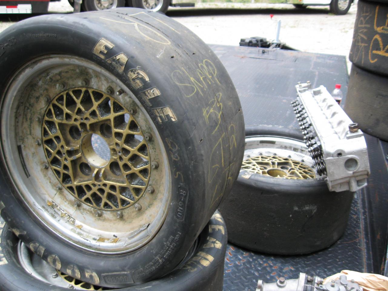

October 5, 201014 yr comment_332566 My Rebello (12:1) does 314@crank so (money) pistons, cam and head do make a difference. Right now we are planning a race motor to throw into our 240 using the E31 head shown below and the Mikunis (both from the BSR 240). We thought we could just bolt on the triples after refreshing them but it seems they've been ported out to 50mm and instead of the small venturi,a race tube was soldered in. Taking the tubes out to insert smaller venturis would be a major pain so now it's engine building time. So much for fixing my street Z this winter..... Link to comment https://www.classiczcars.com/forums/topic/37291-stroker-kit-vs-stock-crank-with-higher-compression/#findComment-332566 Share on other sites More sharing options...
