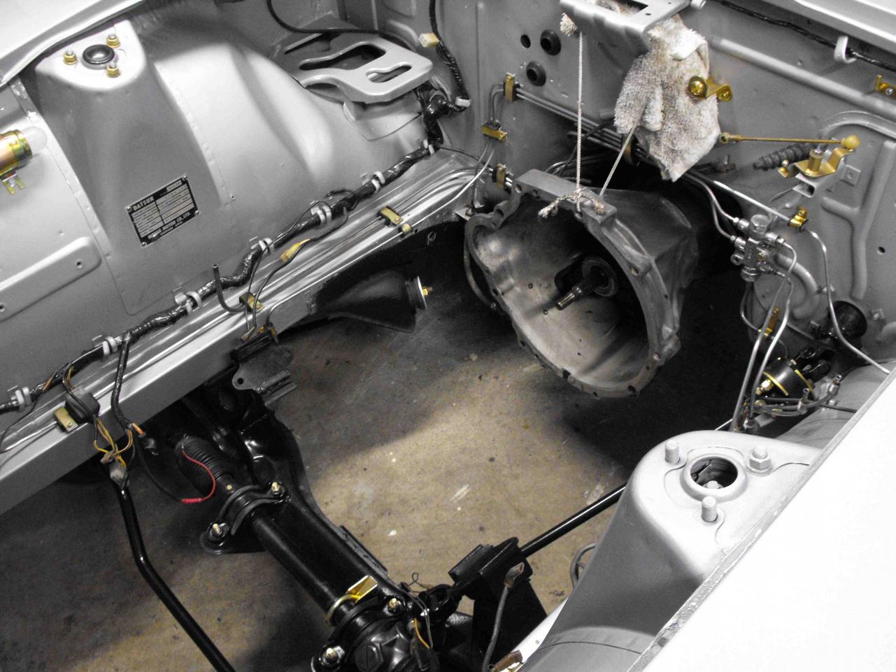

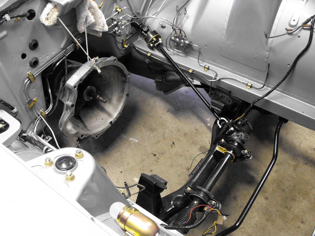

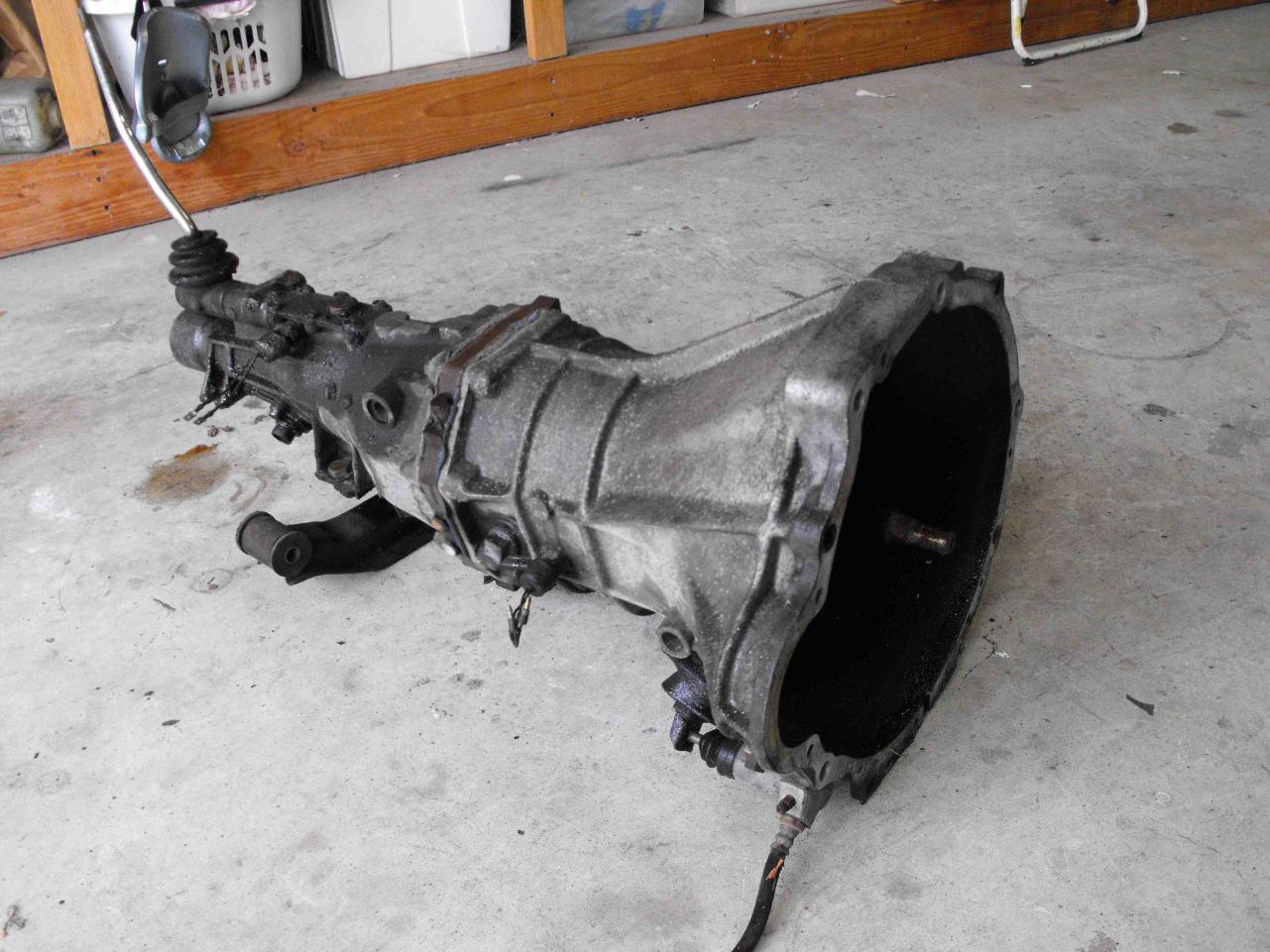

Was hoping to have the motor in by today, but no go. Hopefully will get it in on Thursday. I did get the trans in, so that is good. Have the front end held up with a rope so I can move the car around.

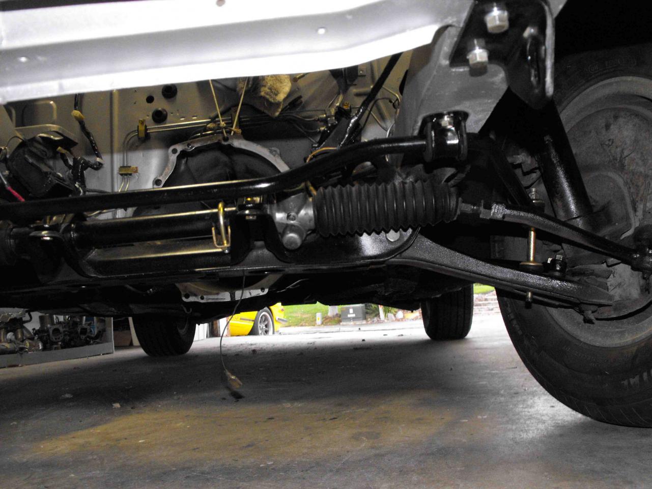

The trans took quite a bit of time to clean up. Was oily and pretty corroded. Got the anti-sway bar put in and the T/C rods. Put in new rubber T/C bushings.
I figured out the best way to get the T/C nut to go on. Make sure parking brake is set and all four wheels on the ground; grab top of the front tire nearest the T/C bushing you are going to install nut on, and rotate it aft as much as possible. This pushes the T/C rod through the 'buckle' further and allows you to get the nut started. That is, rotate the tire aft with one arm and install the nut with the other at the same time. Worked pretty well for me.
I need to paint the front disc covers. Looks like the caliper needs to come off to remove and paint that, what a pain.
Add another $75 dollars to the total cost for new cluth disc, T/C bushings and pilot bearing. Had a new throw-out bearing, so no cost there, just took me 20 minutes to find it :-|. Add $26 dollars for 4 cans of undercoating.

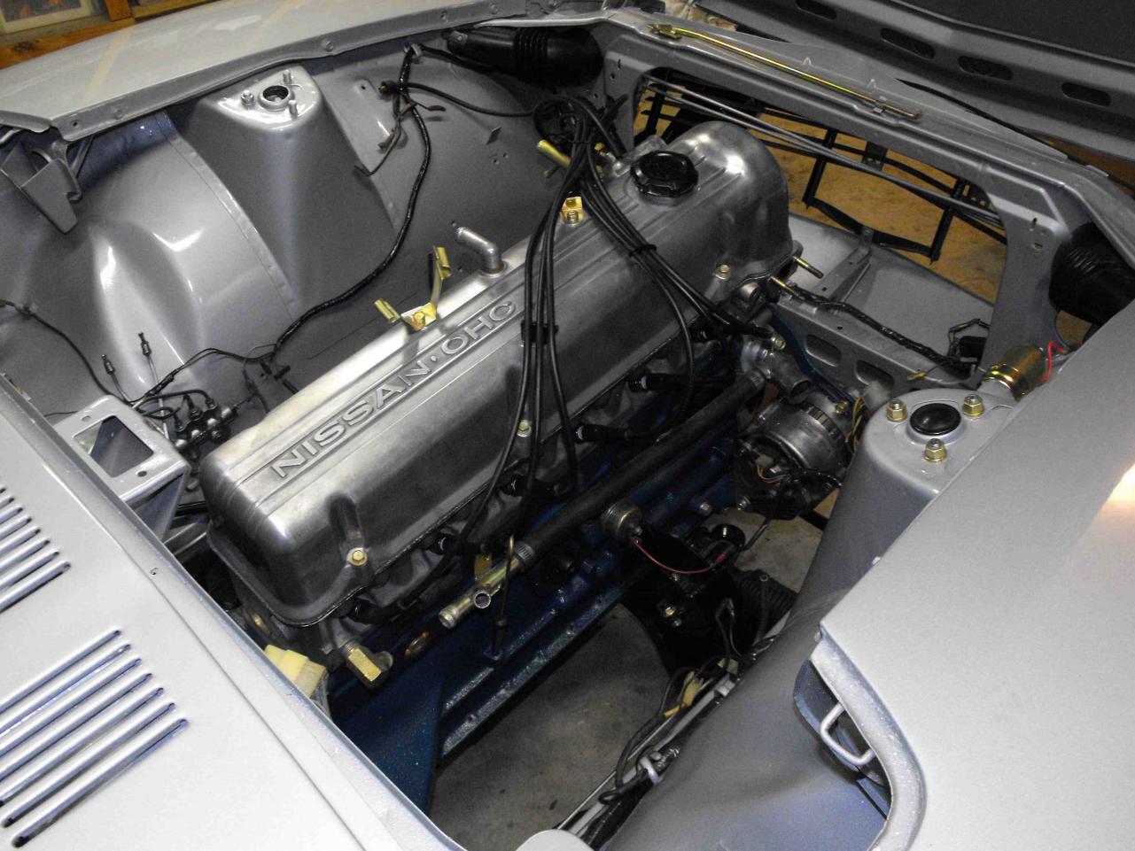

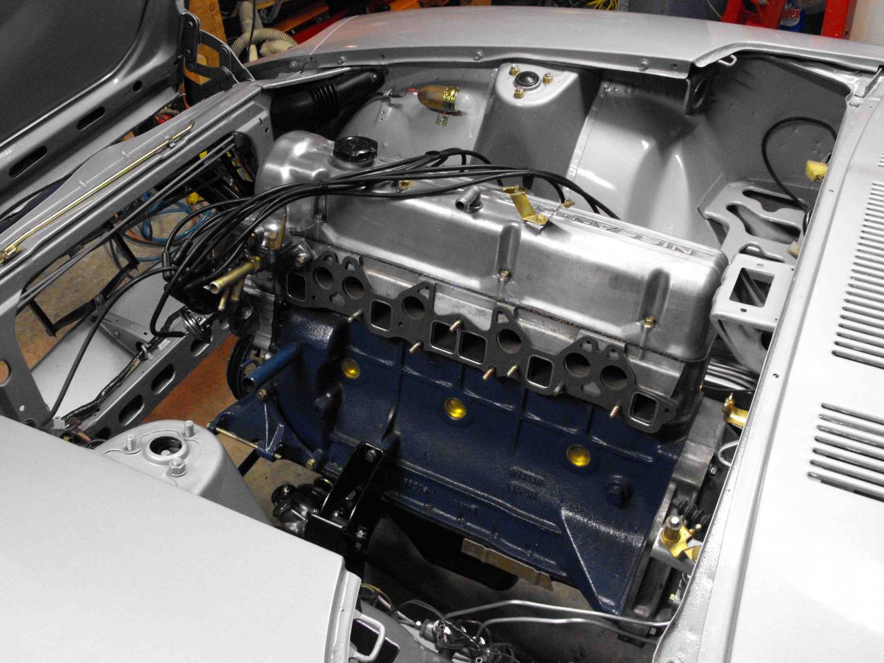

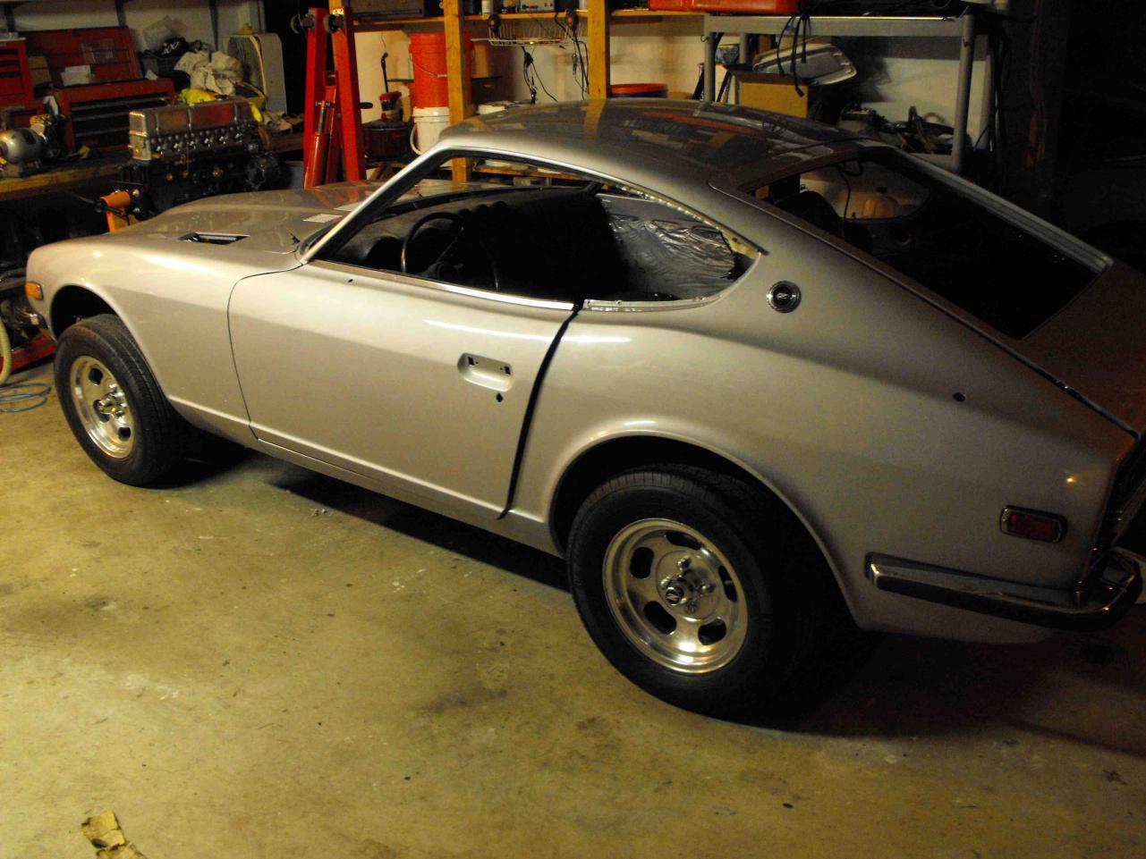

Got the motor put in. It went pretty quick with my son helping. Put the distributor on with wires and realized the harness combs were missing. Will have to get some of those.

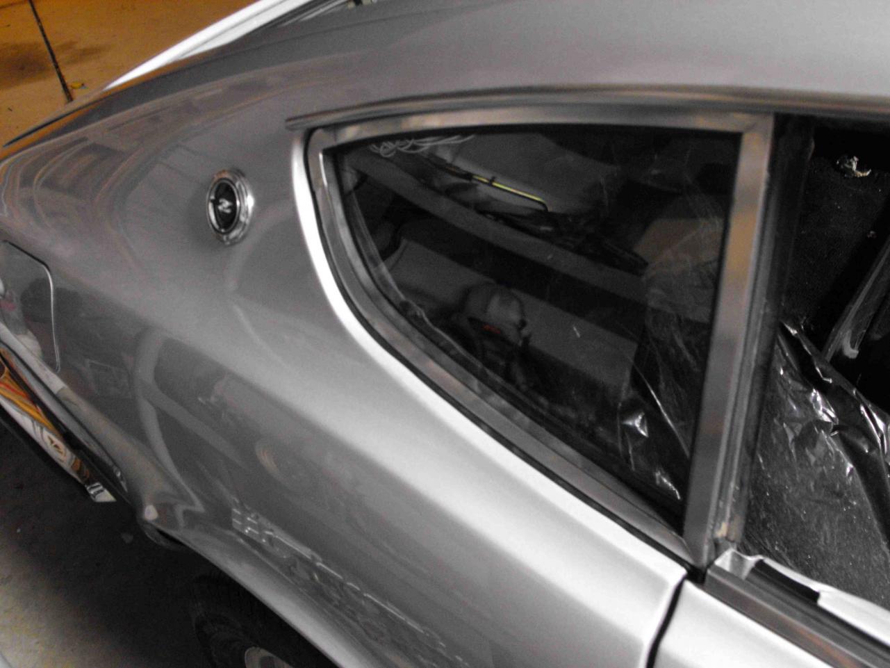

Got the rear side windows in last Tuesday. Much thanks to the person who suggested the masking tape to hold the weatherstrip in place while it dries. I think I actually had my first ever pleasant experience with weatherstripping :bunny:
