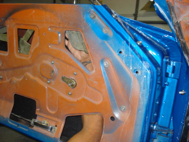

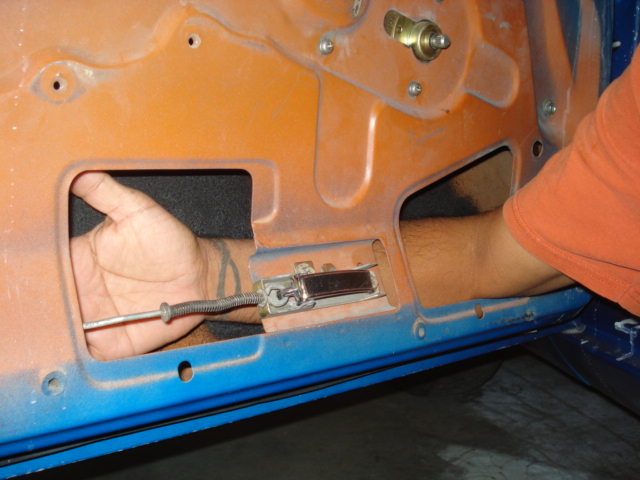

I've found it real easy to get to the mirror mounting nut by reaching up through the bottom opening. Start by raising the window all the way up. The trick is to put your hand and arm in parallel to the bottom of the door, then rotate your arm up to where the mirror mounts. A small ratchet or a rachet-type box wrench will fit up there to remove/install the nut. I took a couple of photos to illustrate...
Not sure if that will work in the '73. It looks like there are some channels on the inside of the door that I have not seen on my '71 (I saw them on the passenger side, guessing they are also on the drivers side. I think these were added to improve crash resistance.
