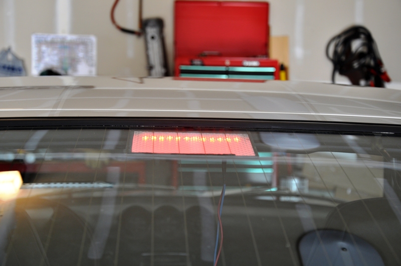

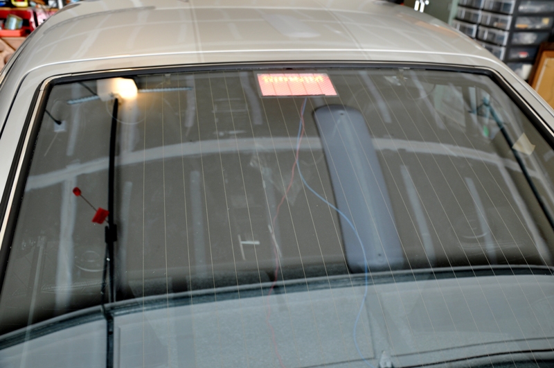

Attached are some pics of my 1st prototype 3rd brake light. I figure trucks and SUV's won't easily see my brake lights below their hood line.

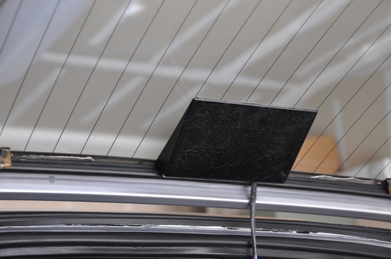

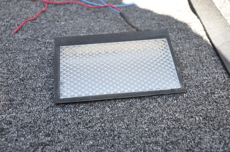

The housing is polycarbonate made on a 3D printer. I tried to mimic a vinyl surface finish by dabbing the wet paint with a paper towel.
It uses 12 red, high intensity LED's, (3300 mcd, 25 degree). To limit current and save the LED's I used a 150 ohm resistor for each block of six LED's.
In the pics I show the light temporarily mounted using double sided tape. It appears to be bright enough in daylight powered w/ a 12 VDC battery charger.

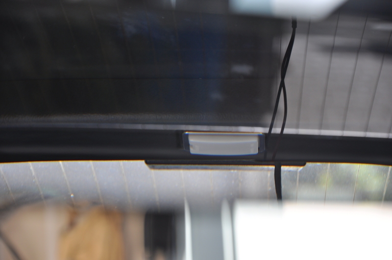

The housing shape is a bit crude / "blocky", so I've decided to design a new housing with angled sides. Also I plan to make it a about 1/4" shallower, so it's not visible to the driver in the rear view mirror. One of the pics shows the driver's view though the rear view mirror and you can see it's just visible.

I like the L.E.D. idea, especially for the fast on-time of the L.E.D.s but I'd add an enclosure of some kind, to keep the glare minimized. Probably a tube-like thing with rounded ends, like a squashed pipe. and the angled opening to match the window. Also, I would like to keep the whole thing no lower than the moulding for the cabin light, to keep the entire rear window clear.
With my setup, you really have to look hard to notice any light in the hatch. I would say it's about 99% invisible to you in the rear view, when the brakes are applied. When the brakes are off, 99% of the onlookers never ever notice it.
Can you see the enclosure (the box) in the mirror?
I think I will not use the tube-like enclosure because it might be too directional, and only a car directly behind would see it. I would have to make a mock-up and check that.
