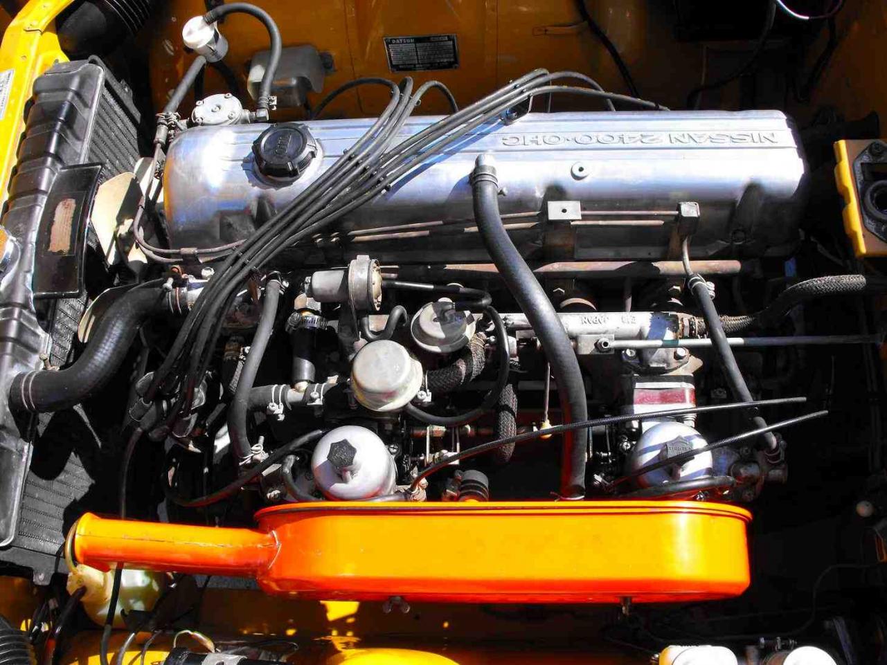

When I bought my car in 2006, it still had all of its original hoses on it. On mine, the smog hoses were (and still are) rubber dipped, cloth-wrapped hoses. The fuel hoses were normal-looking rubber. All other hoses (including the manifold pre-heater hoses) were braid-covered.
Here's a shot of the engine compartment as it was when I bought it.

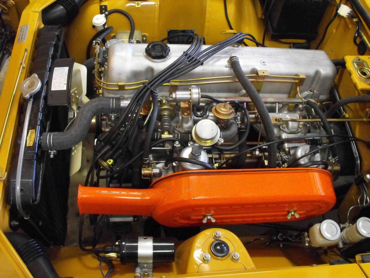

A friend of mine and his wife owned #157 since 1970..today another friend has the car. #157 came originally with Braided Fuel Lines. Still has its 69 dated spark plug wires as well.
I'm pretty sure I have photo's of others as well..maybe some are more clear..
FWIW,
Carl B.
Edited by Carl Beck

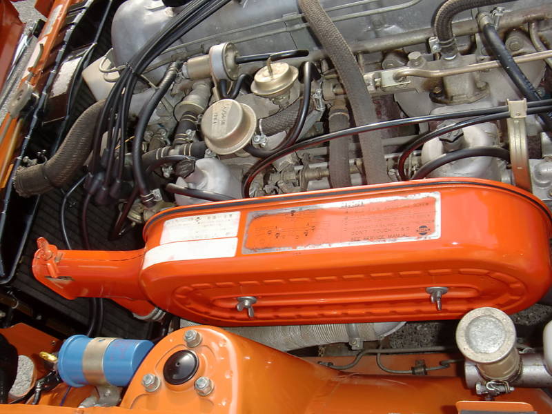

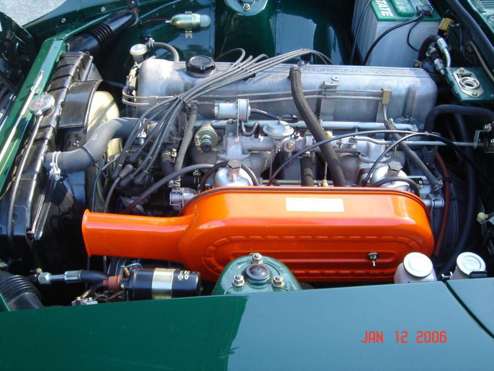

Sorry guys, but I don't buy it. Here is a picture of Mark Lambert's 4,400 mile 1972 that was at Zcon this year and a picture of the low mileage orange 1972 from Seattle that sold on ebay recently.
Carl, #157 may have the original 1969 dated spark plug wires, but I wouldn't say its engine bay is completely original. It looks like the some of the emissions hoses have been removed and plugged, it is missing the decal for the radiator guard, it looks like the upper radiator hose has been replaced with a later rubber one, the coil is not original, and what is the orange house behind the engine (looks like it covers the speedometer cable?). Maybe the owner of #157 replaced the fuel hoses with the ones that were being sold on ebay?
-Mike

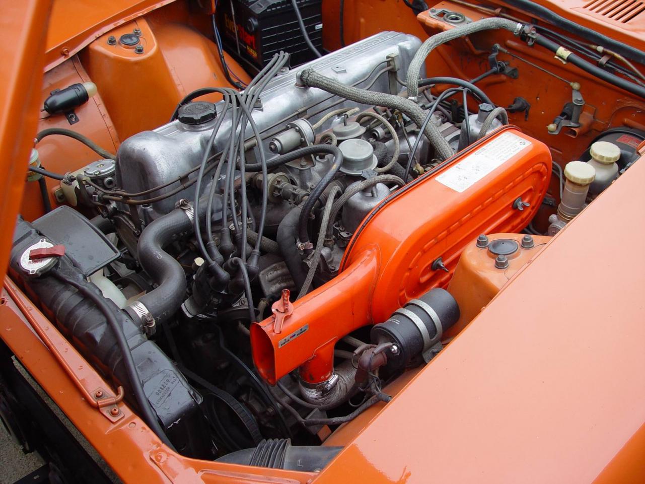

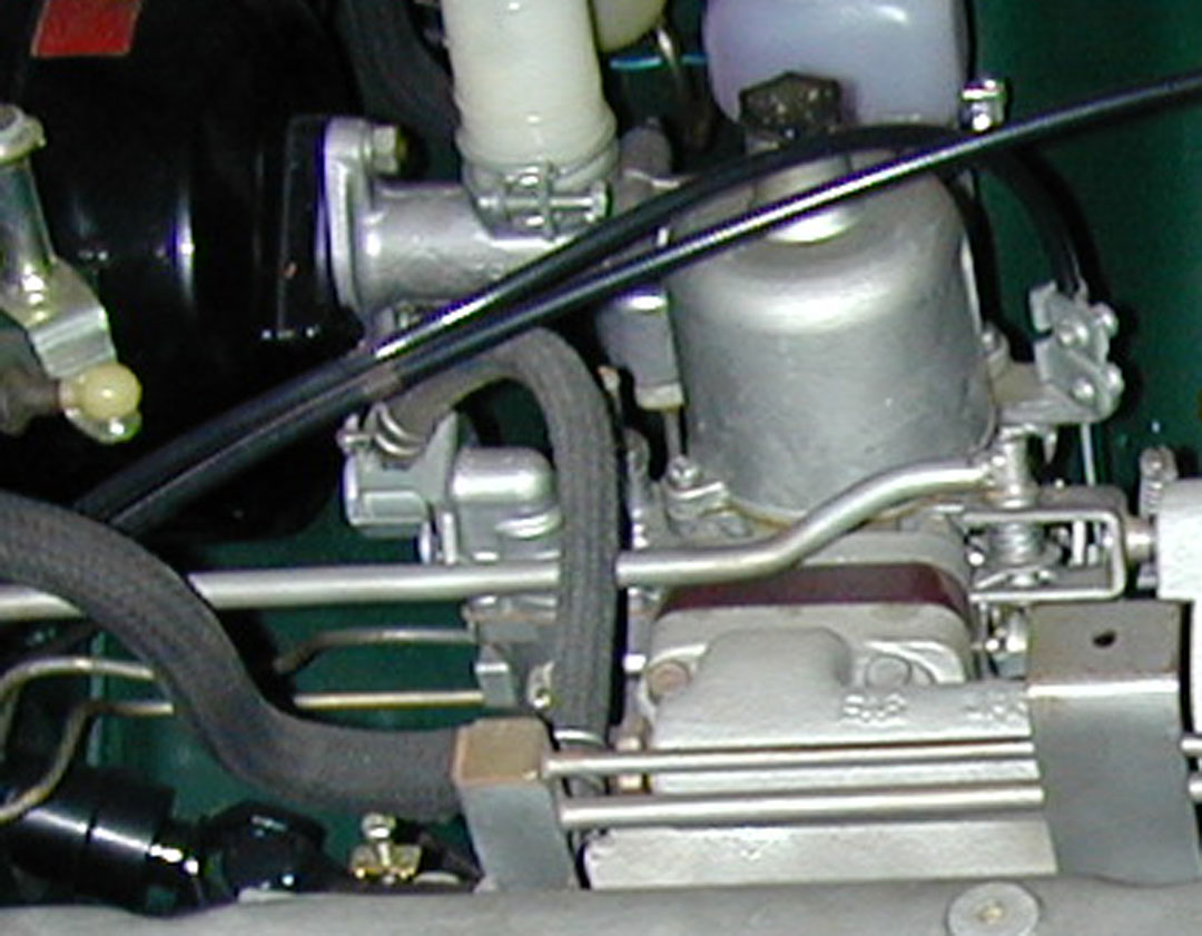

FWIW, here is a picture of my 03/72 240Z when I took delivery of her in early 2003... Most of the fuel lines were braided, but I always assumed they had been replaced at some point (the car being 31 years old at the time...). The non-braided lines going from the fuel rail to the bowls were clearly new replacements.

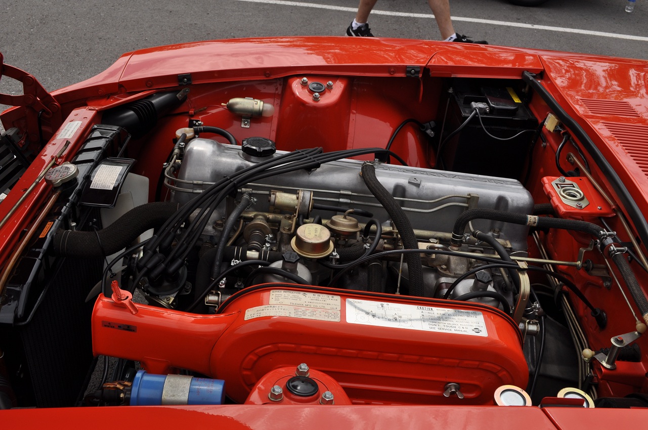

I think we can use a red car in this brochure as a good reference for its originality.
Also some Z books contains pictures from early days consumer reports and test drive reports,they looks same fuel hoses like the red car.
For me,the green car have a unique fuel hoses.
My 240Z has rubber hoses made by "YOKOHAMA GOMU(rubber)" now,
it has gloss rubber surface.
But seems to me, the red car has different type surface.It's surfece looks like a hose for air pump.
What do you think?
kats
