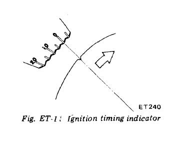

The L28 engine (at least on a '78) has a timing indicator plate with advance markings in 5-degree increments, so you don't need the timing tape like V-8 engines usually use. If you can locate the timing notch on the balancer pulley, and give it a little dab of white paint, you'll be fine. You might clean off the timing indicator a little (passenger side of the big bottom pulley.)

Powerglide is correct with what he says. I've done this on a 280Z as well as other vehicles. You're talking about static timing, not advance. Tell me how you're going to read the 24 degrees initial adavance with the stock indicator plate.
You're still talking about static timing @ idle; the comments by Powerglide and myself have to do with initial advance upon acceleration.
Edited by sblake01
"The timing with a warm idle on a 280Z should only be 10 degrees".
EVERY motor has different preferences. One may like 8 degrees static advance. Another seemingly identical motor may want 15 degrees to run well.
You may think you have 10 degrees static advance in the motor. But unless you have verified TDC with the number one piston at the top of its stroke---you really have NO IDEA what your ACTUAL initial timing setting is. The balancer and timing plate may show 10 degrees. But it could be 5 degrees or 15 degrees for that matter.
