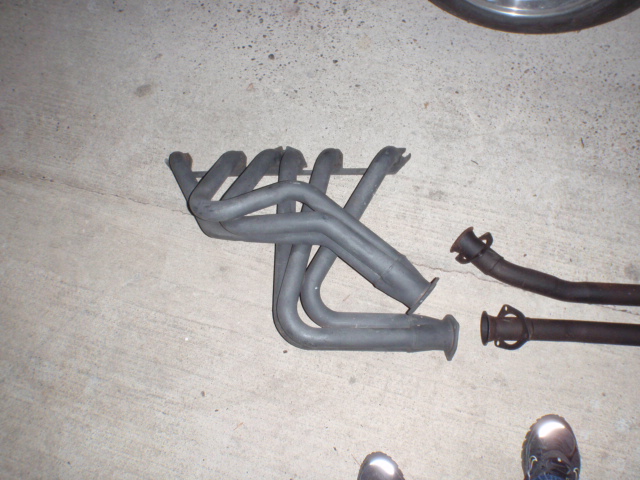

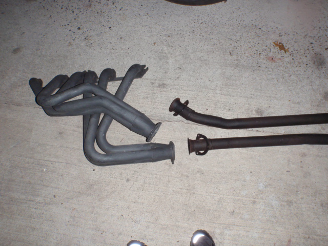

Posted October 21, 201014 yr comment_333999 my motor hasnt been in for more than 1000 miles and I have a exhaust leak. I think it might have been from running it with the glass packs and no hangers. now i have hangers on and Im going to pull the header off to redo the gasket but I don't want to do it again any time soon. it's a clifford header i think? the guy I got it from said to use a big block chevy gasket? anyone know what he might be talking about? any input would be great Link to comment https://www.classiczcars.com/forums/topic/37452-what-brand-of-header-gasket/ Share on other sites More sharing options...
