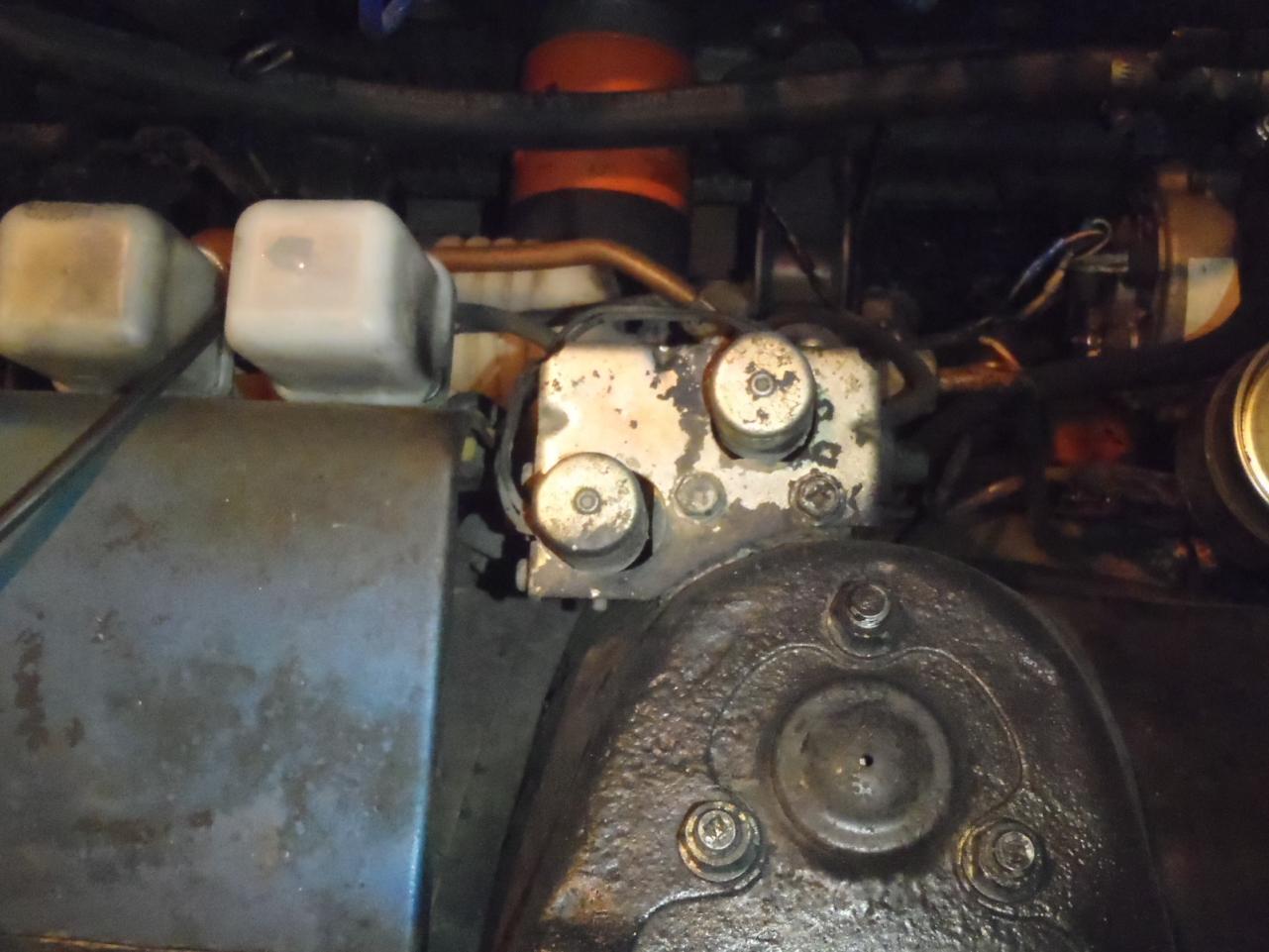

Those are magnet valves. They control vacuum for the fast idle control (air conditioning) and the opening/closing of the mode doors under the dash for heating/air conditioning. Like Steve said, look in the FSM for the diagram, page AC-12.
The info you're asking for is in the Air Conditioning section of the FSM. The page I noted in my other post is one of many in that section that shows how the magnet valves should be connected.
