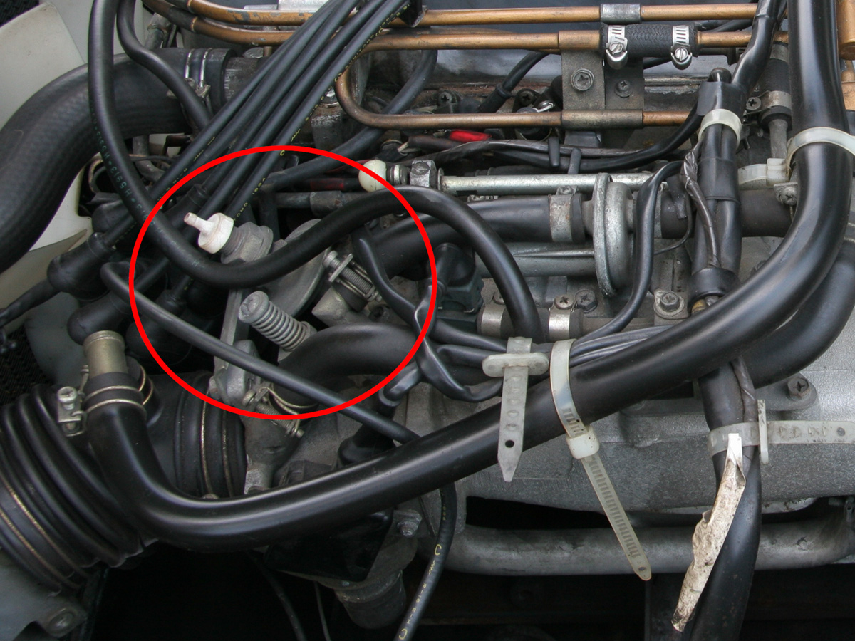

October 27, 201014 yr comment_334457 I know on my 76, there is a thing (not sure of the name) that helps the idle from falling when you are moving. I think it's called an anti stall device. It's the thing in the red circle. My RPM's stay around 2K until I stop. It also seems to keep the RPM's up for shifting. Link to comment https://www.classiczcars.com/forums/topic/37493-must-not-have-hooked-something-up-right/#findComment-334457 Share on other sites More sharing options...
October 27, 201014 yr comment_334458 I know on my 76, there is a thing (not sure of the name) that helps the idle from falling when you are moving. I think it's called an anti stall device. It's the thing in the red circle. My RPM's stay around 2K until I stop. It also seems to keep the RPM's up for shifting.That's the anti stall dashpot. Also if you have a California car, the altutude switch could also cause what you describe. Link to comment https://www.classiczcars.com/forums/topic/37493-must-not-have-hooked-something-up-right/#findComment-334458 Share on other sites More sharing options...
