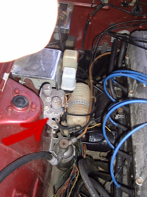

My 260Z had this problem a few weeks back. I tracked it down to leaking vacuum hoses. In my case, the ones under the solenoids, in the engine bay. Air conditioning worked, but the heater wouldn't get hot. It was fine after I replaced the cracked vacuum hose.

thinks forthe info but i have no idea whata case is an were it is located:stupid: do you think you could discribe were it is or send me a pic or something:classic:

In my situation, the leaks were underneath the solenoid, but you'll have to trace them down yourself. I had a regular vacuum gauge, but a hand pump with gauge attached is a lot better for trouble shooting. Cost me $40 at the auto store.
Picture attached.
