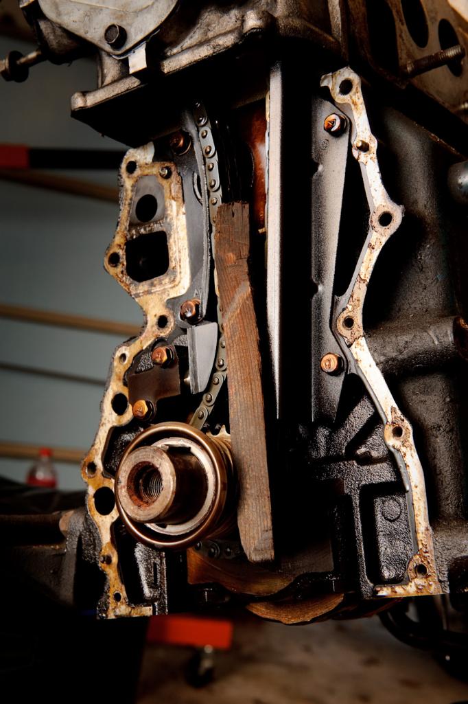

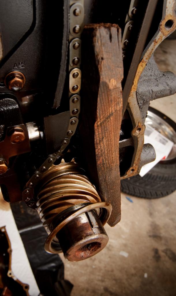

Posted October 29, 201014 yr comment_334583 When I opened up my timing chain cover I found a chewed up block of wood. I think it's pine.:paranoid: I'm guessing this is the remnants of a DIY timing chain wedge. Apparently a 240Z does not make a good chain saw. Link to comment https://www.classiczcars.com/forums/topic/37508-the-po-gave-me-wood/ Share on other sites More sharing options...

October 29, 201014 yr comment_334589 That's funny! Makes one wonder how many beers does it take to forget leaving something like that in the engine. Wonder how bad the guide got bent or if it snapped any mounting bolts.I've heard that the newer timing guides aren't as wide. My friend Norm mentioned that he had heard of trouble with new production guides. Maybe this is some example of a "genius" redneck enginneer creating a new anti chain flopping device. Link to comment https://www.classiczcars.com/forums/topic/37508-the-po-gave-me-wood/#findComment-334589 Share on other sites More sharing options...
October 29, 201014 yr Author comment_334591 Wonder how bad the guide got bent or if it snapped any mounting bolts.There doesn't seem to be any damage. The chain and guides look fine. There isn't much crap in the pan and the cylinder bores look great. I want to know what the po was up to. Head gasket? Link to comment https://www.classiczcars.com/forums/topic/37508-the-po-gave-me-wood/#findComment-334591 Share on other sites More sharing options...
October 29, 201014 yr comment_334593 Is the cam gear still in position #1? Maybe he was adjusting the cam gear positions to compensate for an old chain. But if he was that, nitpicky, he woodn't have left the wood in there. Link to comment https://www.classiczcars.com/forums/topic/37508-the-po-gave-me-wood/#findComment-334593 Share on other sites More sharing options...

October 29, 201014 yr comment_334610 I can tell you, it's really not that hard to leave the chock in there! :stupid: I've made my own, very short so I can take the cam bolt out and drop the sprocket, pull the chain over the teeth to find a new timing position, all done in seconds. When I want mine to come out after doing work, I just turn the engine slightly via the crank bolt and the wedge instantly pops out.... As for that block of wood, someone had no freaking idea what they were doing.....or needing to do the job properly. OMG. Edited October 29, 201014 yr by ozconnection Link to comment https://www.classiczcars.com/forums/topic/37508-the-po-gave-me-wood/#findComment-334610 Share on other sites More sharing options...
