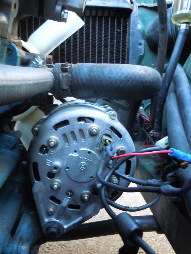

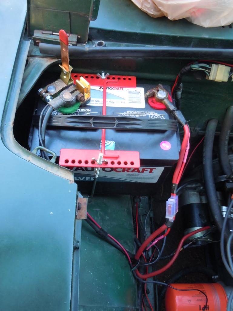

November 29, 201014 yr Author comment_337317 A few updates: - Did the 280zx alternator upgrade after experiencing some issues with the old alternator. What a slow and excruciating death the car experiences when the battery isn't getting charged sufficiently while driving. The turn signals stop responding, then I'd notice the fuel gauge starting to plummet slowly, and shortly after the headlights go out, the car sputters to a halt. Fixed this yesterday, and the amp meter seems to be in the positive. We hadn't done our research properly, and after bolting on the 280zx alternator, fired up the car. Turned on great, but without the diode, it wouldn't turn off. The battery's kill-switch was installed after the first time Jason pulled the main coil (with the shocking jolt that followed) from the distributor to turn the car off. Got the upgrade adapter and all now it works fine. - Jason took a choke assembly and created the throttle control linkage. The car is equiped with both the hook on the gas pedal, and the mount up in the firewall, and with some engineering, he got it working. Since we don't have the throttle control knob, we're just using a backwards choke knob for now. Works well for warming the car up, and it will hold the car at speed on flat stretches of highway. Link to comment https://www.classiczcars.com/forums/topic/37564-hls30-01222-project/?&page=2#findComment-337317 Share on other sites More sharing options...

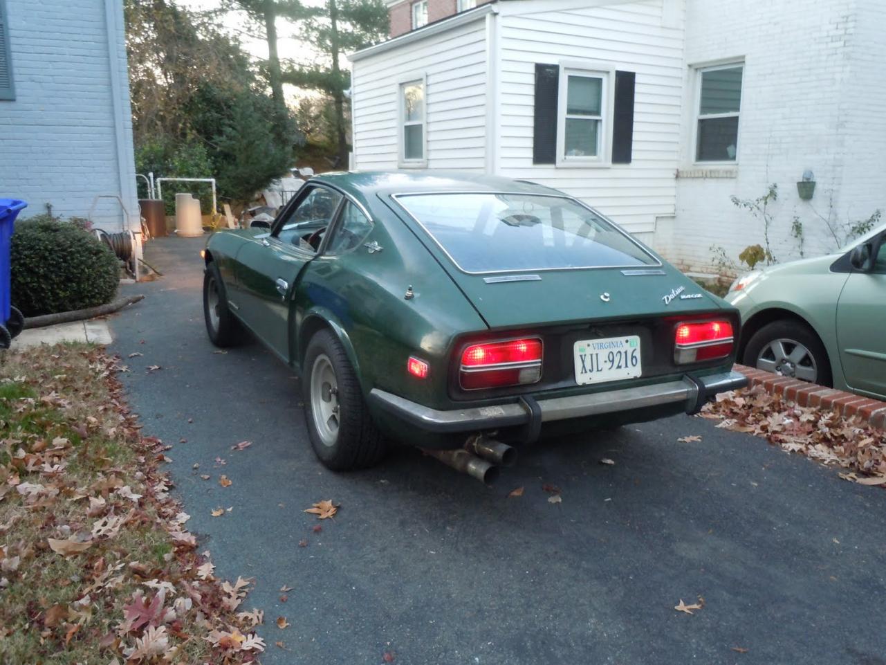

December 4, 201014 yr comment_337846 Nice opportunity to resurrect a great car! Looks like the rear glass was replaced from a later model, as it has the vertical defrost lines in it. Mine (#1399) has the original clear glass, but not in the best shape. Still holding on to it for sentimental reasons!Hi, Duffman, Rick here.Not trying to be argumentative, but informative: I wonder if YOUR rearglass and/or hatch might have been replaced at some point in time?The reason I say this, is that I have had a sort of sub-hobby for about 40years, that addresses the subject. It looks like the cars with a 1969 builddate had clear glass (say up to about Carl Beck's #587 car); and beginningwith 1/70 build dates, in came the vertical defroster. In my records I have#965, owned by Joe and Dottie Novak, as the earliest I have seen WITH thedefroster; although I seem to remember that car #725, owned by FrankPagano, also had one. But the point is, that the transition seems to havecome in at about that time frame.Interestingly enough, the rear window defroster must have always been inthe plans, because even the earliest 1969 cars had a location provided in the console for where the defroster switch would eventually be located.FWIW,..............All Z Best,....................Kathy & Rick Link to comment https://www.classiczcars.com/forums/topic/37564-hls30-01222-project/?&page=2#findComment-337846 Share on other sites More sharing options...
December 4, 201014 yr comment_337857 Hi Rick,Here is a thread about the rear hatch glass that discusses the clear (untinted) glass and when the defroster was included on various models of the S30 http://www.classiczcars.com/forums/showthread.php?t=15886. Keep in mind that tinted glass and defrosters were available from the beginning of S30 production for Japanese market cars, they just weren't initially included on North American market cars. That decision was quickly changed after the first couple months of production.According to NMC USA's Technical Service Bulletin TD72-29 (see post #31 in the thread I linked to above), there was no provision for a rear defroster in the wiring harness for HLS30 cars until HLS30-01456. I don't know that is 100% accurate though. I parted out HLS30-00882 a few years ago and it had the defroster and what I think was the original wiring for it. This TSB describes the procedures required to add the defroster to cars that didn't originally get it from the factory.-Mike Link to comment https://www.classiczcars.com/forums/topic/37564-hls30-01222-project/?&page=2#findComment-337857 Share on other sites More sharing options...

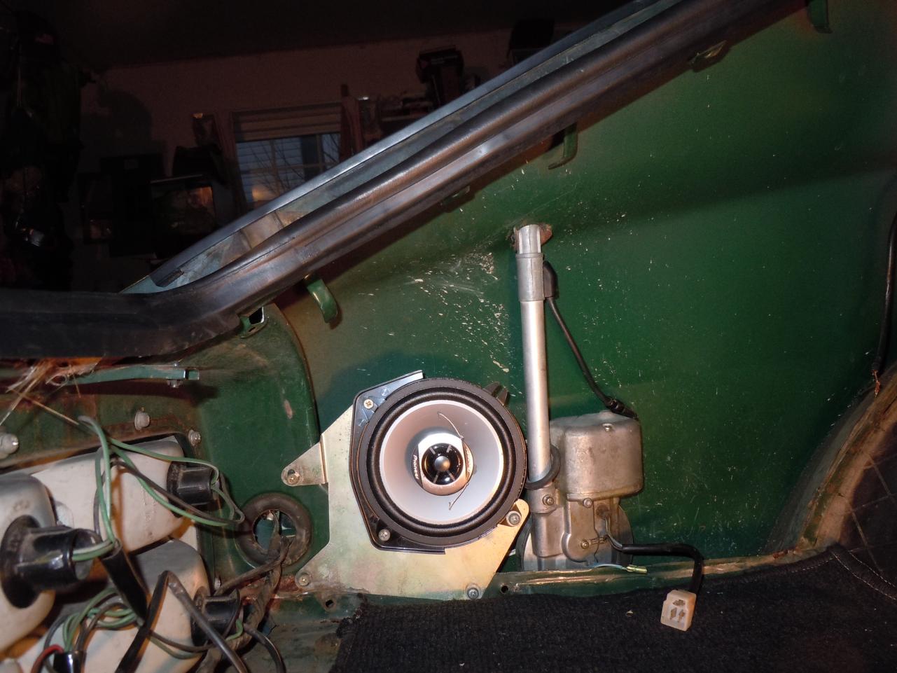

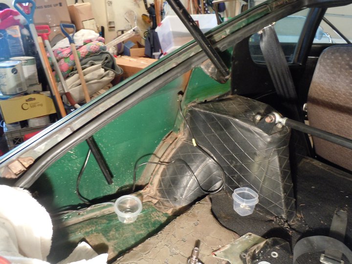

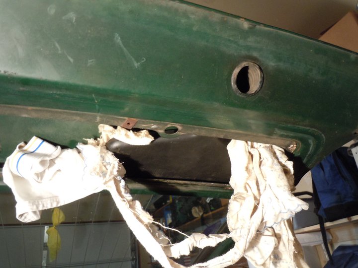

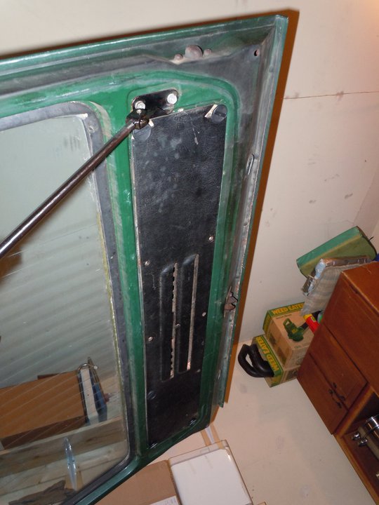

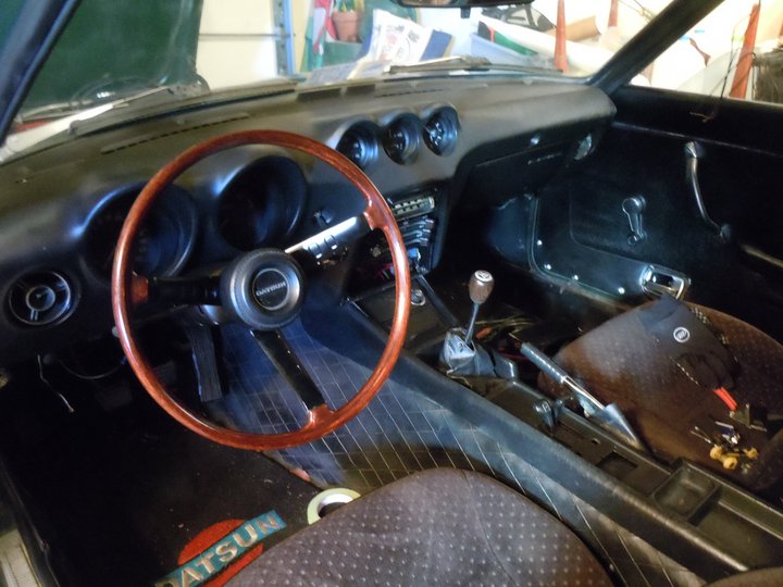

December 30, 201014 yr Author comment_340224 Dug into the car yesterday, with three projects in mind:1) Assemble the rear hatch's fresh-air/ drainage vents.Finally obtained all the parts to complete the rear-hatch’s fresh-air vents / drainage system. Took an hour or two to clean and install, but otherwise went well. 2) Install the radioObtained a radio from a ’72 or ’73, thinking that although it isn’t the Series 1 radio, the din space in the dash should still accept it. Well, it didn’t, and since then I’ve done some reading that says you actually need to pull that faceplate (holding the HVAC controls, map light, etc.) to get the radio in. Further than that though, a good 45 minutes of searching didn’t yield the 3-prong female end of the radio’s connection to the speaker. There is some new wiring in there, and a black case holding a newer fuse. Not sure what the PO did, but shortly after finding that, I decided to move on. Lastly, I pulled the old Hitachi 5.125” speaker out and couldn’t find anyone in the area who sells a 5.25” speaker with that low of wattage. I’m interested in maintaining the stock system. My accord has a stereo after all, if I want to drive and listen to music I’ll take that. I’ve done reading on some older forums citing a low-watt Kenwood 5.25”, but it doesn’t appear to be for sale in that same configuration anymore. SO, any recommendations on a satisfactory replacement for that rear speaker? 3) Install the glove boxIt would appear that a PO magically re-routed the wiring harness exactly where the glove box should go. I don’t have the panel that covers the Heater blower, and I suspect the harness originall was covered by that (?). If so, I suspect the PO moved the harness (again, not sure how) so it wouldn’t be visible. If my assumptions are wrong – how in the sam-hell does the glove box fit behind that door? I’ll post some photos later showing my predicament. Lastly, I’ve begun the search to replace these tired wheels. The tires are 215/60/R14, and are less than 2 years old. Since I’m on a budget, I suspect a 14x6.0 wheel is my best bet to re-capitalize the tires. Open to suggestions. Link to comment https://www.classiczcars.com/forums/topic/37564-hls30-01222-project/?&page=2#findComment-340224 Share on other sites More sharing options...

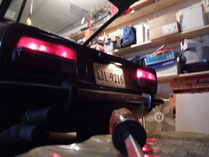

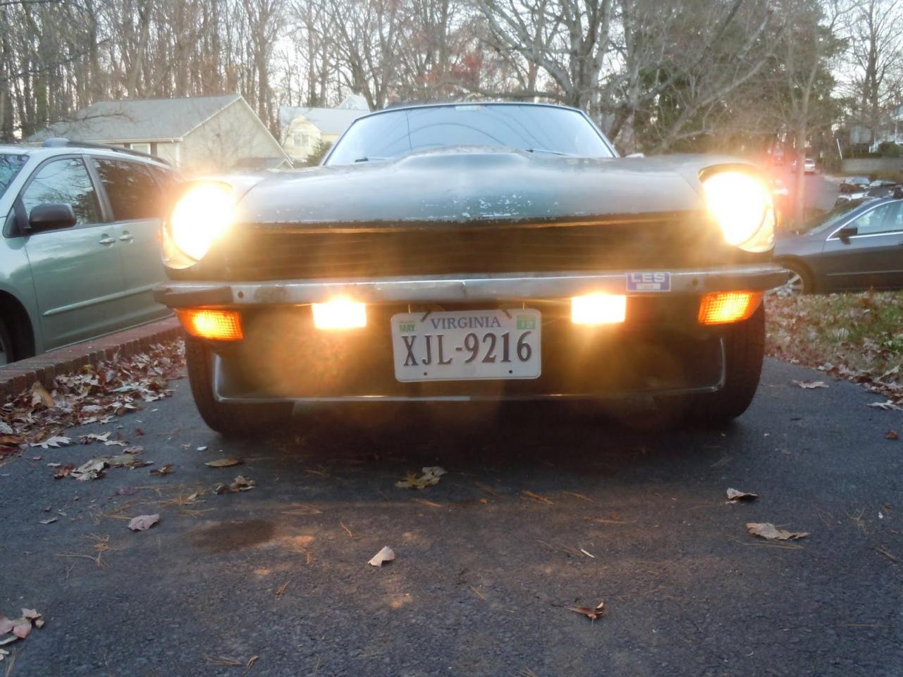

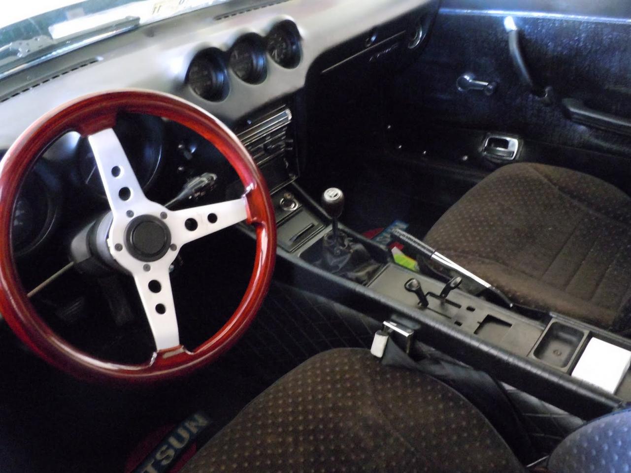

January 10, 201114 yr Author comment_341491 Quick Update: - Followed the instructions on this site to restore the car's steering wheel. Went well, and with some help from Fred (horn contact pin was missing from the turn signal stalk), the 'new' wheel is installed and the horn works. It's my understanding that power for the brake lights (the stop lights), works like this: - Power goes into the turn signal stalk - from the turn signal stalk, it goes to the stop light switch - from the stop light switch, it goes through the hazard switch - from the hazard switch, it goes to the bulbs. I replaced the Turn Signal Stalk and the Stop Light switch yesterday. Stop lights (foot on the brake) still don't work. More investigating is needed, because they worked when I bought the car. Edited January 11, 201114 yr by ksbeta Added Photos Link to comment https://www.classiczcars.com/forums/topic/37564-hls30-01222-project/?&page=2#findComment-341491 Share on other sites More sharing options...

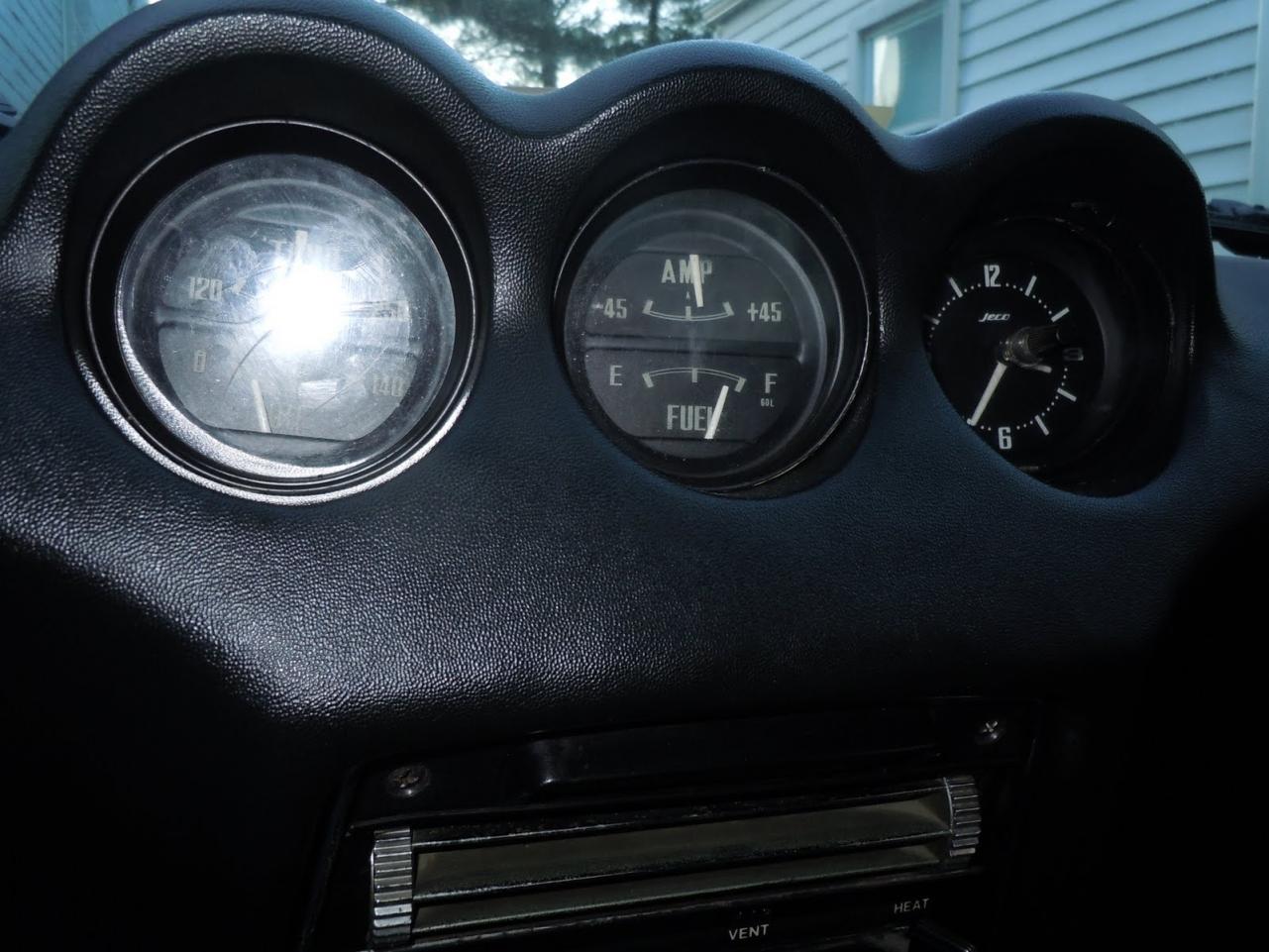

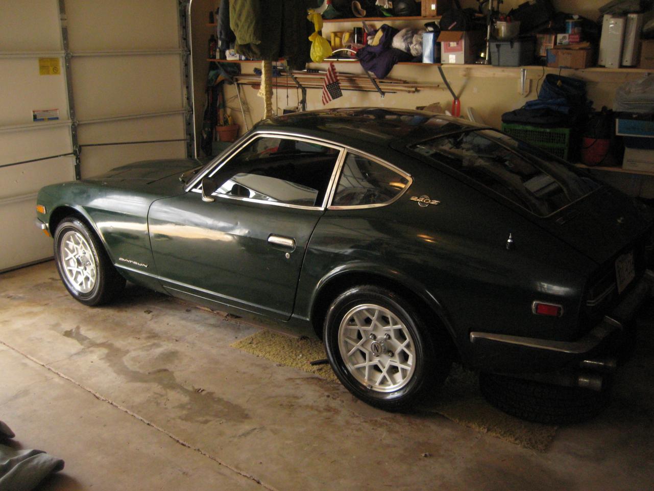

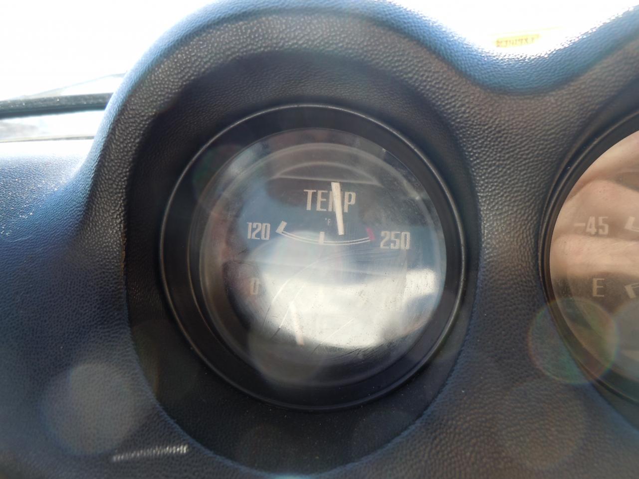

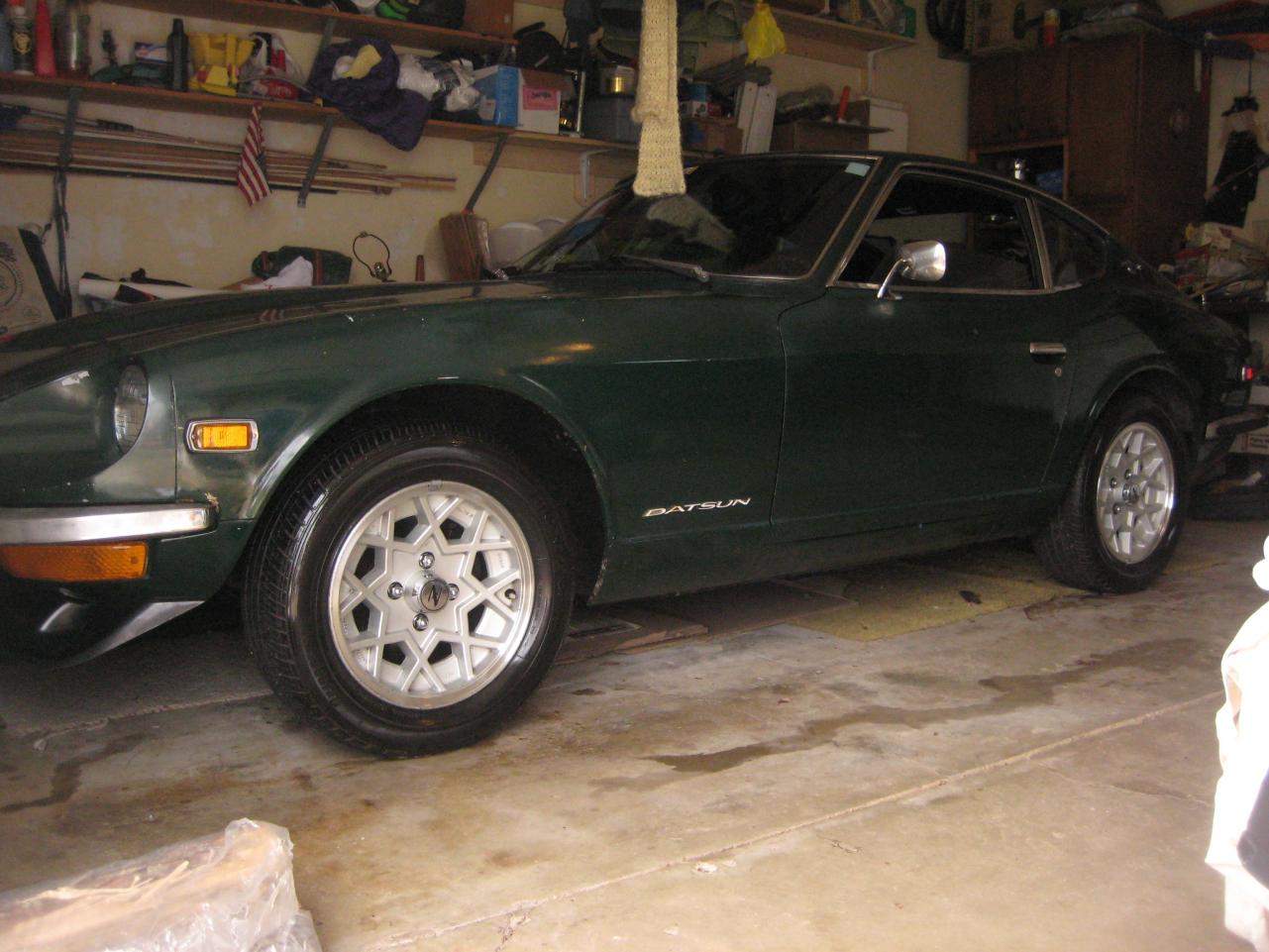

April 9, 201113 yr Author comment_352210 Found a decent set of snowflakes from an '81 ZX Turbo. 15x7 with 205/60/15 Potenza's. Makes a big difference compared to the 195/60/14's I had on previously. Replaced the speaker and installed the power antenna from a 280z. Side note: I snapped this photo of the temp gauge on a relatively cool (~60) day in which the car had been running around town (50% highway, 50% neighborhoods). Does that strike anyone as being too hot? Thanks, Link to comment https://www.classiczcars.com/forums/topic/37564-hls30-01222-project/?&page=2#findComment-352210 Share on other sites More sharing options...
April 9, 201113 yr comment_352212 My gauge runs just a touch lower than that year-round. The gauges in these cars are not especially accurate, nor are they consistent from car to car. If the car doesn't seem to be over-hot and the gauge shows that same temp under normal conditions, I wouldn't get too worried about it. Link to comment https://www.classiczcars.com/forums/topic/37564-hls30-01222-project/?&page=2#findComment-352212 Share on other sites More sharing options...

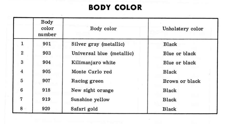

April 9, 201113 yr comment_352245 Bill,I can't believe I haven't seen this thread before. Nice car, but I am partial to BRG! Interesting that yours has a black interior. Mine does too. The original owner swears it came that way from the factory and I've been told that it wouldn't have been unusual if Datsun ran out of a part from the tan interior, to keep the cars going out the door they would substitute black. Keep up the great work, it's worth it. I rarely see BRG cars at shows. The color always draws a lot of attention, including people that will swear that Datsun never made a Z in the color! Link to comment https://www.classiczcars.com/forums/topic/37564-hls30-01222-project/?&page=2#findComment-352245 Share on other sites More sharing options...
April 9, 201113 yr comment_352248 Nice car, but I am partial to BRG! Interesting that yours has a black interior. Mine does too. The original owner swears it came that way from the factory and I've been told that it wouldn't have been unusual if Datsun ran out of a part from the tan interior, to keep the cars going out the door they would substitute black. North American 240Zs were made in 907 Racing Green with either black or brown (tan) interiors from the beginning. There was no running out of tan parts and substituting black. Here is a copy of the paint and interior options from the 1970 Nissan Service Bulletin introducing the 240Z. -Mike Link to comment https://www.classiczcars.com/forums/topic/37564-hls30-01222-project/?&page=2#findComment-352248 Share on other sites More sharing options...
