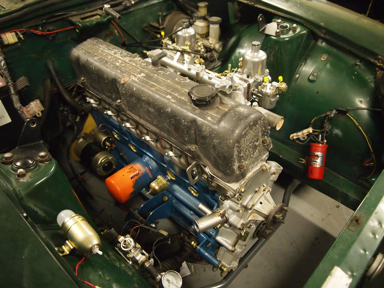

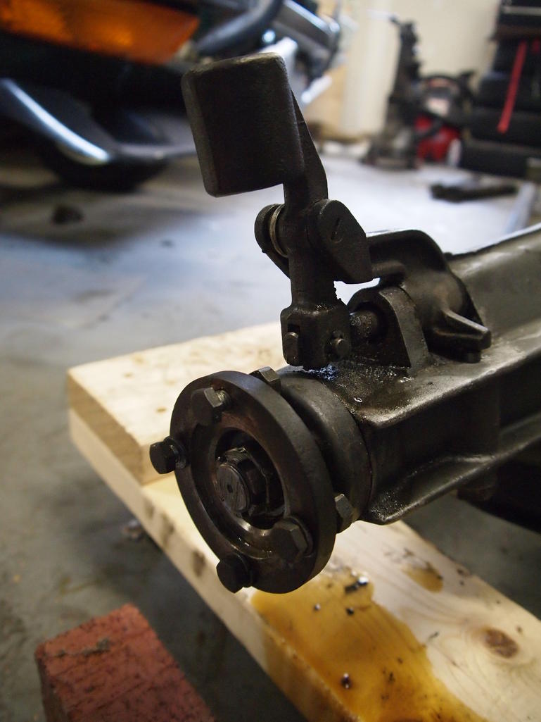

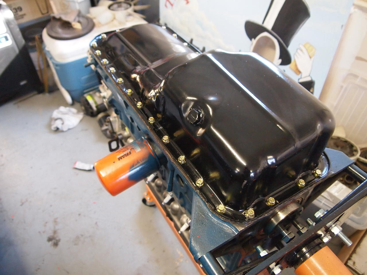

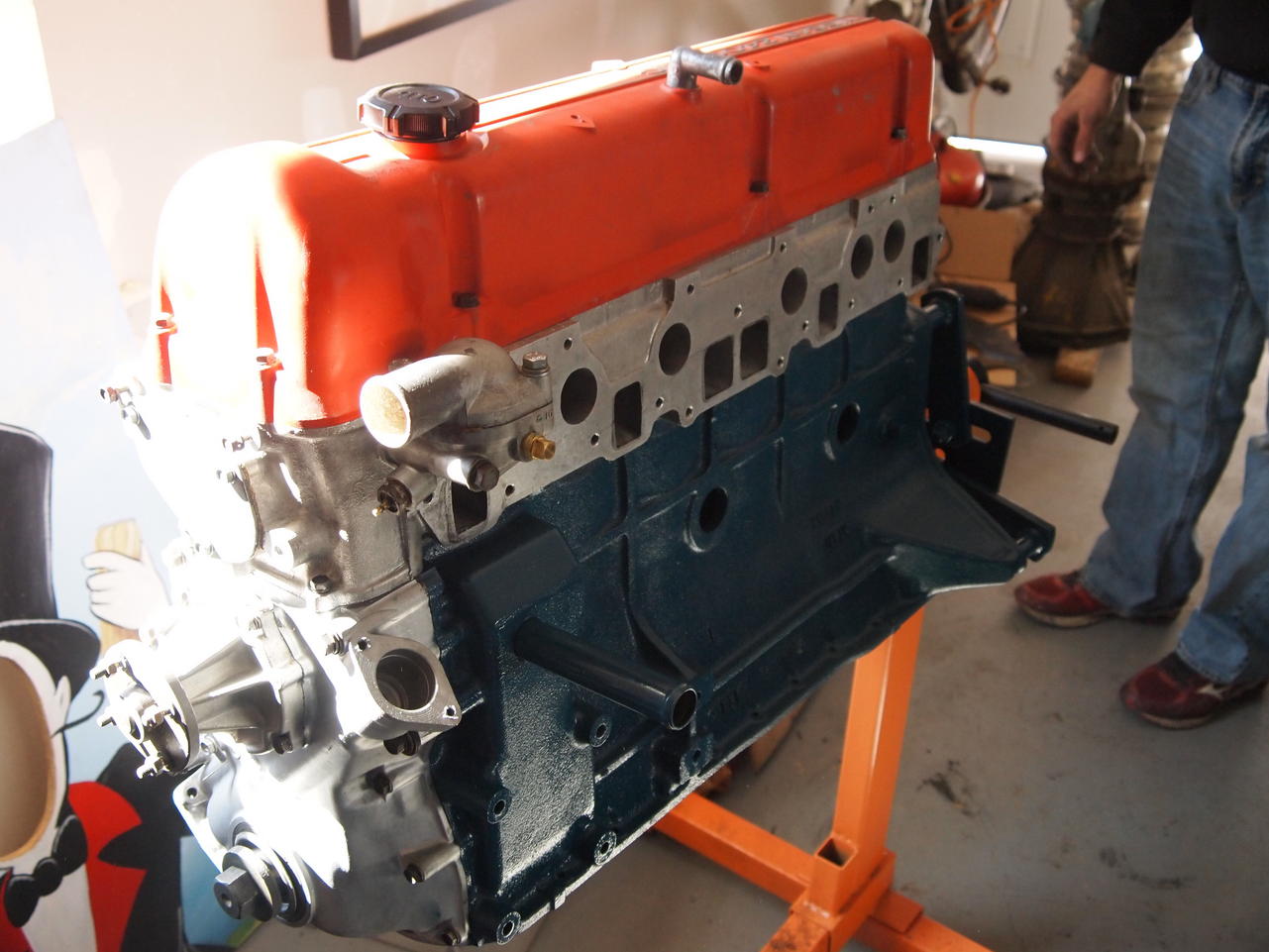

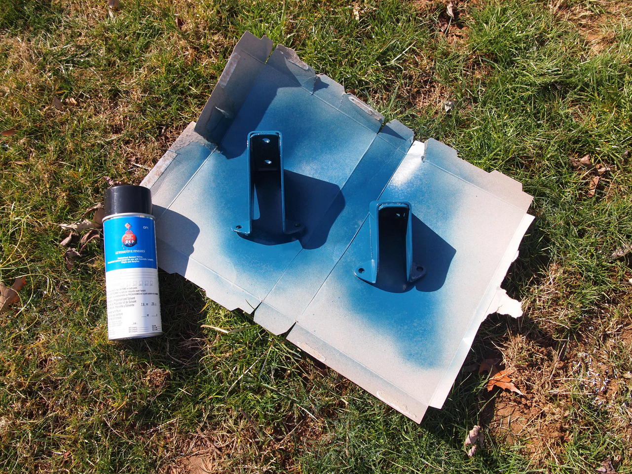

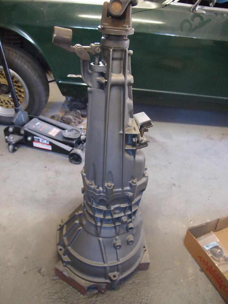

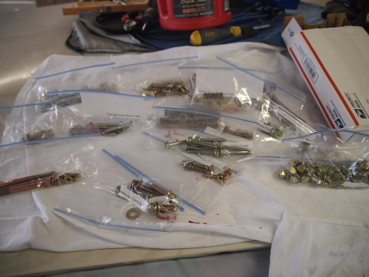

March 5, 201312 yr Author comment_416892 Used the Engine Bolt Kit from Datsun Spirit. Nice fresh bolts made for an easier job. Got the block painted up, using paint from Les. Cooler placement was a photogenic accident. Shifter on the Roadster Box. Two springs saddle the shifter as a return, those needed to be rebuilt. Cleaned up the transmission. Link to comment https://www.classiczcars.com/forums/topic/37564-hls30-01222-project/?&page=6#findComment-416892 Share on other sites More sharing options...

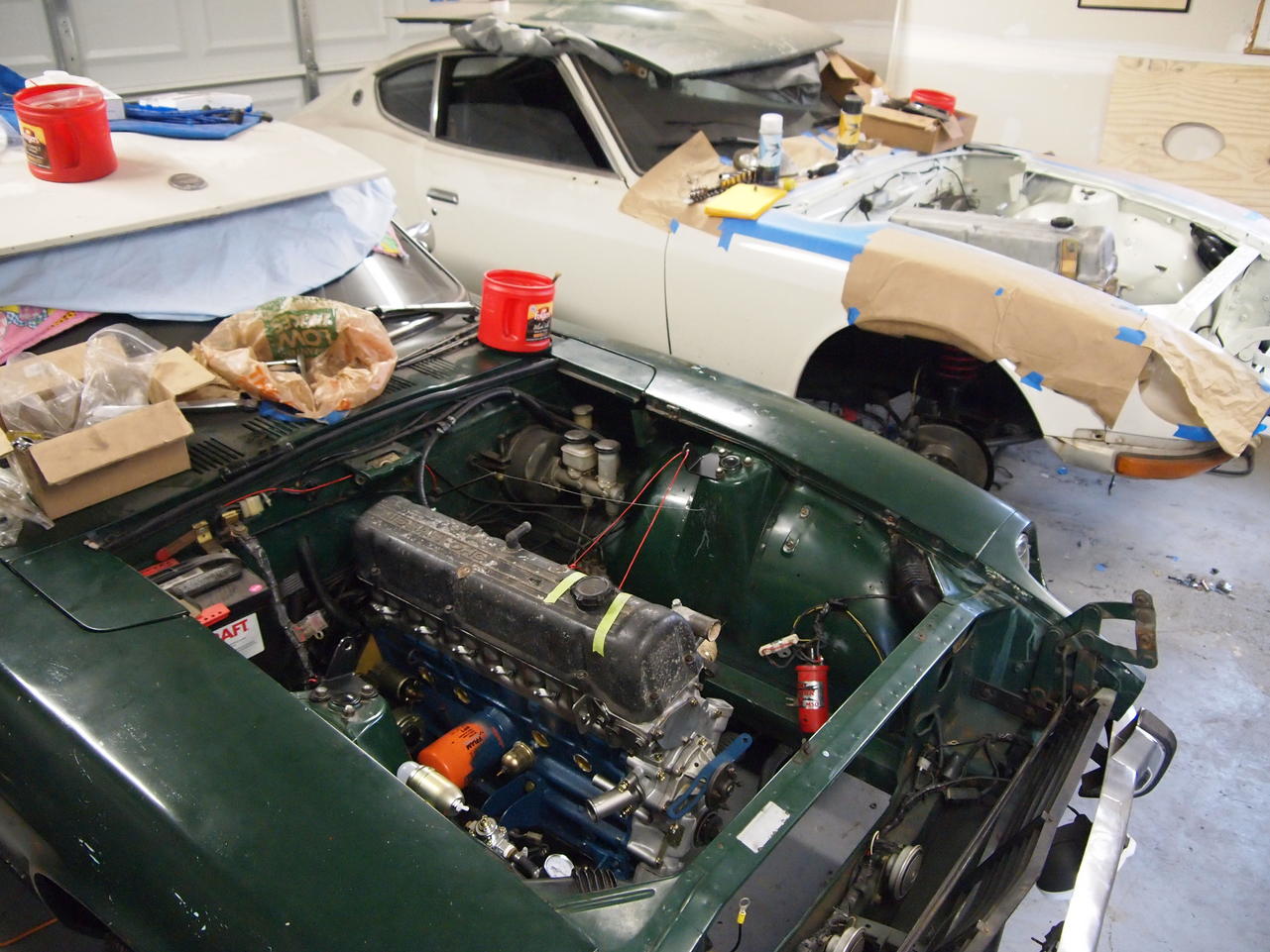

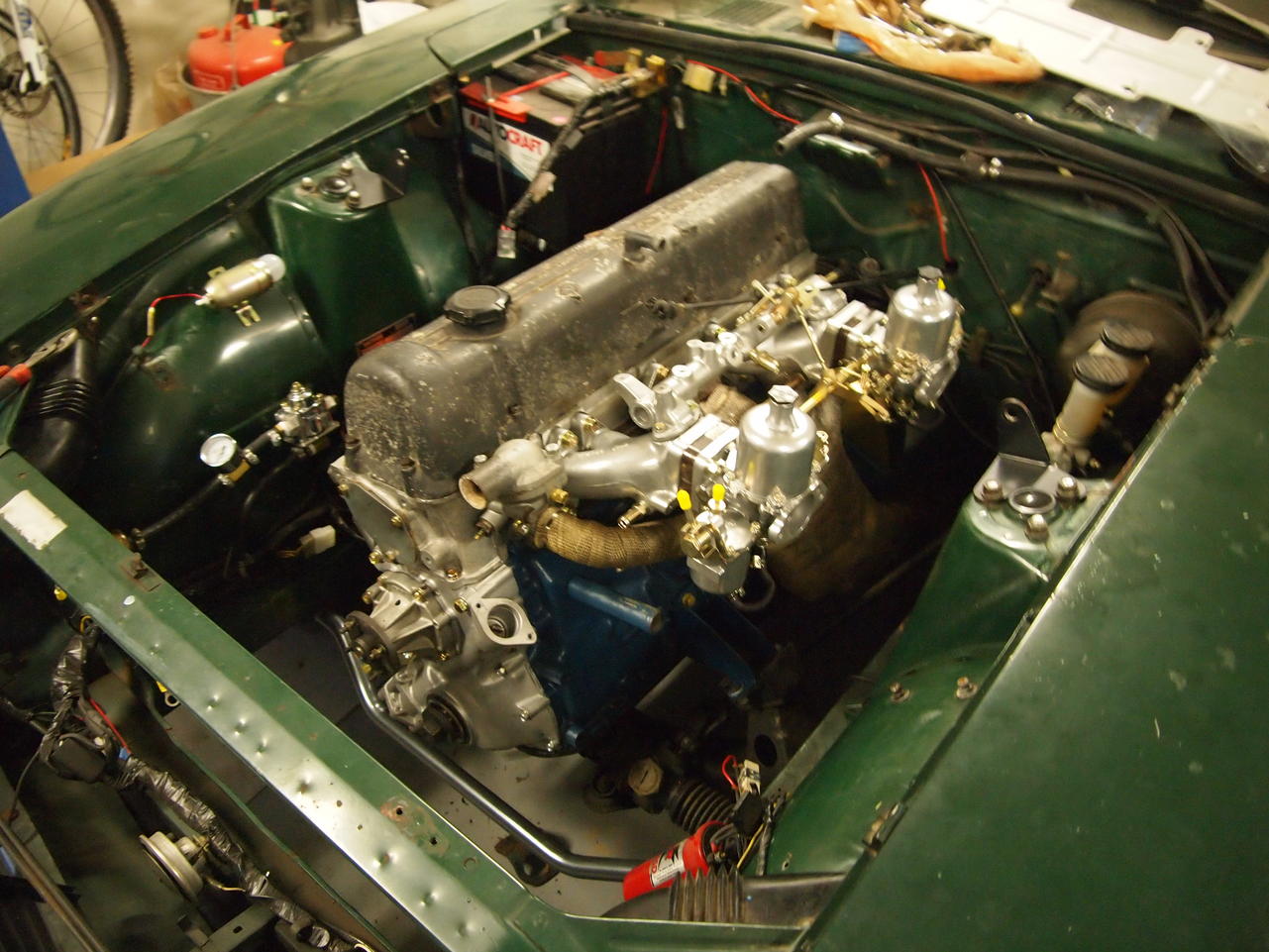

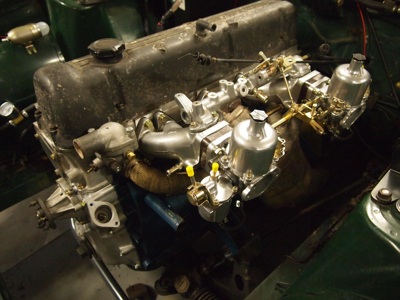

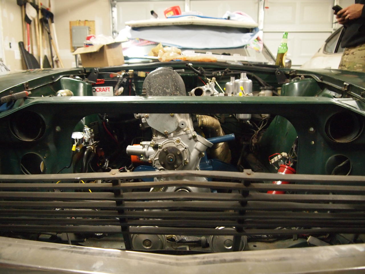

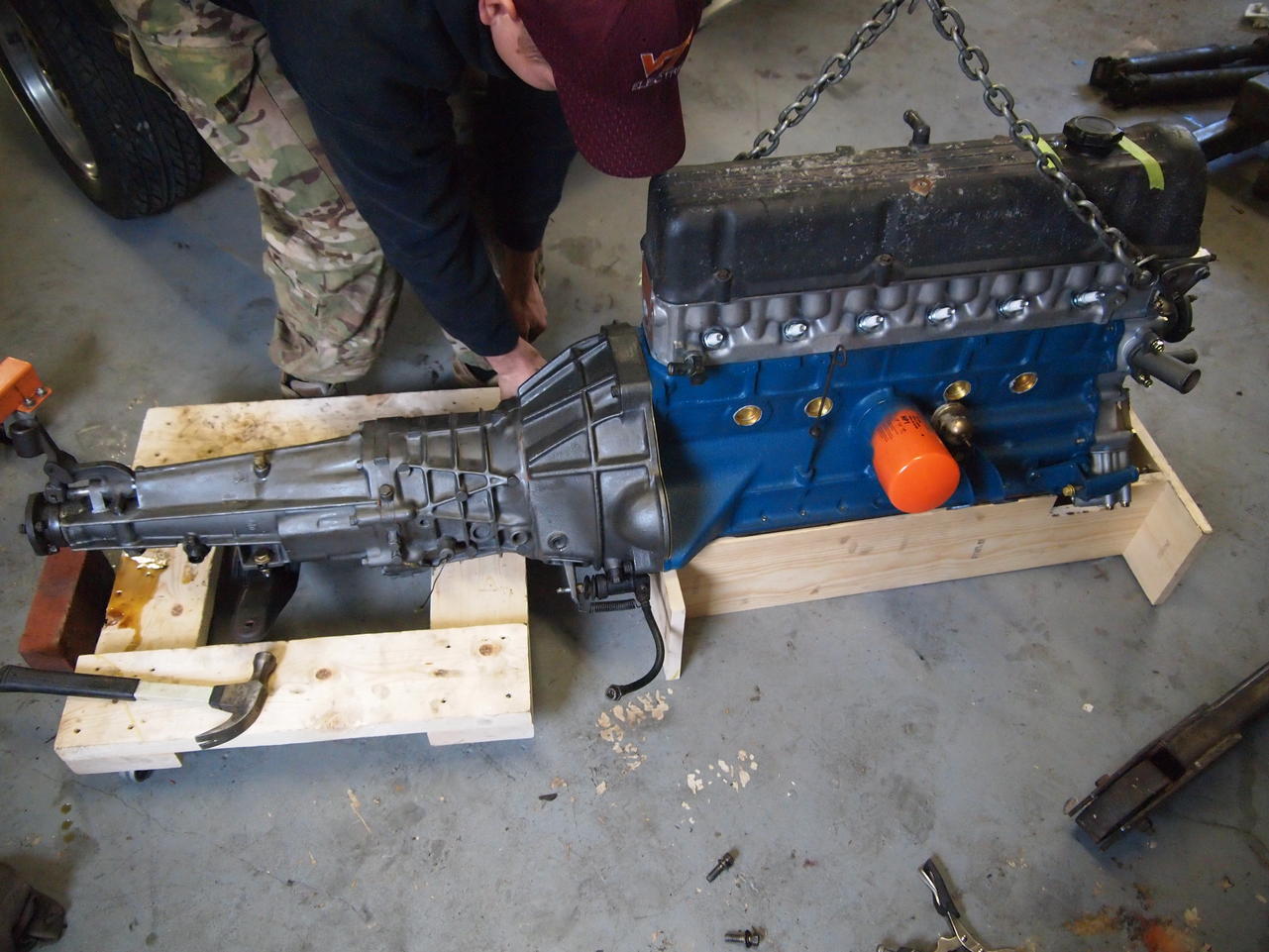

March 5, 201312 yr Author comment_416893 Threw on a spare valve cover to drop in the motor. Things came together nicely on Saturday. Got the motor in, and the Z-Therapy carbs installed as well. Valve cover is off at powder coating. Still need a crank-pulley, as mentioned earlier, and to hook up the remainder of the peripherals. Transmission/ driveshaft installed without issue as well. This is a .40 over L24, original to the car, with a beautifully machined E31 head and some fresh 4-Screw SU's. Should've done this 3 years ago... #24,140 got a new heart the same day: Link to comment https://www.classiczcars.com/forums/topic/37564-hls30-01222-project/?&page=6#findComment-416893 Share on other sites More sharing options...

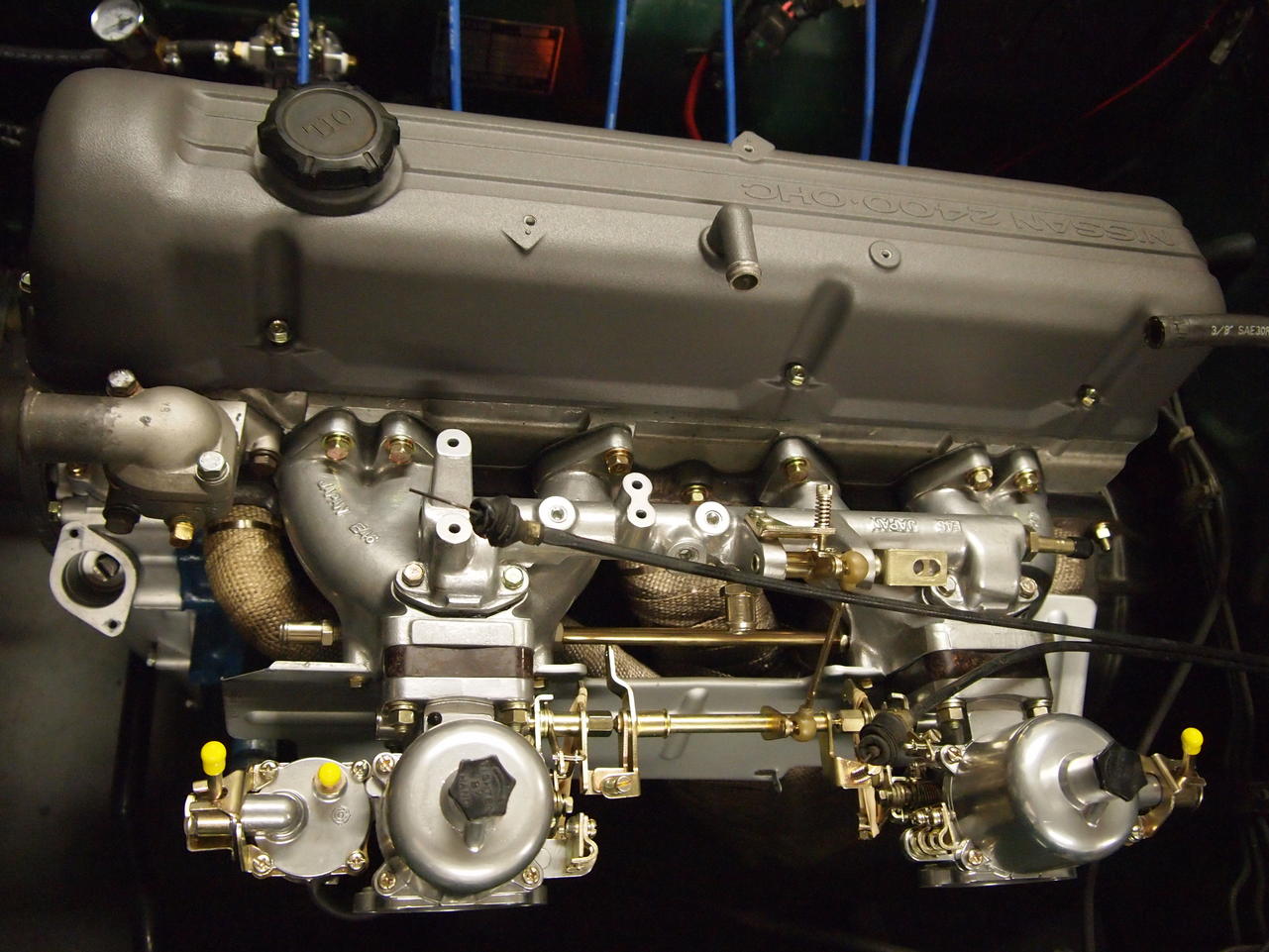

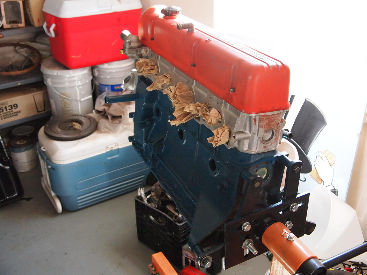

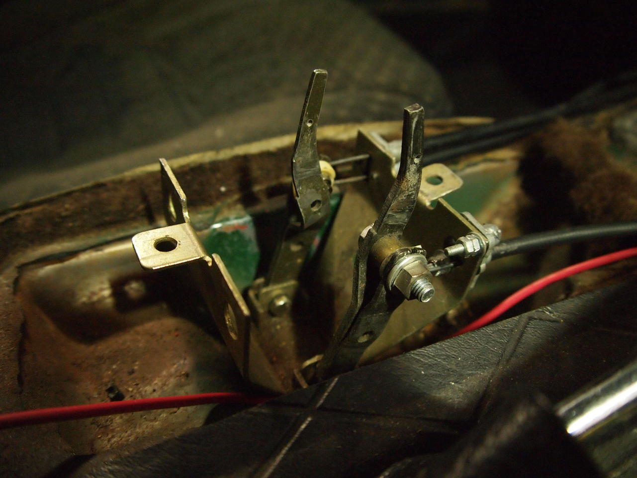

March 13, 201312 yr Author comment_417644 That throttle knob on eBay recently caught my eye, but a sale price of $153 was a bit rich for my blood, considering the car still isn't running again yet. For now, my throttle-control will continue to use a backwards choke knob. Keep your eyes peeled for me. If anyone is curious how that mechanism looks, here's a shot. Got the valve cover back from powder coating. Will be sanding off the lettering in awhile, and I'm hoping once the restored airbox is on there, it'll all come together as a nice clean package. Link to comment https://www.classiczcars.com/forums/topic/37564-hls30-01222-project/?&page=6#findComment-417644 Share on other sites More sharing options...

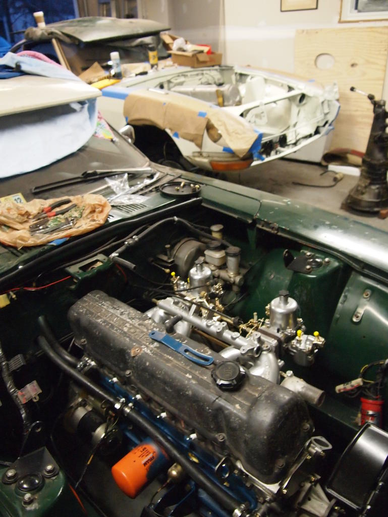

March 22, 201312 yr Author comment_418614 Here's something I ran into the other night: I had to replace the choke cables, as the ones originally with the car were chewed up badly. No problem, had a spare set lying around for some reason. Went to attach them to the SU's, however, and they're woefully short. To the extent that once they're connected to the carbs, they're stretched tightly across the dome of the SU. Did Series-I cars have longer cables, due to the placement of the knobs in comparison to later cars? I don't believe they're kinked anywhere, but will double-check. It's always something... Link to comment https://www.classiczcars.com/forums/topic/37564-hls30-01222-project/?&page=6#findComment-418614 Share on other sites More sharing options...
March 22, 201312 yr Author comment_418615 [ATTACH=CONFIG]61801[/ATTACH]You can see the choke cables in this picture, still unattached, but it shows how short they are. Link to comment https://www.classiczcars.com/forums/topic/37564-hls30-01222-project/?&page=6#findComment-418615 Share on other sites More sharing options...

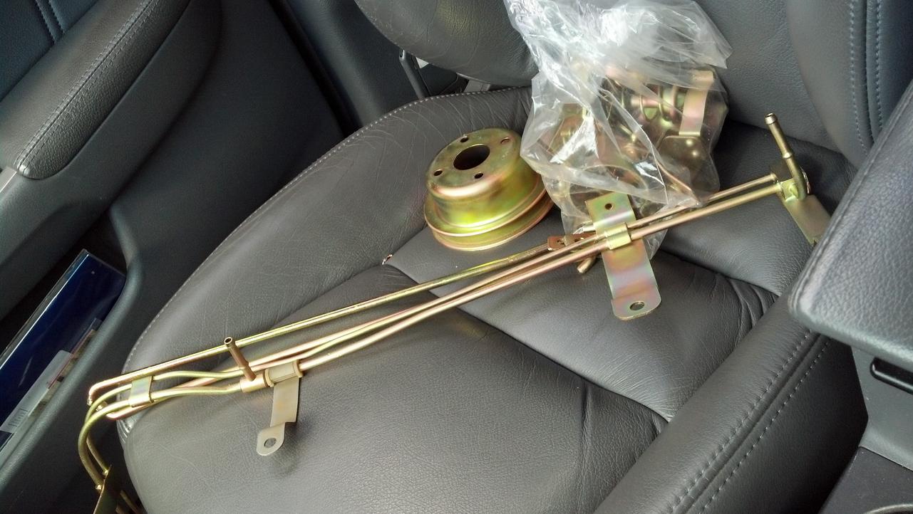

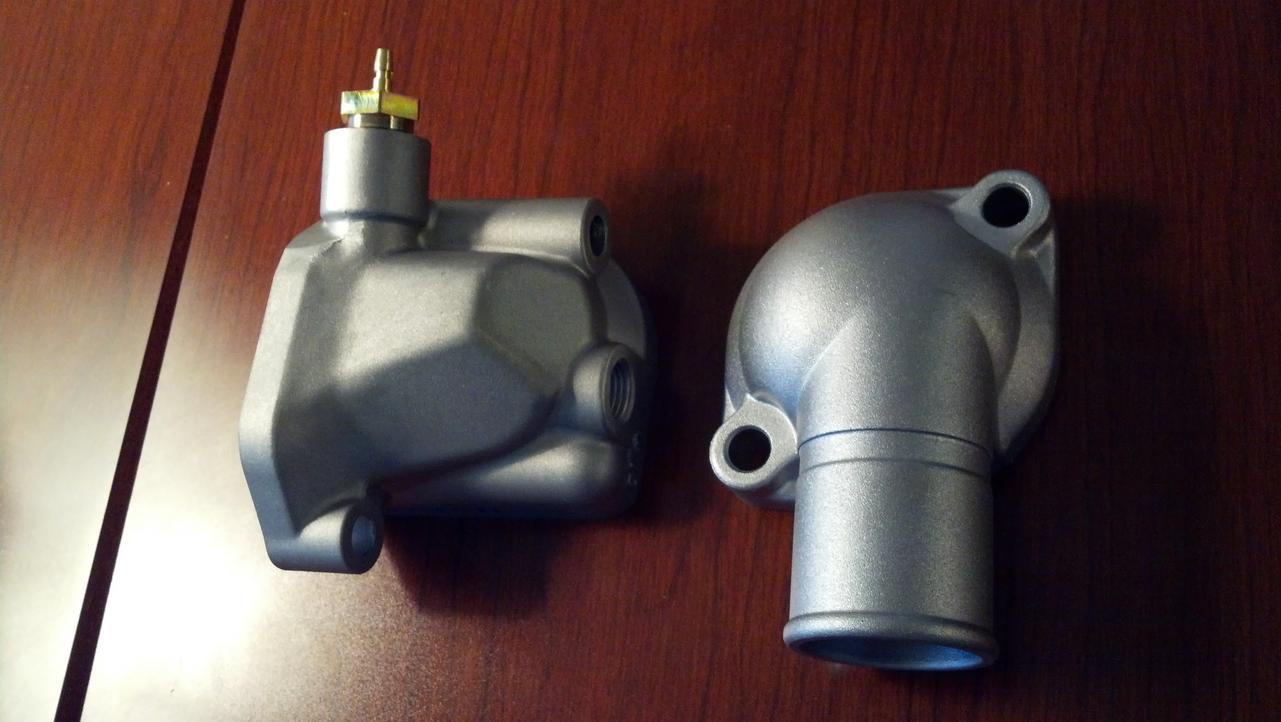

April 3, 201312 yr Author comment_419485 Wrenched down too hard on the old thermostat housing while putting in the sending unit, and cracked the housing. It's car-ma for trying to put old parts on a fresh engine. Point taken - Ordered a new thermostat housing. Picked up the fuel rail, along with some other misc. engine/ engine bay parts from Zinc Plating. Will install these this week, and hopefully over the weekend the car will be back on the road. Still need to fix the Choke-Cable situation, but thanks to a few forum members (Wade/LeonV) I think I've got a solution there, cutting down the extra-long '73 wires to the appropriate length. Barring any unpleasant surprises, this should be a fun, rewarding weekend. Edited April 3, 201312 yr by ksbeta Link to comment https://www.classiczcars.com/forums/topic/37564-hls30-01222-project/?&page=6#findComment-419485 Share on other sites More sharing options...
