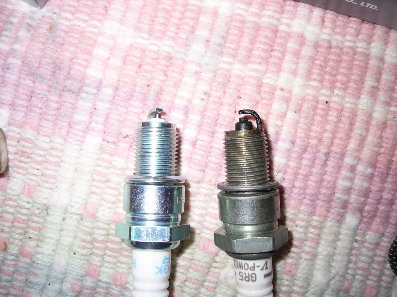

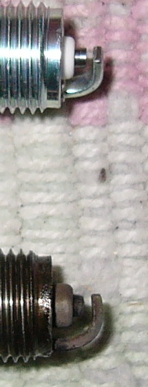

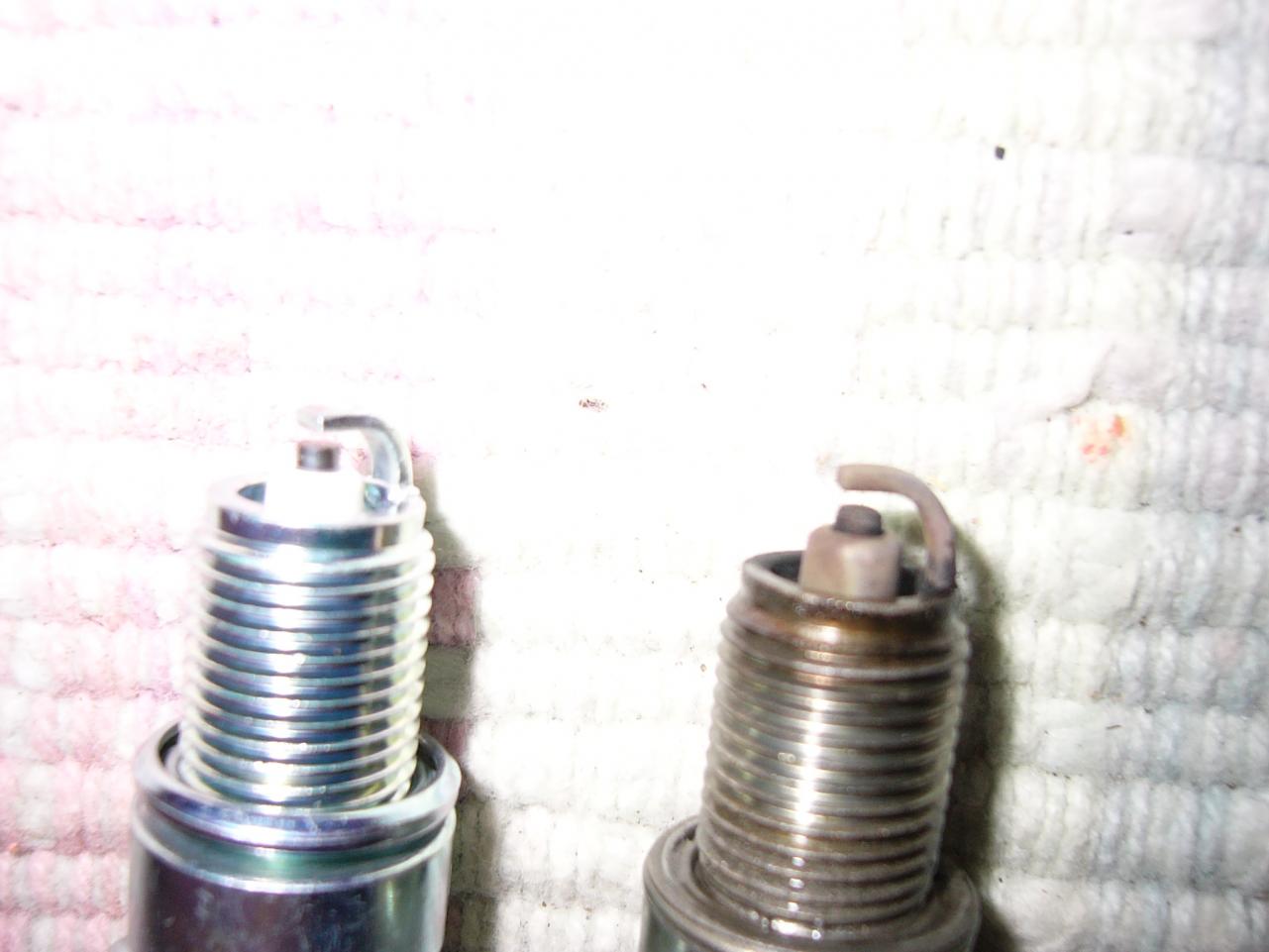

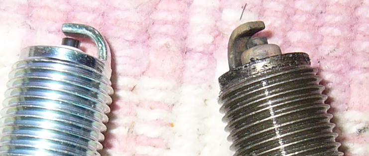

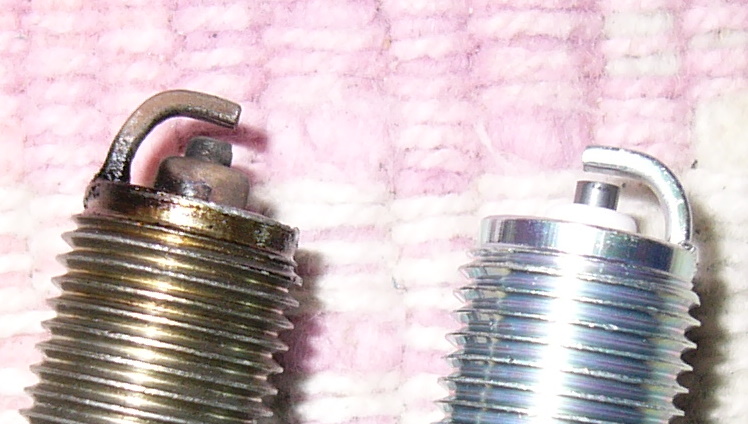

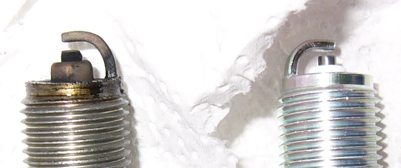

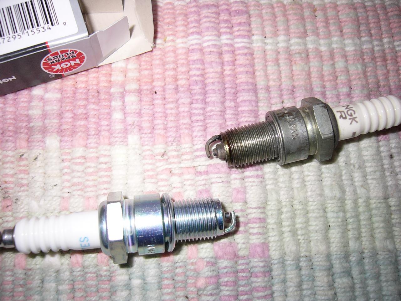

In the photos of my spark plugs, you guys can see the extra-long projected tip of these "V-Power" plugs, vs the projected tips of the regular projected NGKs. The shape of the tip has a carved-V shape on it so it doesn't look flat and shouldn't be confused with thinking that there is worn metal on the center electrodes.
The pictures are for all six cylinders, in numerical order from #1-6. I took two photos of cylinder #6 for some reason, hence the 7th unintended photo.
And a theoretical question...I wonder how much advance these projected tips deliver. That is, what is the mathematical translation between length of the tip and degrees of advance. Driving around at 10degBTDC with these new plugs was driving it around more retarded than before, hence perhaps, the tailpipe backfiring that I never got with the old plugs.

There is no relation between spark plug tip shape or length, and ignition timing. It only affects how hot the tip runs. They are specified to run just hot enough to stay carbon free, but not so hot that they cause pre-ignition. Your car is stock so the stock plugs should work fine.

you can rule out running lean, because looking at those plugs that's not your issue.
