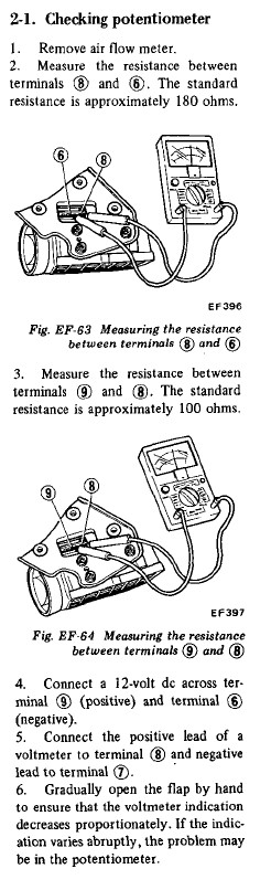

which resistance values were out of spec? I missed that part.
Here is the original thread - http://www.classiczcars.com/forums/showthread.php?t=37299
I can't remember the pin numbers but what should have been 100 was 126 and what should have been 180 was 226. My car popped and backfired through the intake when I had those numbers. A rebuilt AFM cleared it up. From what I know now, I think the whole fuel curve was shifted lean, with those high resistance numbers. I think the ECU just runs 5 volts through the potentiometer and uses the split to determine enrichment.

But I got the exact same values on two AFMs. When you said your numbers were the exact same as mine, that told me that my AFM was fine. Particularly because here's a third AFM, again with the exact same values. Maybe that is wrong. Maybe these AFMs go bad and then all arrive at the exact same numbers (126 and 226) ?
Did you do anything else to your car at the same time you had the AFM off which might account for the difference?
For some of the measurements, my backup AFM was reading higher in ohms until I cleaned it. After cleaning it, it is now within 1 ohm of my original. I could put that AFM on the car and see if there's any improvement
The EFI Bible lists "continuity" for some of the expected results. For instance pins 7-8 is listed as "continuity" yet I get exactly 200 ohms on two independently owned AFMs. So if 200 ohms is considered "continuity" then I'm guessing 126 is close enough to 100. Or, if 200 ohms is NOT continuity, then what? All bad AFMs go bad the exact same way? Ok fine but why isn't that in the Bible?
If anyone with a '75 or '76 280 wants to drop their ECU and test their working AFMs, or have already done so and can produce their results, that would be cool. If they get the same results, that will be the 4th AFM with the same values. I think that'll prove conclusively that my test results are really flying colors.
The two tests are with an ohmmeter testing pins 6 to 8, and 8 to 9.
Maybe I should be following the Bible militantly and expecting to get exactly 100 and 180 ohms or else it's gone bad?
And now for the biggest question, if the AFM is possibly responsible for this, does the AFM generally go bad all of a sudden?

Sorry Jenny, I meant that you had the exact same numbers as my bad AFM, the one that didn't work for me. When you said it was working for you after cleaning it up I left the subject alone. I did not do anything else to the car, I had to send the old one in for the core, and it was the last thing left for me to try. I tend to do things one at a time if I can so that I get the true effect of one change. For the record, with the bad AFM, my car revved fine with no load, but popped, spit and backfired when I tried to drive it.
I had the same thought that maybe some component in the AFM goes bad and they all end up at the same 126/226 values. All I know is that my rebuilt one measured 100 and 180 and the difference was night and day between the two for me.
The FSM shows continuity at the ECU connector as the quick test, then actual resistance measurements of the AFM off the car as the in-depth test, so you might get your money back if it's not the problem.

The 100 and 180 values are for the 1976 AFM for sure. In general, the AFMs are not interchangeable except for a few years. I think that 1975 and 1976 are the same, maybe 1977 too.
It's possible that 126 and 226 will work. But the FSM says not. I'm not an electronics person so can't say exactly how these values come into play.
I don't think that high resistance comes from the connectors, it comes from the resistive elements that make up the potentiometer.

How the ohmage effects the unit's function...that'd be nice to know.
Perhaps 126 and 226 are points that the unit intentionally rises to, to still be functional on the car, but yet also communicate a universal signal that it's gone bad and needs replacing/fixing.
The test you posted has the "standard" and "approximate" resistivity measures. 126 could be considered "approximate" to 100 depending on what kind of range in Ohms we're scaling with imho. It would be nice if we could form a validated consensus on this here. I'm still suspicious of units all falling back to 126 and 226 if gone bad, and if so, it's even more suspicious that this fact isn't in the EFI Bible.
Anyhoo, if three or four of you with good running stock 280s can all flash your 100s and 180s at me then I'll surrender, and go get the harness and straps because that's how I'm going to feel having to go through all this again. :cry:
AnthonyG: please do! If you could run at least the four tests that I ran in the table posted above that would be so good.
