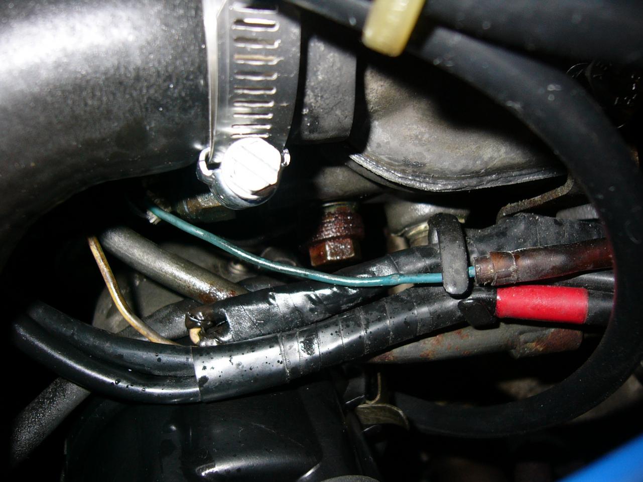

What the heck? I've got three rusty washers, a locking washer, and what looks like a ground wire coming off of the "water temperature switch". Why are these iron washers on here? I hope this isn't going to be a horror story like my alternator where some mechanic broke the bolt off and then just jammed another bolt in there (now too long for the hole, hence the washers).
The FSM just shows a bolt head there with one washer at most. Putting these washers on here has not only caused considerable rust but it's made the bolt head almost inaccessible as it's going right under the fuel rail, getting close to the distributor, there's no way I can even get a pinky underneath it to catch it when I pull it out. I don't even know for sure what this thing is...it looks smooth like a sensor but it might just be an unthreaded bolt. I got the thing loose by using the open end of a wrench from the top but I don't know how to get this long bolt and all these stupid washers off without it falling down into the engine bay somewhere. GRRRRRRRRRRRR
Not sure if all this corrosion could be related to any of my issues???
The FSM told me to take my upper radiator hose off to get to the CTS. It doesn't look very helpful to take the hose off however. I can't figure out how to get a wrench in there. :(
...do you guys think that this rust is an issue or should I just retighten it and not worry?
Edited by Jennys280Z
There's rust on both sides of the ground wire including the surface of the engine housing. I get paranoid about stuff like this. Could this resistivity on this switch cause runnability issues?
That is a ground wire. The switch just completes the ground when the engine is cold. The thermotime switch only works to shut off power to the CSV when the engine gets warm or when it gets hot from usage. It would only affect starting.
You probably have a four port housing, but since you don't have the water temperature switch for the extra pickup coil (1976 Federal, like I have) they just put a plug in the extra port.
That does look like a tight fit. I had mine off to do some manifold work when I put a new one in so can't tell you how to get in there when it's on the engine. Good luck.

Jenny, I think that rusty bolt with the washers and the one opposite it secure the thermostat housing to the cylinder head. As you deduced, the washers are there because the bolt is too long. The hazard of having that rusty bolt insert too far is that it will actually push on the back of the timing chain guide and bend it, causing problems you don't even want to think about. You can see the backside of this threaded hole if you remove your valve cover.
If I were you, I'd first remove the thermostat housing cover via the two bolts on top and then the thermostat housing via the two bolts on the side. then you can replace the sensor and put everything back. The reason I recommend taking all this apart is that it will be corroded. The longer it corrodes, the harder the bolts will be to remove. The bolts probably need freshening, and the threaded holes should be chased out with a tap. (Note, watch the aforementioned threaded hole very carefully with the valve cover removed as you chase the threads out, so that you don't damage the timing chain guide.) This is also a great opportunity to get a fresh gasket between the thermo housing and head. Seepage there can cause you big headaches later.
Be careful, because of the corrosion. Use lots of PBlaster. Reassemble with plenty of antisieze. Check my "purs like a kitten" thread for a recommendation by ZTrain to place studs in the thermo housing for the cover. I did that, and it worked great.
If your bolts don't turn with reasonable force, don't get heroic. It might not be worth the fight (and the broken bolts). Just go for the coolant temp sensor by itself. It will be hard to access, but it probably won't be screwed in too tight.
