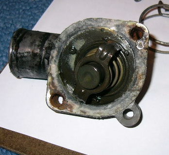

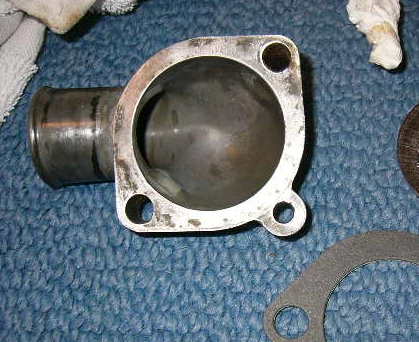

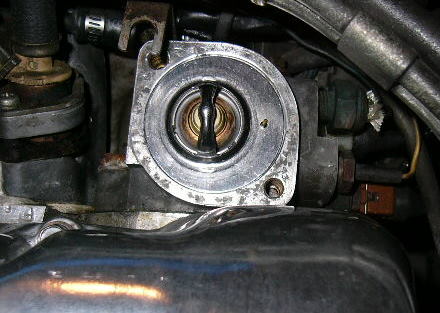

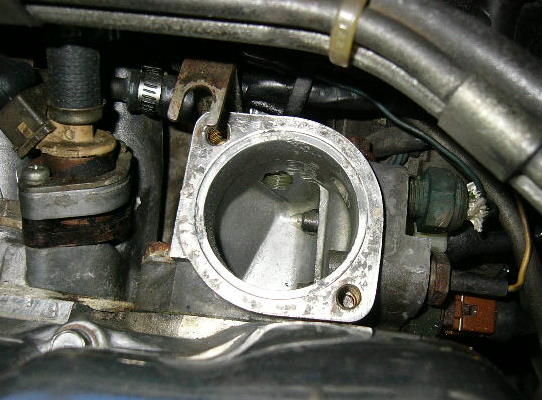

Okay so I took the thermostat housing off and the thermostat came off with it. It was definitely stuck open, more than half way open at least. And it was jammed into the housing at an angle and I got lucky that I was able to yank it out by myself. The flange of the thermostat was even bent from the force of the coolant. Don't know why this happened. Maybe someone didn't seat it right the last time they installed it so that it worked for a while and then failed like this, or maybe this is how they sometimes fail when installed correctly...
So I got the OE 180degF thermostat from NAPA. Put it on already and it works great. My car heats up perfectly. The temperature gauge is reading normally like it used to and rose to about 180 degrees and held. The first time I fired up the motor with the new thermostat installed, it idled perfectly for about 15-20 seconds. At least I think it was longer than 8 seconds, but maybe it wasn't. It was a smooth idle at 800RPM like it should be, and then after that 15 or so seconds the RPM sunk to 500-550 again and it was a slow rise back to 800 again. Though with the new thermostat it took a lot less time for the idle speed to increase to normal. I had to idle the car for 30-45 minutes to get to 800RPM before where now it took like 5-10 minutes.

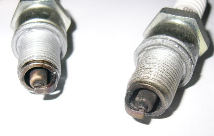

I'll post some pictures of my spark plugs I took the other day from cylinders #1 and #3 (before I cleaned and gapped them of course) and old/new thermostat stuff.

I suspect your original thermostat wasn't seated carefully when it was installed. I've never see a thermostat jammed into the housing that way, but of course I've only replaced a handfull of thermostats in my lifetime. The water pressure shouldn't be enough to bend a thermostat. My guess is that the thermostat was bent when it went in, which was why it didn't seat properly. Either that, or it was somehow bent when the shell was bolted down on the improperly positioned thermostat.
Your spark plugs look a bit like mine did when I was running very lean. I was fooled by the carbon buildup on the plugs, but I think the cause for that was the incomplete combustion of my lean mix before the exhaust valve was opened. Lean mixtures burn much slower than proper mixtures. I think the really slow burn was also what resulted in the hard puffs in the exhaust. (I think the continuation of the burn even when the intake valve opens is what detinates the intake gasses, resulting in backfire.) My engine was full of carbon sludge, BTW, probably from the same problem. Now that my fuel /air mixture is richer, I'm getting more rapid, complete burning. My plugs look much, much cleaner now. Anyway, what the plug-reading charts don't generally show you is the appearance of a plug in a super-lean-running engine.
