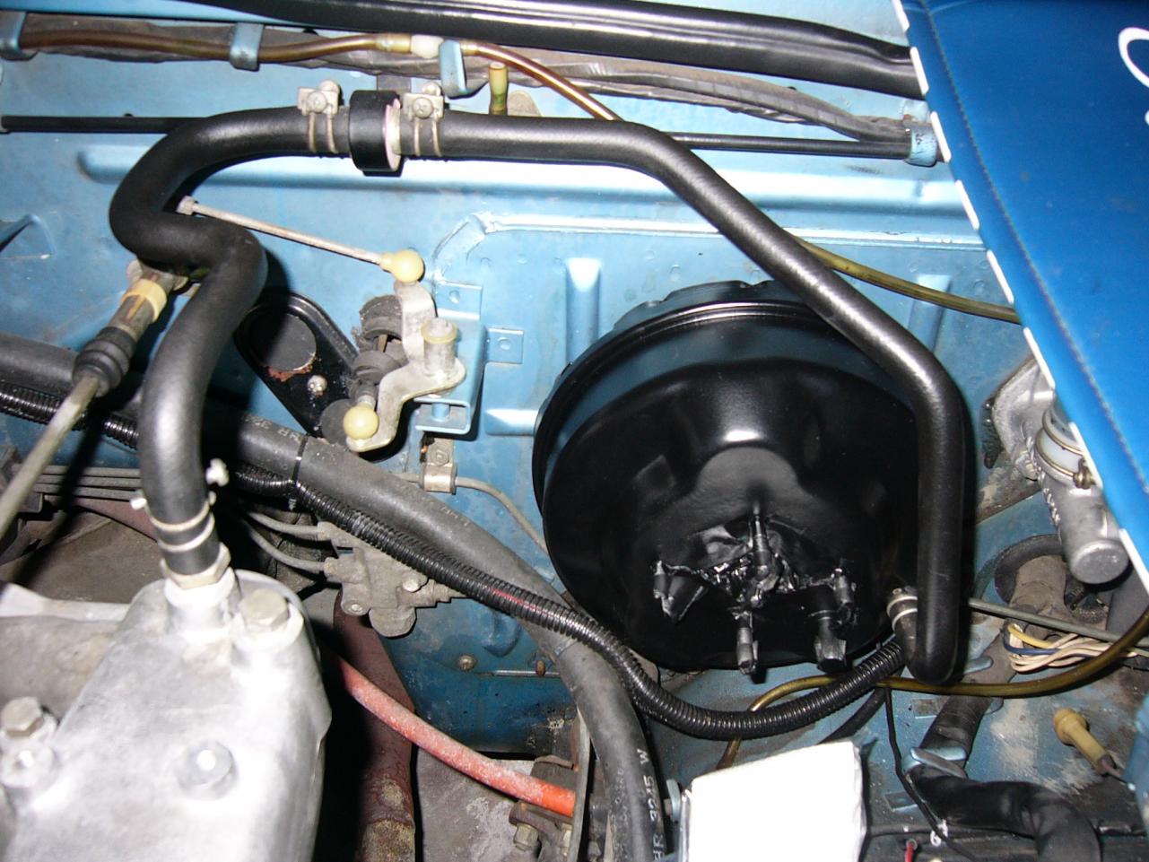

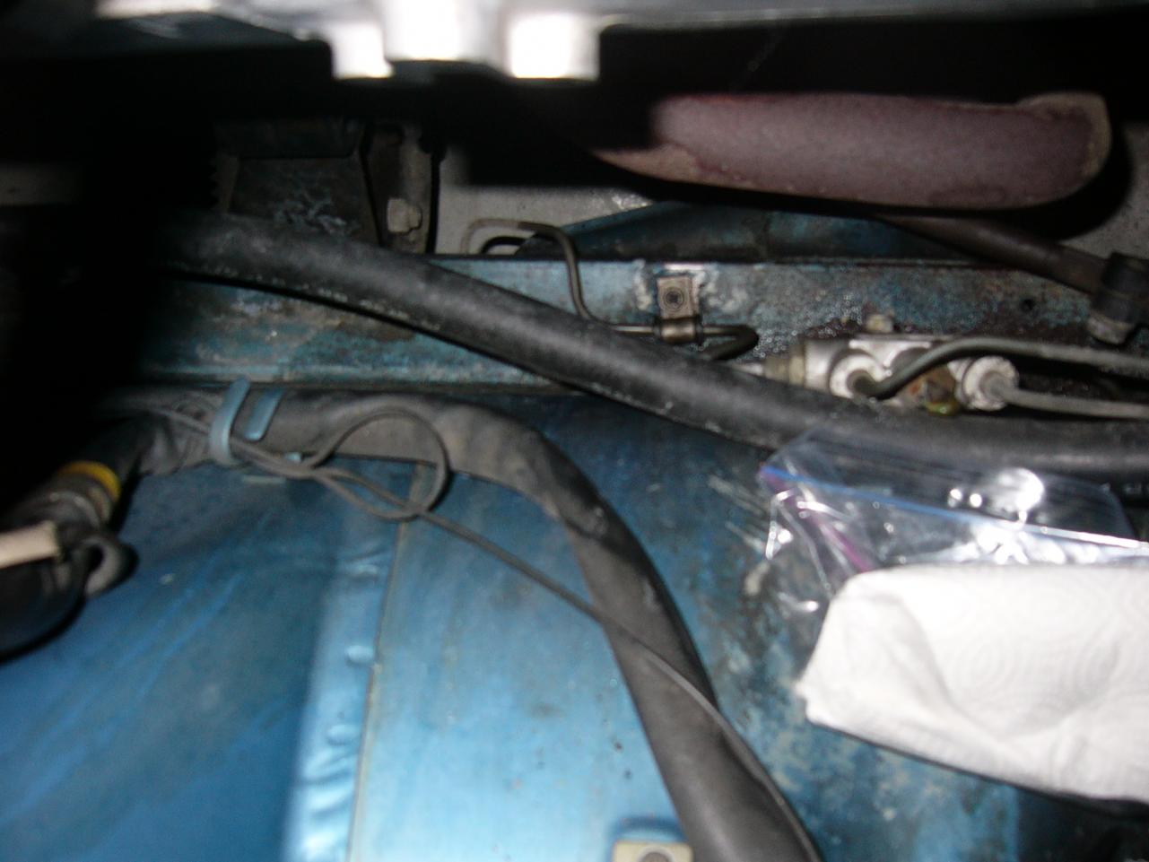

January 9, 201114 yr Author comment_341343 Thank you Zed Head! I wasn't aware of the wires I had to remove but I was questioning about this earlier in this thread in fact. Seeing the rebuilt distributors with wires sticking out confused me. I'll take a much closer look at it. That's a very interesting idea of servicing/rebuilding the distributor I have now Zed Head, and I see the worthwhile of attempting to. I can always buy a new one anyway. And put it in and tinker with adjusting it while I also have my old one in my hand and can leisurely tinker with it. Do people change their carbon canister filters? I suspect mine still works and doesn't leak but shouldn't I change the filter so it works better? My new brake booster is on. yaay! The satin black paint looks gorgeous! I could finish the job tonight but I am looking down at my frame rail (or whatever that is) and noticing that it's dirty and grimey and probably slathered multiple times with fluids of all kinds but especially brake fluid which has eaten away the paint in large spots. And where the paint has worn off there is rust begining to form on the surface. It's always stuff like this which sloooooowwwwsssss me down but one of the reasons why I do stuff myself is so I know it was done well. I'm going to clean the rail with soap, water and a rag and a good rubbing. Then dry it and see how bad it looks. If I see anything that's the color of rust I'm going to sand it off. Then I'm going to prime it. And if I'm feeling "spanky" I'm going to hand-paint it in the original blue color ie. my touch-up paint! Thinking out loud is so much fun! I included a few photos for posterity. Inside the front of the AFM, at the golden door to the throttle body, down at my new booster (notice no EGR on the intake), and straight down at the gnasty frame rail thingie. None of the fluid leaks and general nastiness are my fault. All that mess has been made by professionals, ie other people. It's cold outside and I don't want to clean it now! Since I'm going to put this off till tomorrow....how should I seal the plate that attaches between the master cylinder and the booster? I have some high temp RTV silicone gasket sealer (dark gray) should I just use that? Edited January 9, 201114 yr by Jennys280Z Link to comment https://www.classiczcars.com/forums/topic/37707-76-280z-question-on-distmanifold-vacuum-dist-timing-fuel-pressure-brake-booster/?&page=9#findComment-341343 Share on other sites More sharing options...

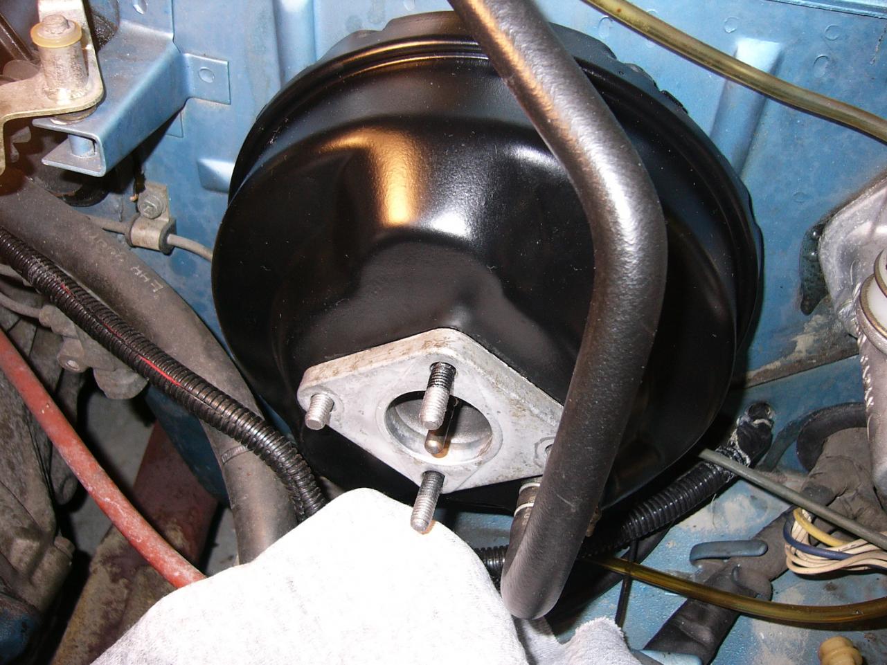

January 10, 201114 yr comment_341446 Hey Jenny, nice work! I don't recall ever seeing a master cylinder sealed with caulk to a booster. I suspect if that junction needed to be sealed, there's be a gasket for it. Caulk between the booster and firewall would make more sense, but even that might be an optional sort of thing. Regarding the distributor, you can spend a lot of time trying to keep those funky things in repair, but all I have to do, if one acts funny, is to pull it off, take it in, swap for a new one under warranty, reinstall, and re-time. That's $100 well spent, IMO. I don't know if I have the right advance curve, but it seems to work just fine in my '78. No knocking or pinging. Just sayin'. Hey, we did get the red '94 Miata. It wasn't all I thought it would be, but I think it was a good enough deal. The car runs like a top and has a pretty decent paint job. The body is straight, with one replacement fender and the rest original. It has some mild underbody rust issues (nothing structural) and will be having lots of fun with cosmoline this spring. (I'll also be rustproofing many parts of my Z.) Oh yes, and it has a couple of leaks in the ragtop seals, just like every other convertable on the planet. I'll have to fix those too. Link to comment https://www.classiczcars.com/forums/topic/37707-76-280z-question-on-distmanifold-vacuum-dist-timing-fuel-pressure-brake-booster/?&page=9#findComment-341446 Share on other sites More sharing options...
January 10, 201114 yr Author comment_341483 Hey Jenny, nice work! I don't recall ever seeing a master cylinder sealed with caulk to a booster. I suspect if that junction needed to be sealed, there's be a gasket for it. Caulk between the booster and firewall would make more sense, but even that might be an optional sort of thing. Regarding the distributor, you can spend a lot of time trying to keep those funky things in repair, but all I have to do, if one acts funny, is to pull it off, take it in, swap for a new one under warranty, reinstall, and re-time. That's $100 well spent, IMO. I don't know if I have the right advance curve, but it seems to work just fine in my '78. No knocking or pinging. Just sayin'. Hey, we did get the red '94 Miata. It wasn't all I thought it would be, but I think it was a good enough deal. The car runs like a top and has a pretty decent paint job. The body is straight, with one replacement fender and the rest original. It has some mild underbody rust issues (nothing structural) and will be having lots of fun with cosmoline this spring. (I'll also be rustproofing many parts of my Z.) Oh yes, and it has a couple of leaks in the ragtop seals, just like every other convertable on the planet. I'll have to fix those too. No sealant, it is, then! Well if the Miata runs great that's what's most important I think (aside from the body being straight with nothing more than surface rust). The engine in that thing is interesting too. Something that will be fun for you to look at I think. The car is fun to drive so you couldn't have made a bad decision. Little update: My master cylinder is on yaaay I didn't put any paint on that framerail at all, just some industrial grade primer. I cleaned it with a rag and could see where patches of blue paint had come off. I put some sandpaper to it but wasn't lifting anything up off the metal surface. It looked pretty grey as opposed to looking rusty. No rust came off on the rag when I cleaned it, or on the sandpaper when I tried to sand it. So I just painted primer over it with a brush and called it good. Paint would have been more permanent but I want to find out more about how people restore these places on their cars. Obviously stripping everything off and giving it a proper paint job would be ideal, but I don't have the ducats for that. Link to comment https://www.classiczcars.com/forums/topic/37707-76-280z-question-on-distmanifold-vacuum-dist-timing-fuel-pressure-brake-booster/?&page=9#findComment-341483 Share on other sites More sharing options...

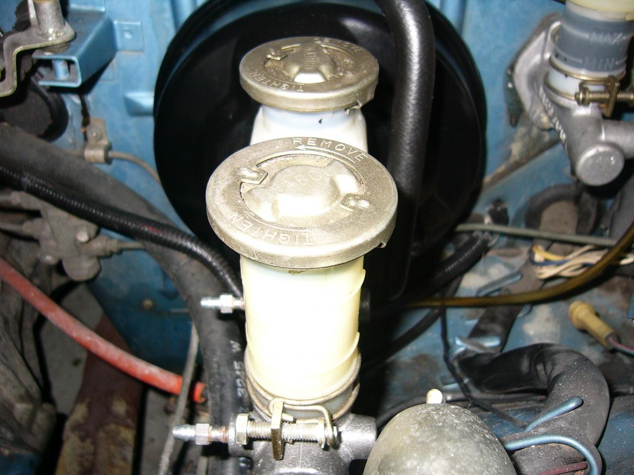

January 10, 201114 yr Author comment_341484 In the picture of my master cylinder, does my clutch fluid look too dark? Link to comment https://www.classiczcars.com/forums/topic/37707-76-280z-question-on-distmanifold-vacuum-dist-timing-fuel-pressure-brake-booster/?&page=9#findComment-341484 Share on other sites More sharing options...

January 10, 201114 yr comment_341493 In the picture of my master cylinder, does my clutch fluid look too dark?Yes, if it were mine, I'd change it. One of those 'while I'm at it'.Bonzi Lon Edited January 10, 201114 yr by Bonzi Lon Link to comment https://www.classiczcars.com/forums/topic/37707-76-280z-question-on-distmanifold-vacuum-dist-timing-fuel-pressure-brake-booster/?&page=9#findComment-341493 Share on other sites More sharing options...
