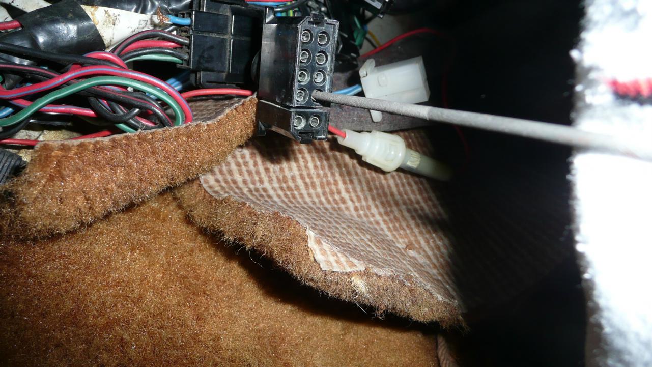

This is a picture of the electrical connection to clean for the left hazard light.
Passenger side, behind radio. There are 2 black plugs. Easiest way to identify the right one is to unplug it and see if the hazard light stops.
Be careful with those connectors. there seem to get looser every time you play with them.
BTW-
Your wiring looks like the same rats-nest I have. Is that usual, or did time really twist up all the wires behind the radio in my car? I figured you could just use a certain untwisting motion, and they will go back to being straight again, so you could tie them up in neat bundles.
Pulling the plug around to I could take the picture made it look more twisted.
Pipe cleaner is a good idea on these connectors.
How do you clean the flat ones that are on plugs (female side) like the water temp sensor, etc.?
