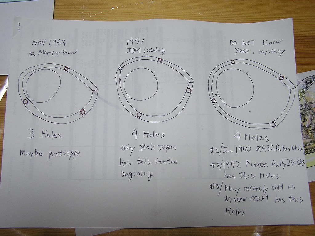

November 27, 201014 yr Author comment_337093 Chris, Esprist, Anyone, I need professional help here.There are a few points I would like to clarify. Starting from post #1. Esprist referred to the sellers pic and said the headlight cover on the right was the early version, driver's side (assuming LHD). Also, Esprist believed the covers were sitting on the wrong boxes (switched). Isn't the original, early version the one on the left and sitting atop the correct box?I hope so, because I have always thought that my rings were the early type which coincide with #63900-E4126 & #63901-E4126.The rings I have are the same as depicted in the instruction sheet, with the holes oriented the same. I believe the cover on the right in the pic is the later #63901-E8726. Which brings me to this. I remember a while back, reading a post where a member used his OEM rings on a set of reproduction lenses because of the difficulty of fitting the repro rings. I can't remember the members ID but can remember the car and installation pic. It was IIRC, a red Z with the front bumper rubber removed. Anyone remember it? Now, I am wondering which OEM rings were used on his repro lenses. I am going to look for that post again. EDIT:Found it, it was 240ZGL. He has the later OEM style which allowed him to mix n match and looks great!: http://www.classiczcars.com/forums/showpost.php?p=322187&postcount=11 Well, I did not know anthing about different types of headlight cover until my master Katz made a detailed coment last year http://www.classiczcars.com/forums/showthread.php?t=31601 By the way, the reproduction ones have gray rubber gasket all the way around while Genuine ones have glued black rubber that is almost impossible to remove. Link to comment https://www.classiczcars.com/forums/topic/37766-jdm-headlight-cover-difference/?&page=3#findComment-337093 Share on other sites More sharing options...

November 27, 201014 yr Author comment_337098 I believe the guy that operates zccjdm.com is a member here and this is a post he made about the reproductions he sells http://www.classiczcars.com/forums/showpost.php?p=275419&postcount=25.I have one set of lenses and rings that were supposedly OEM, but without the hardware or the boxes (makes me think they are actually repros). I also have one set of used rings that I am certain must be OEM because I got them from an older local guy that had kept them from a car he had years ago. No hardware for them either, but that seems to be fairly easy to recreate. I'll have to dig them out later and see exactly what I have.-MikeThere is only one kind of reproduction JDM type headlight covers. His is from Japan as well. And I know who has the mold and sells them. It is about 24000Yen Plus shipping. So about $300 at cost if you bring few.These are made in China and lenses are OK but the rings are unbelievable shape (mot even streight) and very poor chome quality.I wish this was the later type lenses.... Link to comment https://www.classiczcars.com/forums/topic/37766-jdm-headlight-cover-difference/?&page=3#findComment-337098 Share on other sites More sharing options...
November 27, 201014 yr comment_337106 There is only one kind of reproduction JDM type headlight covers....I wish this was the later type lenses....You are making the same mistake again. These lenses will fit with the "later" OEM trim rings but will not fit with the original OEM "early" trim rings.-First pic - "later" OEM trim rings mounted on reproduction lenses.-Second pic - OEM "later" lense & trim ring-Third pic - OEM original "early" lense & trim ring on the left, OEM "later" lense & trim ring on the rightI know it can be confusing and I think you are referring to the shape of the lense and not what it will fit or match up with. Edited November 27, 201014 yr by geezer Link to comment https://www.classiczcars.com/forums/topic/37766-jdm-headlight-cover-difference/?&page=3#findComment-337106 Share on other sites More sharing options...
November 27, 201014 yr Author comment_337122 You are making the same mistake again. These lenses will fit with the "later" OEM trim rings but will not fit with the original OEM "early" trim rings.-First pic - "later" OEM trim rings mounted on reproduction lenses.-Second pic - OEM "later" lense & trim ring-Third pic - OEM original "early" lense & trim ring on the left, OEM "later" lense & trim ring on the rightI know it can be confusing and I think you are referring to the shape of the lense and not what it will fit or match up with.Ok...Well do they have different parts# between old ones and new ones?If so, early production ones are better made than later ones....... Link to comment https://www.classiczcars.com/forums/topic/37766-jdm-headlight-cover-difference/?&page=3#findComment-337122 Share on other sites More sharing options...
