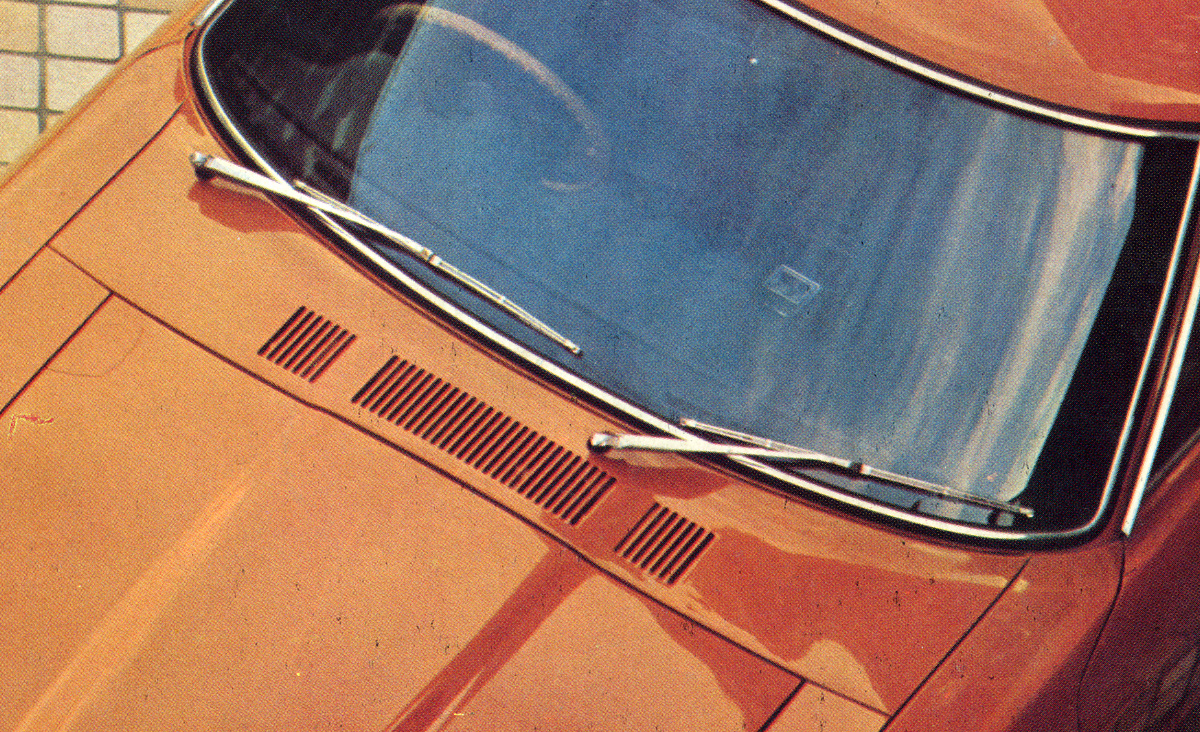

December 1, 201014 yr comment_337562 Looking at the photos and changing the subject for a sec, the wire-style wipers were OEM? Yes, OEM on some 'early' ( ) Japanese market cars: Link to comment https://www.classiczcars.com/forums/topic/37766-jdm-headlight-cover-difference/?&page=6#findComment-337562 Share on other sites More sharing options...
