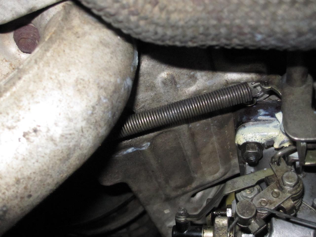

November 29, 201014 yr comment_337347 I don't think Casey is trying to be funny. The 240Z requires a deft touch on the throttle. It is unique and has been a source of complaints from many an owner.Back to the problem...These are 40 year old cars and it is entirely possible that a prior owner screwed something up. Give something a try...Disconnect the return spring on the the throttle lever and see if that has a significant effect on the break-out force. It's possible that you have an incorrect return spring.If that doesn't help, it would be worth the effort to disassemble the ENTIRE throttle linkage & interlock link on the carbs to determine if something is corroded or otherwise binding. Check the spring first 'cause its easy. Edited November 29, 201014 yr by Gary in NJ Link to comment https://www.classiczcars.com/forums/topic/37785-sotck-71-240z-carb-problem/?&page=3#findComment-337347 Share on other sites More sharing options...
November 29, 201014 yr Author comment_337350 I don't think Casey is trying to be funny. The 240Z requires a deft touch on the throttle. It is unique and has been a source of complaints from many an owner.Back to the problem...These are 40 year old cars and it is entirely possible that a prior owner screwed something up. Give something a try...Disconnect the return spring on the the throttle lever and see if that has a significant effect on the break-out force. It's possible that you have an incorrect return spring.If that doesn't help, it would be worth the effort to disassemble the ENTIRE throttle linkage & interlock link on the carbs to determine if something is corroded or otherwise binding. Check the spring first 'cause its easy.I know he wasn't trying to be funny, I appreciate all input on this topic...I did disconnect the springs and clean/lube them... I thought MAYBE they were all gummed up and sticking to themselves. That did not help. They LOOK correct. They do not seem to require a great deal of force to start to expand... and they do not seem to have any sort of "curve" to their spring rate that would make them tougher at the start... BUT I am willing to revisit the spring thing... and I'll post pics of them too...Mark Link to comment https://www.classiczcars.com/forums/topic/37785-sotck-71-240z-carb-problem/?&page=3#findComment-337350 Share on other sites More sharing options...

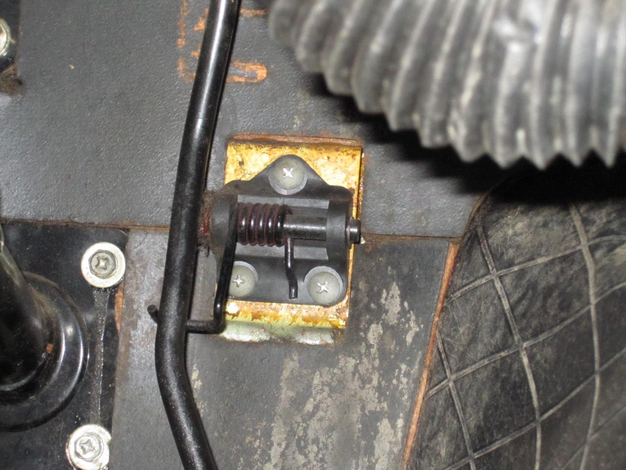

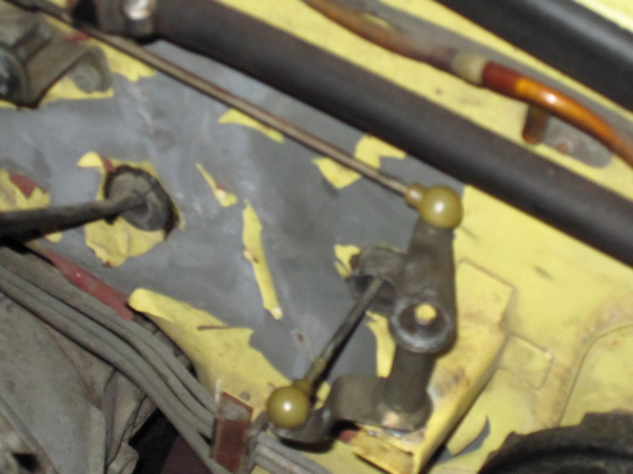

November 29, 201014 yr comment_337369 ZTherapy disclaimer -- You need carbs!!Now that that is out of the way, there's not much I can add to what you already have in hand. I've stumbled across this herky jerky gas pedal thing off and on over the years and if memory serves, changing the pedal height helped more than anything plus just getting used to what was going on.How heavy is the spring that goes to the bellcrank on the firewall? Maybe shoot us a picture showing the piece the spring and the dogbone hooks too. If the orientation of that's not up and down, but over center that can cause what you're describing.Call me with a credit card and we'll get the springs heading your way... Link to comment https://www.classiczcars.com/forums/topic/37785-sotck-71-240z-carb-problem/?&page=3#findComment-337369 Share on other sites More sharing options...
November 29, 201014 yr Author comment_337372 Pictures... Good? Bad? Link to comment https://www.classiczcars.com/forums/topic/37785-sotck-71-240z-carb-problem/?&page=3#findComment-337372 Share on other sites More sharing options...
