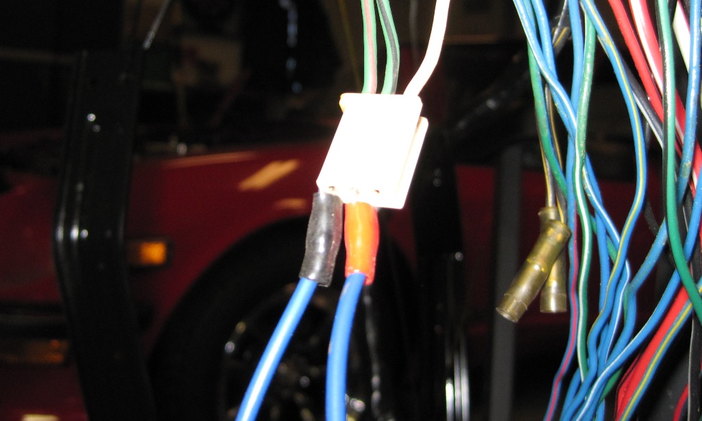

First, please clarify something for me. When you say you have continuity between GR & GB, is that with both ends of that section of harness disconnected? If so, anticipate having to replace connectors. Can you post pictures of the harness, especially around the connectors?

the picture is the T/S combo connector. The white wire goes to the flasher unit. There isn't continuity until I attach the tach connector and goes away when I remove the WR or WB turn signal indicator lights at the back of the tach.
Okay, I'll look at the wiring diagram again when I get home tonight.
Check the condition of the bulb sockets for the turn signals going to the tach housing. You make it sound like that is where the circuits are crossing.
Until you diagnose what is up there, leave that unplugged, and examine the other points I listed earlier. While it's great to have the turn signal light indicators on the dash, it's not crucial in tracking down the other problems.
