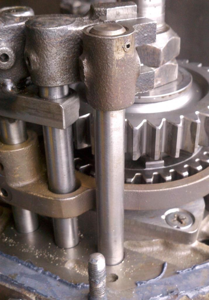

December 14, 201014 yr comment_338873 I use a C type sx180 box , We did the modification to a 240Z bellhouse and fitted a Kamiari close ratio kit 2.62-1.81-1.36-1.00-0.83And using a R180 GrN Prodrive 4.40 diff with my own output flanges Link to comment https://www.classiczcars.com/forums/topic/37910-transmissiondiff-setups-for-240z-vintage-race-car/?&page=2#findComment-338873 Share on other sites More sharing options...
