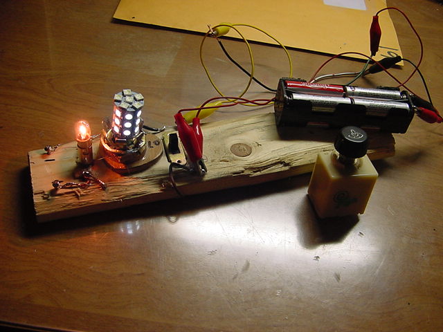

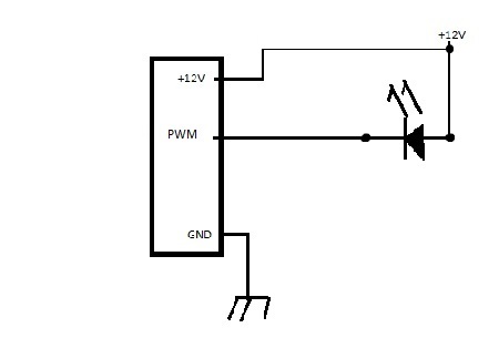

April 10, 20168 yr comment_492309 I set up the test rig for the Toyota PWM dimmer and it worked. I tried it with combinations of incandescent and LED bulbs and I got the best control (0-100% brightness) using the combination of bulbs, as we discovered works best with the stock rheostat. The module didn't get warm or let the magic smoke out, so I can only try in in the car. I think you will need to run 1 witre from a 12V source (the headlamp switch) You only have to figure out what mix of incandescent & LED bulbs will illuminate things correctly. The test rig diagram: This photo has a mixture of bulbs, with the control set to full-on. The dimmer is from a 1990s Toyota Corolla or Celica. Edited April 10, 20168 yr by TomoHawk Link to comment https://www.classiczcars.com/forums/topic/37915-sold-on-leds/?&page=13#findComment-492309 Share on other sites More sharing options...
