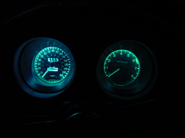

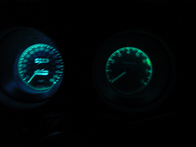

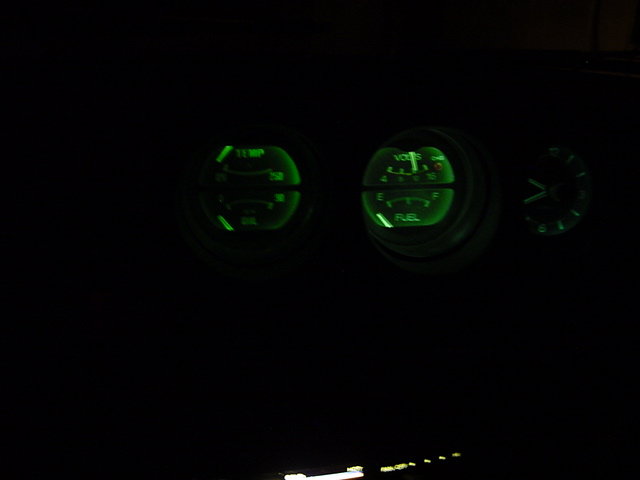

April 26, 20168 yr comment_493605 I was able to get some photos of the gauges in the dark. My camera won't adjust things like most smart phones do, so I tried some things myself. First, I adjusted the "EV" value to +2.0 which didn't do anything in the dark. So using what I can remember from the days of 35mm, I tried different shutter speeds like 8sec, 2sec, and 1 sec. 8 seconds was too bright, and even with the tripod, it was too blurry. 2 Sec. was still too blurry, though it was only hand-held.The latter (1 sec.) resulted in a photo you could make out. The two tachos were hand-painted inside with gloss-white paint. I also painted the back of the speedometer faceplate gloss-white. Most of the gauges and the heater panel have 24-emiiter BA9S LED bulbs. The clock has a 5-emiiter bulb, which I think I will change to a 24 next winter. It has enough light to make out the marks, but it's less important than the other gauges, so I'll leave it as-is. I also used a green permanent marker to color the LEDs. The heater panel LED wasn't colored so the printed colors of the panel show nicely.The electronic (PWM) dimmer is set to the lowest setting so that the LEDs are ON; any lower, and the lights are OFF. Edited April 26, 20168 yr by TomoHawk Link to comment https://www.classiczcars.com/forums/topic/37915-sold-on-leds/?&page=16#findComment-493605 Share on other sites More sharing options...

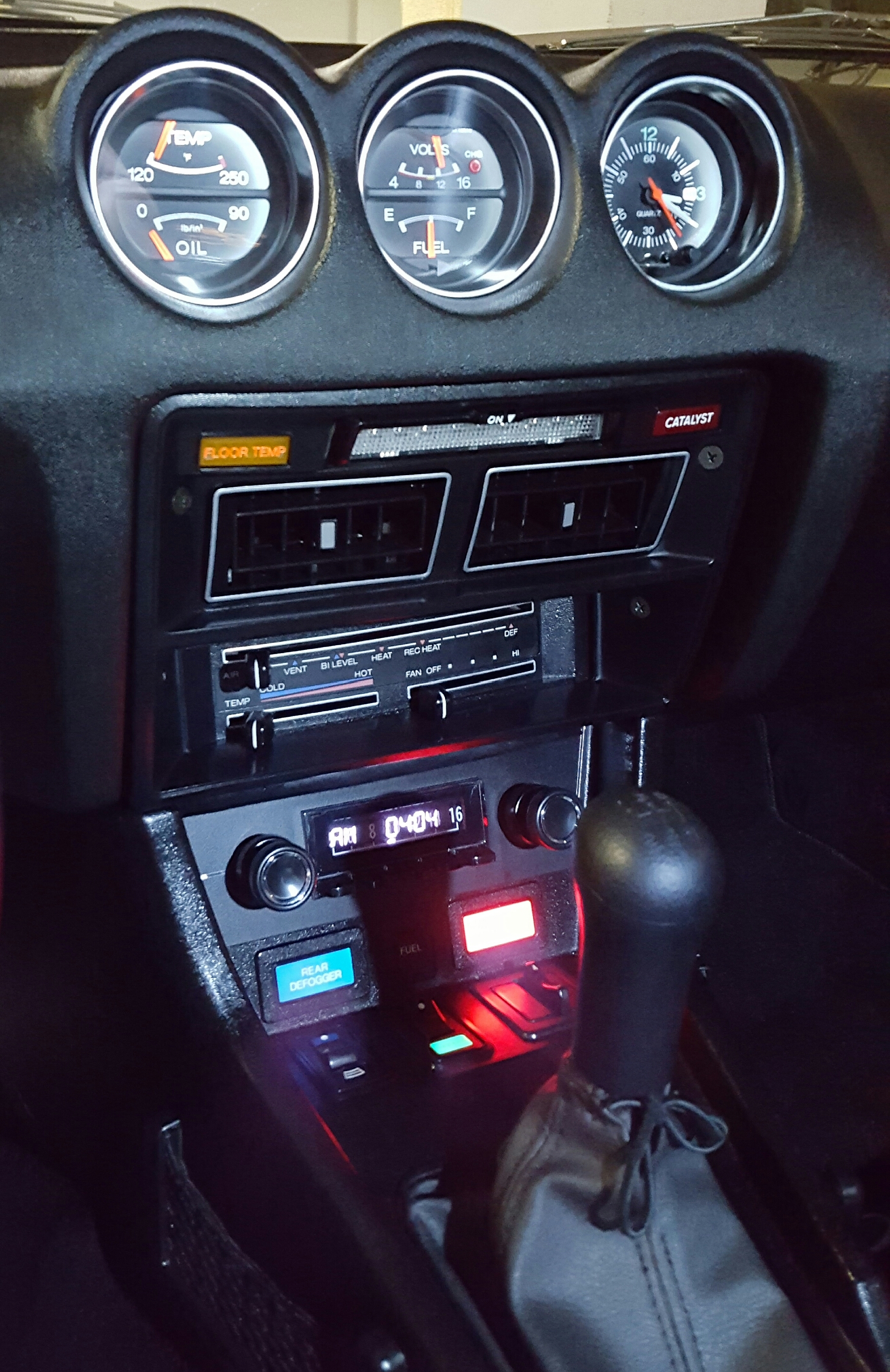

May 7, 20168 yr comment_494421 I have had a couple of nights driving with the LED gauge illumination, and I can tell you how nice it is to be able to see the gauges in the dark. The center gauges are less important compared to the ones in front of the steering wheel, and now I can read them all. The speedometer is easily read- even the odometers! And the other tachy is easily seen, even though you don't really need to tell the exact reading. So I think I can conclude my gauge illumination upgrade project, write it up for myself, and move on to the next thing. I appreciate the inputs and comments from everyone. Link to comment https://www.classiczcars.com/forums/topic/37915-sold-on-leds/?&page=16#findComment-494421 Share on other sites More sharing options...

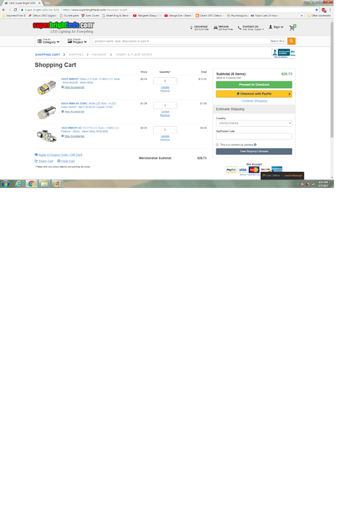

May 7, 20177 yr comment_520158 After reading, what is the most popular gauge replacement LED. I think the 5 LED tower bulbs were mentioned most and what about colors? Warm white, cool white or green? Thanks for any and all opinions. Link to comment https://www.classiczcars.com/forums/topic/37915-sold-on-leds/?&page=16#findComment-520158 Share on other sites More sharing options...
May 7, 20177 yr comment_520160 I need to find out what bulb is in the speedo and the tach and add them but here's what i think to start off with. Three 5 panel LEDs for the fuel/amp/clock gauges. Two 4 panel festoons for the map light and the dome light One 90 degree 4 panel for the glove box Link to comment https://www.classiczcars.com/forums/topic/37915-sold-on-leds/?&page=16#findComment-520160 Share on other sites More sharing options...

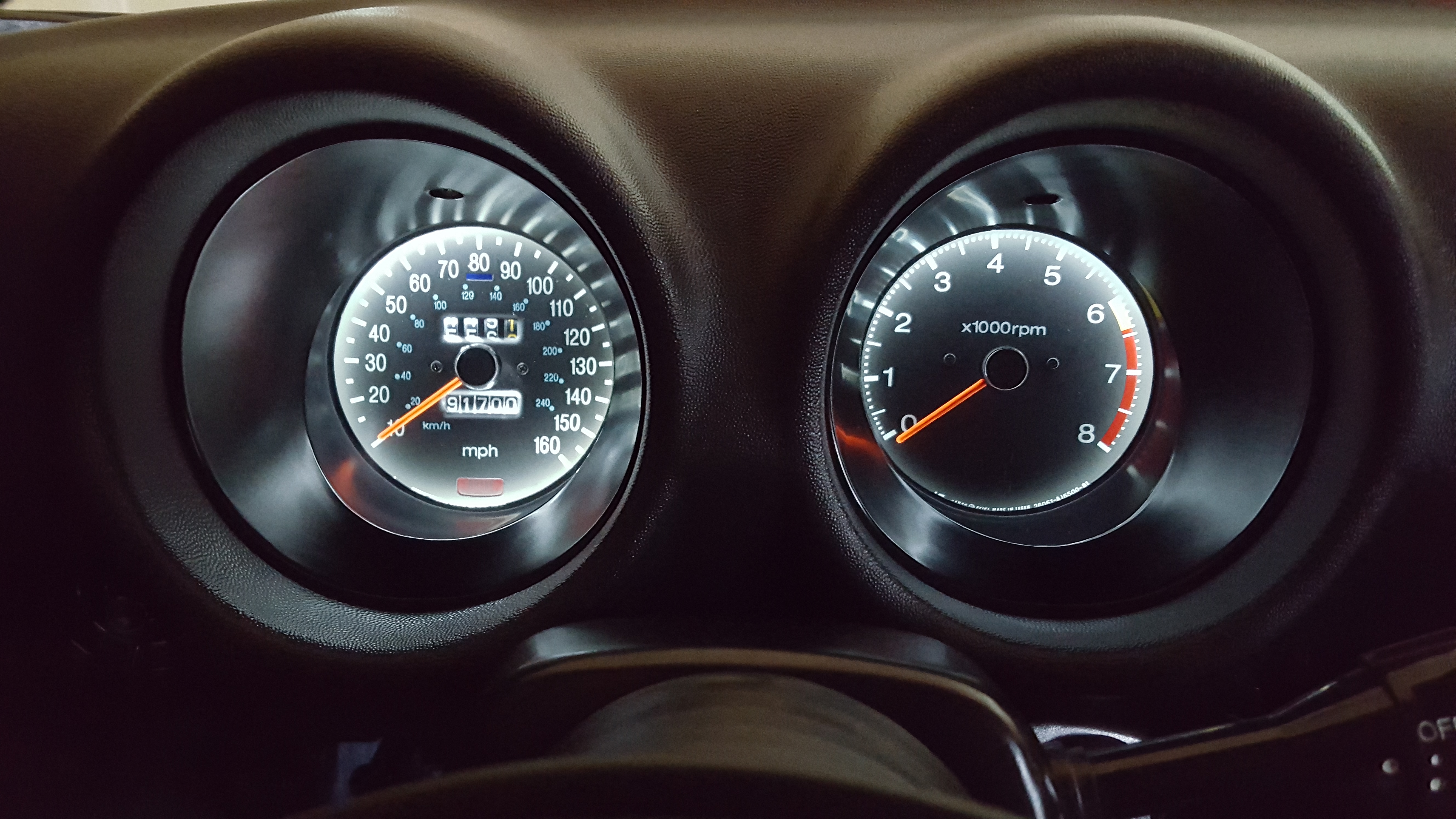

May 7, 20177 yr comment_520197 I went with all white LEDs in the instrument panel to unify the look of the LEDs on the maplight, courtesy light and glovebox light. Since I painted all my instrument needles fluo orange to match the second hand in the calendar clock, the white light picks up that orange nicely (much crisper than with green light). I left the original incandescent bulbs in the turn signal arrows because I just needed their green color to come through and they looked bluish with the white LEDs. The charge light on my voltmeter is also the stock bulb. If you have some incandescent bulbs in the circuit the light dimmer switch actually works much better than with all LEDs. Edited May 7, 20177 yr by dmorales-bello Link to comment https://www.classiczcars.com/forums/topic/37915-sold-on-leds/?&page=16#findComment-520197 Share on other sites More sharing options...
