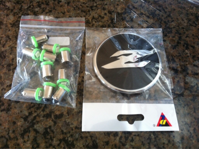

April 1, 20169 yr comment_491276 I bought these green BA9 LED units for my dash... Link to comment https://www.classiczcars.com/forums/topic/37915-sold-on-leds/?&page=9#findComment-491276 Share on other sites More sharing options...
April 2, 20169 yr comment_491450 Wheee, To each his own, but I've found those top broadcasting LED's created "hot-spots" of light and didn't do a great job of dispersing the light evenly inside the gauges. The farther from the edge, the better (like the clock), but I found the tach and speedo were problematic. It might just be me looking for "perfection" though. I sometimes see stuff that others don't. Can be a blessing or a curse. TomoHawk, That's a good idea with the marker for green. Hope it turns out as intended. I think I've nailed down my brightness changes and have all my gauges loaded up. I put my dash back in yesterday and have a couple loose ends to tie up today. Haven't been out on the road yet with streetlamps and oncoming traffic, but initial indications in the dark garage are promising. I'll post up some details after I've confirmed everything is done. Link to comment https://www.classiczcars.com/forums/topic/37915-sold-on-leds/?&page=9#findComment-491450 Share on other sites More sharing options...
April 2, 20169 yr comment_491464 I agree with Cap'n O about not using the LED bulbs with the end-emitters for gauge illumination. The top- emitter ones ought to be fine for the indicator lamps, like high beam, & turn signals. I'm using what we call 'paddlewheel' bulbs which only have axial emitters. If you want to, you can remove yjre top chips from the full-tower bulbs, so you can reuse the same bulbs. I even considered painting over the little tick marks on the tachys (with a DayGlo pigment & clear paint mix) to help them get illuminated or glow, like new cars have, but that would be a good thing or a bad thing, depending on how good your painting skill is. I think the ultimate thing would be to get a plastic gauge face made with the tick marks and numbers etched so the light shows through, like the heater panel does. Maybe someone here has the skill & equipment to make such a gauge face- only the Speed tachy needs it, who cares about the revs? Edited April 2, 20169 yr by TomoHawk Link to comment https://www.classiczcars.com/forums/topic/37915-sold-on-leds/?&page=9#findComment-491464 Share on other sites More sharing options...
