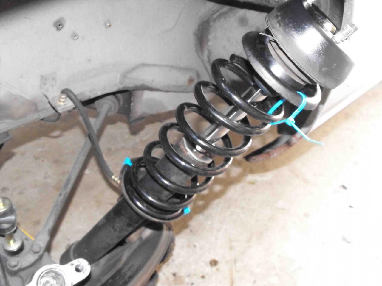

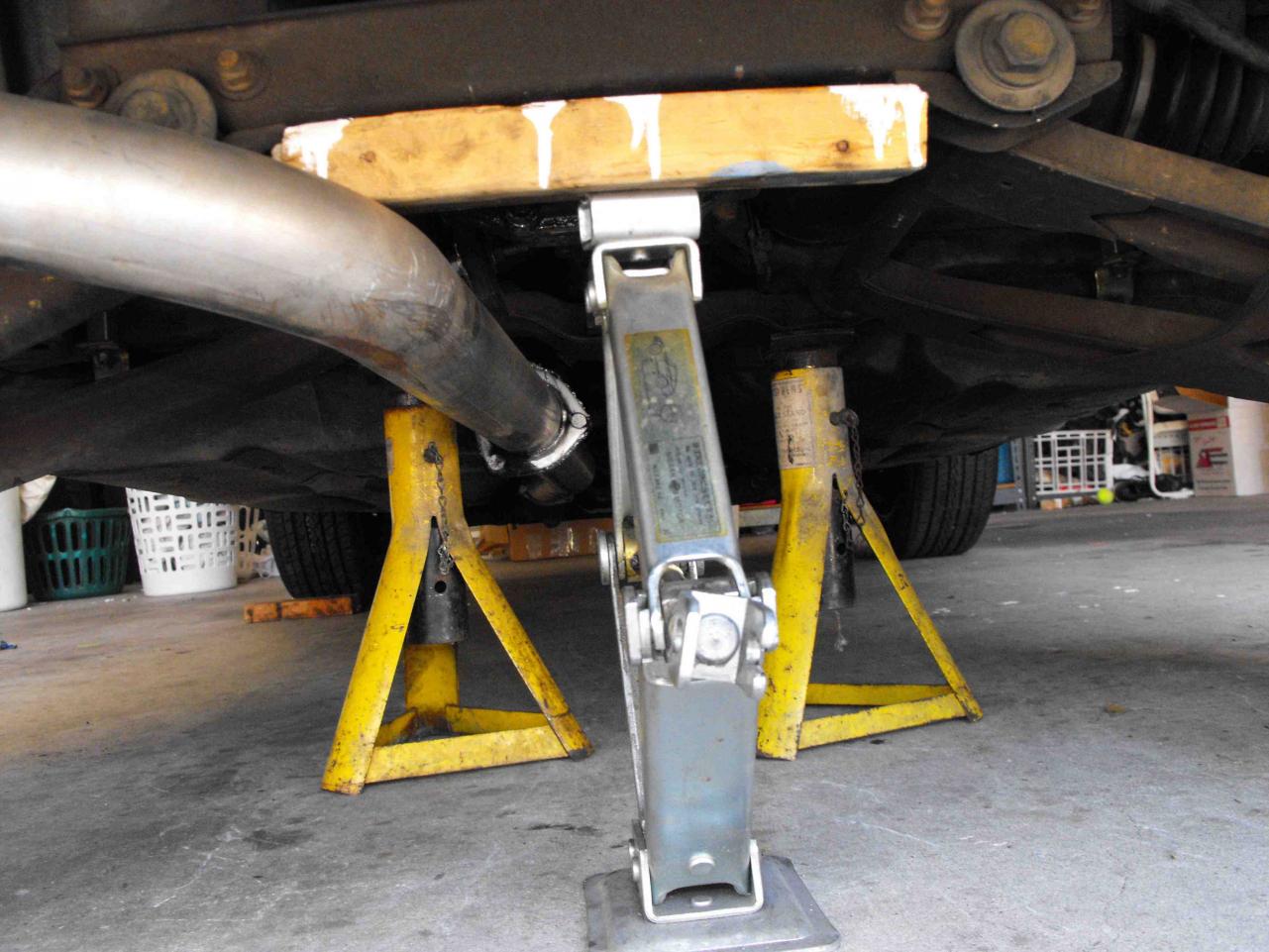

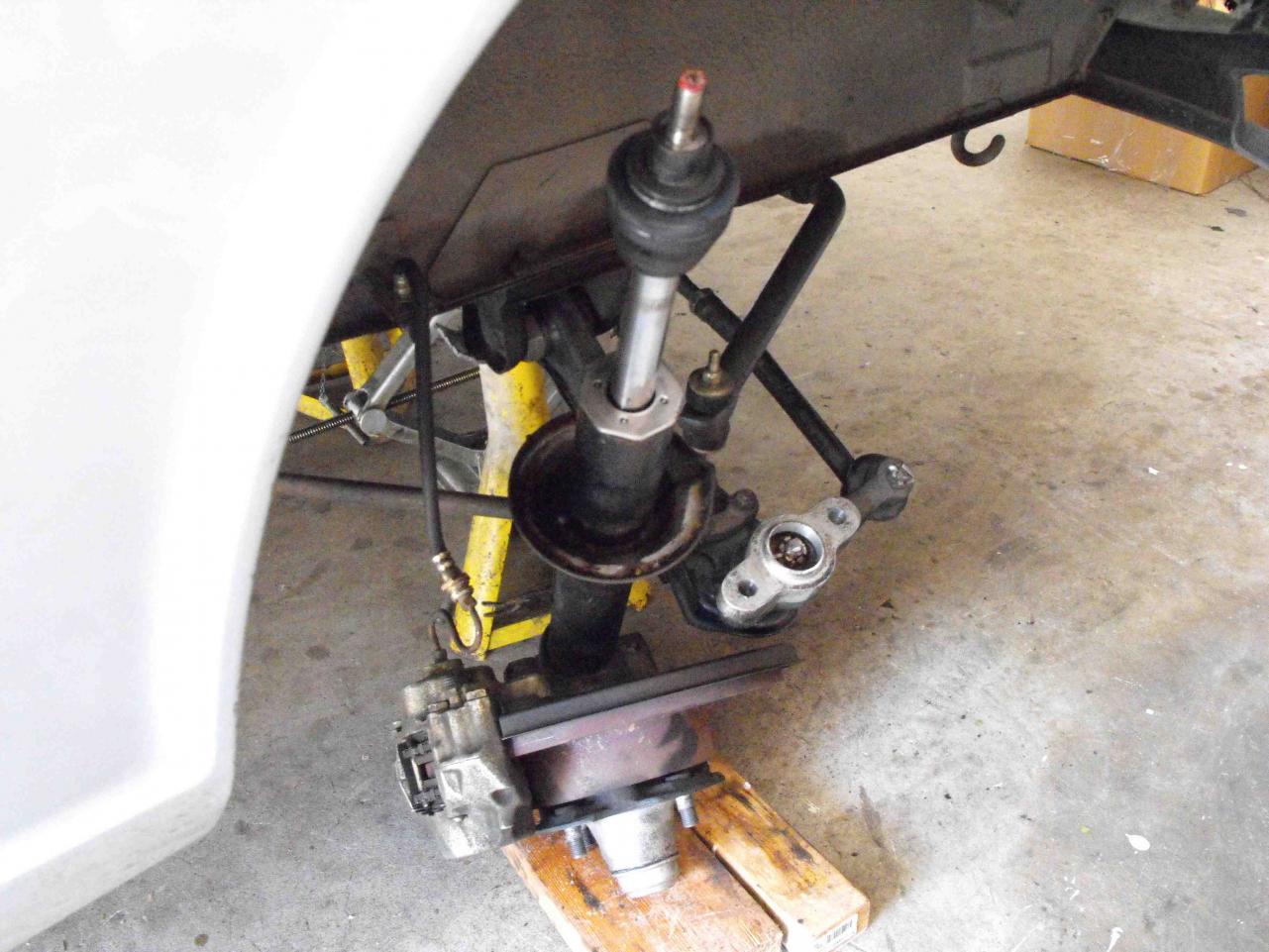

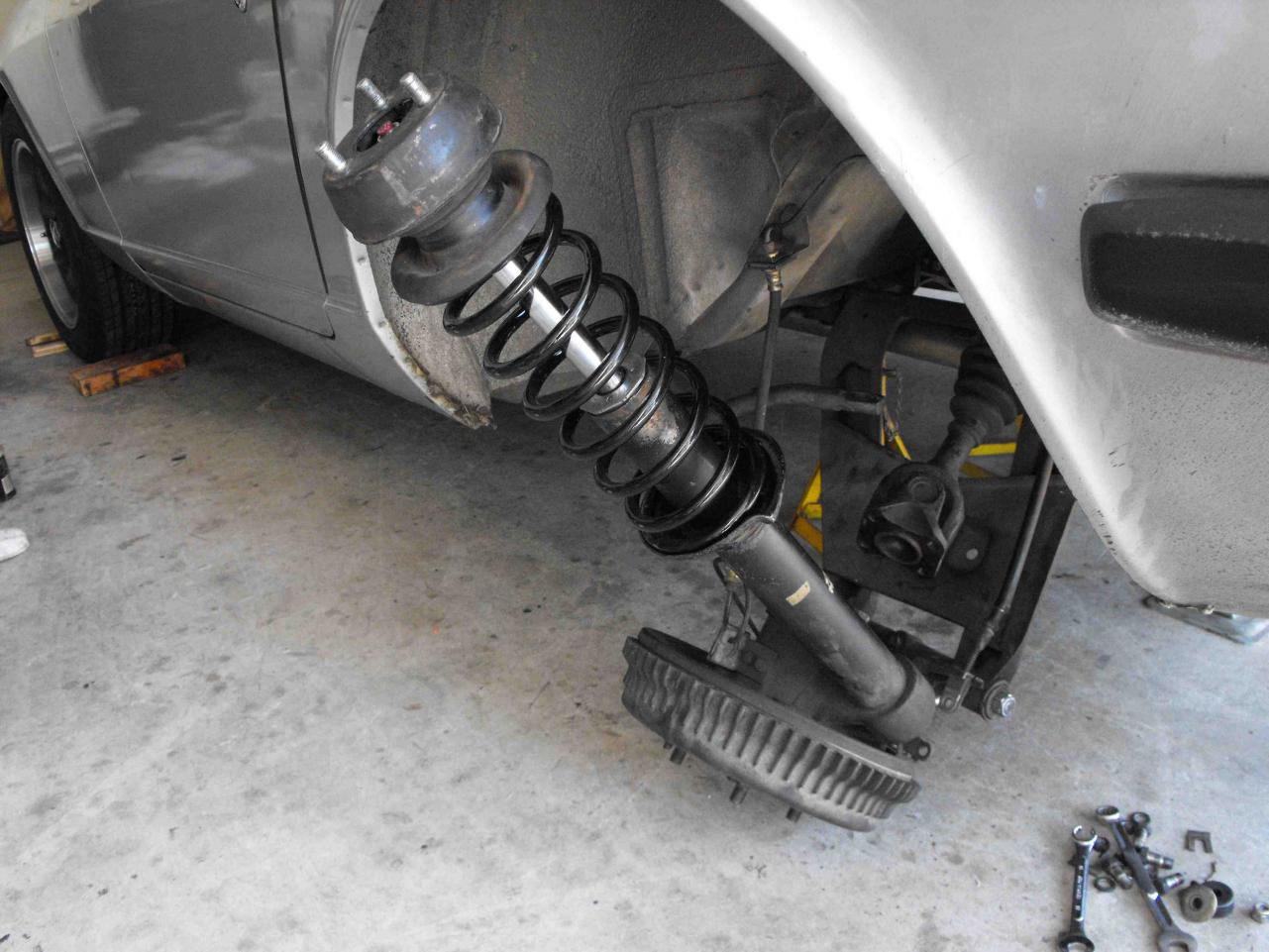

October 10, 200915 yr comment_297173 Got the springs changed out. Removed the Tokico 5020's and replaced with Suspension Tecniques Springs. The front end looks good, but the back end sags. Will have to do something about that. May just look for a set of stock rear springs. For a daily driver, I want something a bit softer. Still have the Illumina adjustable gas shocks and 1 inch sway bars front and rear, so it handles OK. The front springs were loose when installed (car on jacks) so I added some ty-wraps so they would seat correctly when I lowered the jack. Was able to replace springs front and back without disconnecting the brake lines which was nice. The rears were a bit more snug, but no need for a spring compressor. I figure it takes about 45 minutes per wheel to do the change out. Link to comment https://www.classiczcars.com/forums/topic/3793-quick-help-on-suspension-question/#findComment-297173 Share on other sites More sharing options...
