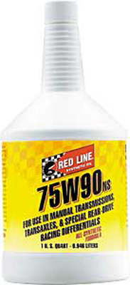

Thanks everyone for the help, trying to track down some Red Line MT90 and Red Line 75W90 gear oil, best deal i can find is around $70 for 3 qts of MT90 and 2 qts of 75W90 gear oil. Just need to get it ordered and hope all the plugs come out with out any trouble :)
Amazon carries it for about $12 a qt. if you can't find it locally. BTW, I don't think you need that much. I'm remembering just about 1 qt. for the diff and 2qts. for the trans. I'm not near my FSM, but you might want to check that first. No point in buying extra. You won't need to change it for a long time.
I thought i did the math correct, Transmission takes 4 1/4 pts. and Differential , if i have a R180 2 1/8 pts. or 2 3/4 pts. for the R200. Sorry this is one thing i have no idea what i have :disappoin i just calculated with 2 3/4 pts.
Then yep, you are correct. I guess I was basing the trans on what I actually used. It must have at least 1/8 qt. trapped. As for the diff, I was thinking of the R180. You have an R200 in your manual trans 280, so it will take over a qt.

A heat gun for a few minutes then 11/16's open end wrench tapped with short sledge hammer got the fill plug loose. It held 1 and 1/2 qts. Redline 75w90. The old looked like Sunkist and Coca Cola mixed coming out, kinda rusty brown. Thanks for the help.
