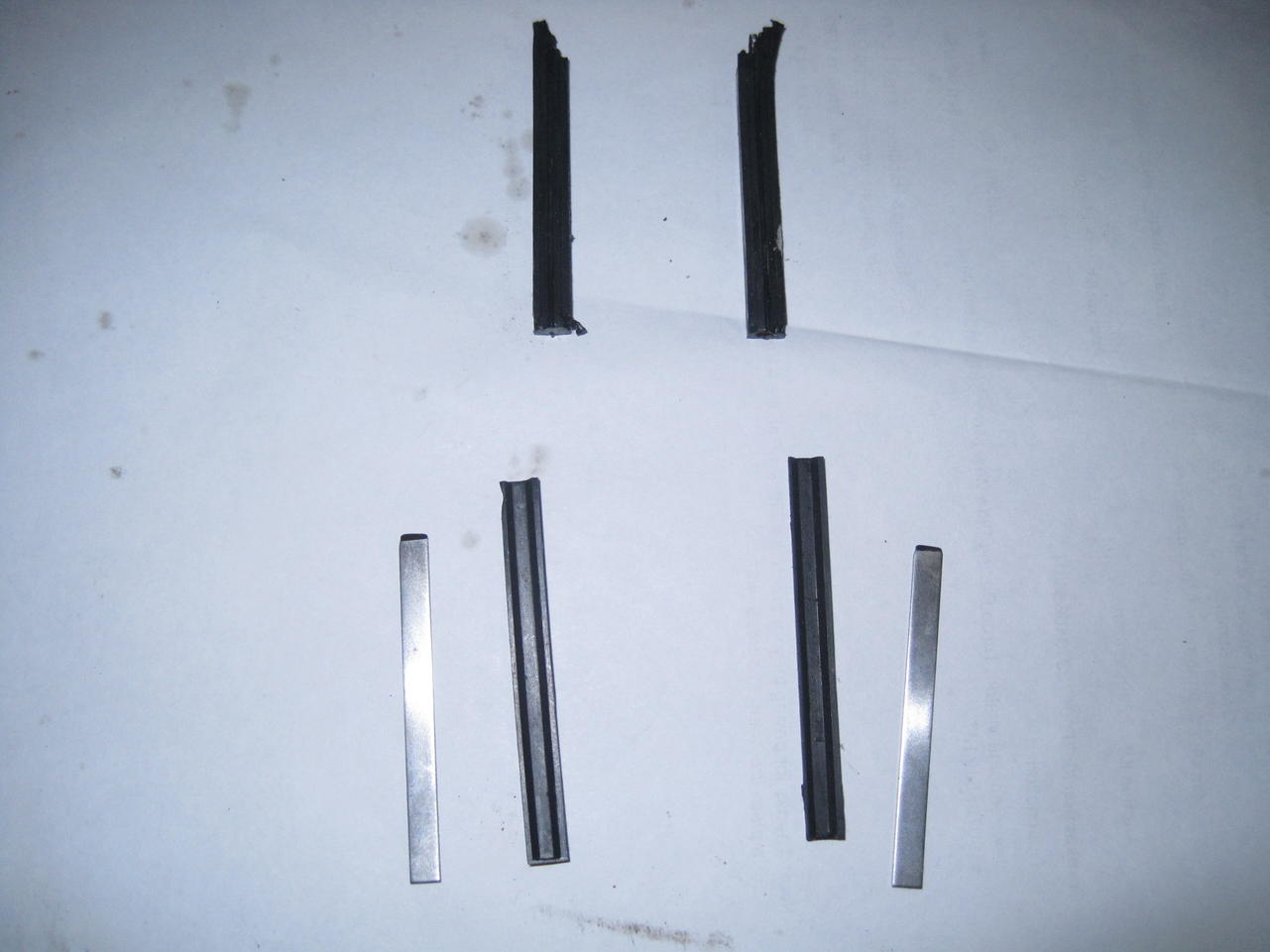

March 27, 201312 yr comment_418959 Well it's time for another attempt at fixing my oil leak. I have been truly cursed with this leak. I have replaced the rear main seal twice, the second time I used a speedi sleeve on the crank incase there was any bad spots. I have replaced the side seals also. I think this is an excellent thread regarding this issue so I will continue my saga here.Got under the car yesterday to find LOT'S of oil everywhere. Big reason was that one of my oil pump bolts was stripped and not holding enough torque to properly seal. I kind of knew that anyway, but blew it off until winter. I pulled the oil pan because I can only assume after reading this thread, and any other thread on this issue, that the side seals are the culpit. The side seals were really tough coming out. I actually made my own puller to pull the main cap, but the cap only came out about a half inch and stopped dead. I didn't want to force the issue with the cap, but it was enough to grab on to the side seals. The side seals were the one piece type and looked symetrical. The reason I say symetrical is because I read about proper orientation of the "lips". These seals had lips on both sides, so I can't see how I could have screwed that up. Also noted was that they were left abit long, I didn't snip them off flush with the cap thinking the gasket and sealer would cover for that.It took visegrips and a small prybar against the visegrips to pull these out.It seems with all my research that folks have had success with both types of seals-imbedded nail type and 2 piece nail type. Some have use sealant, and some not. Some say you have to pull the cap, some don't.Frankly, I am at a loss to what's going to work. I thought the Nissan one piece seal was the answer before, but I don't think it is the seal as much as the application maybe? What exactly is the sealant for? I have also read that some one that didn't want, or couldn't pull the cap injected some sealant into the slots of the cap before installing the seal. In other words, it was important to get sealant at the top of the seal? Edited March 27, 201312 yr by madkaw Link to comment https://www.classiczcars.com/forums/topic/38073-fk-i-think-my-brand-new-rear-main-seal-is-leaking/?&page=6#findComment-418959 Share on other sites More sharing options...

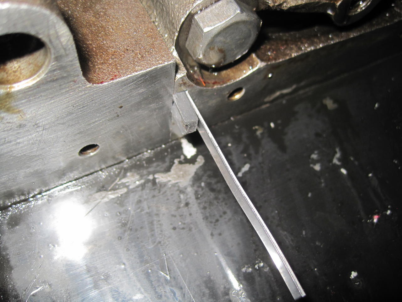

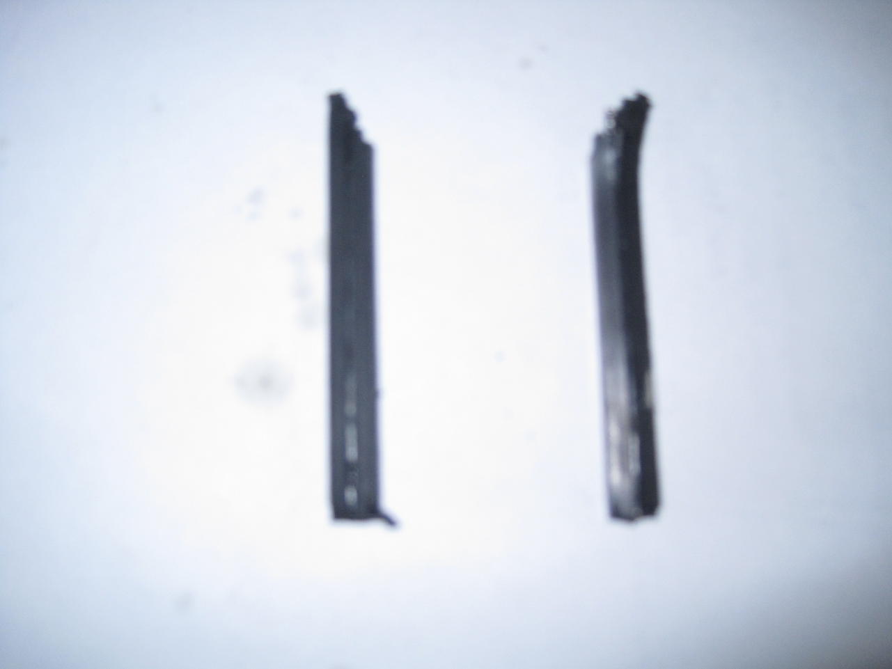

March 30, 201311 yr comment_419153 Maybe this thread is too old to get any love, but I will continue on. I took some pics of the two types of side seals. I also hopefully demonstrated the correct way to insert the side seals. I took a lot of time to clean everything out, especially the cavity for the side seals. It is now oil free and dirt free. I squirted brake cleaner up in the hole to get it sqeaky clean so any sealant I put on there will be more effective. Link to comment https://www.classiczcars.com/forums/topic/38073-fk-i-think-my-brand-new-rear-main-seal-is-leaking/?&page=6#findComment-419153 Share on other sites More sharing options...
March 30, 201311 yr comment_419155 You didn't cut the excess off? That might have caused your leak. I've always stuffed them down and then trimmed the rest off. I've never had a leak.One thing your pics don't show is the right way to insert the steel strips. The bevel needs to be such that the longest part is against the block and not against the rubber. If the sharp edge is towards the rubber, it can slice it. Good luck Steve! Link to comment https://www.classiczcars.com/forums/topic/38073-fk-i-think-my-brand-new-rear-main-seal-is-leaking/?&page=6#findComment-419155 Share on other sites More sharing options...
March 30, 201311 yr comment_419157 Sorry Jeff,but I read your post and i can't picture what you are describing.I'm not understanding the beveled edge part.I just shoved the seal and steel strip in the block part way to show and verify orientation-it is correct-- right???? Link to comment https://www.classiczcars.com/forums/topic/38073-fk-i-think-my-brand-new-rear-main-seal-is-leaking/?&page=6#findComment-419157 Share on other sites More sharing options...
March 30, 201311 yr comment_419162 Steve, the steel strips have a blunt end and a sharp end. The sharp end goes inwards, but if you look close, it is beveled like a wood chisel. Like a wood chisel, if you put the sharp edge towards the seal, it can slice into it. Instead, you face the sharp edge towards the iron block to protect the rubber seal. Does that make sense? I'll see if I can find a picture of one. Link to comment https://www.classiczcars.com/forums/topic/38073-fk-i-think-my-brand-new-rear-main-seal-is-leaking/?&page=6#findComment-419162 Share on other sites More sharing options...
March 30, 201311 yr comment_419164 I think I get it. I know one end is sharp,and there are two different sides to that sharp end. I guess I didn't even think about the beveled edge being a problem. So the side that has NOT been ground down is considered the sharp edge--so it should go against metal?? Trying to picture it as a chisel. Link to comment https://www.classiczcars.com/forums/topic/38073-fk-i-think-my-brand-new-rear-main-seal-is-leaking/?&page=6#findComment-419164 Share on other sites More sharing options...
