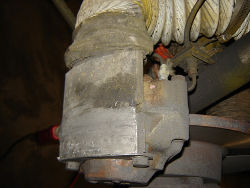

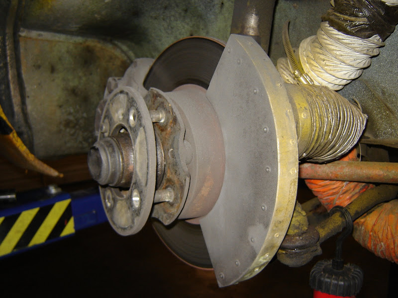

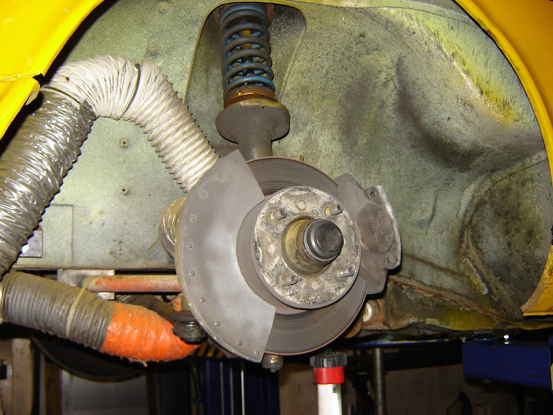

Here are some pictures of my brake setup. 2 3" lines to each shroud. Excuse the dryer duct, this was done by the previous owner and has been corrected. FWIW, I run hawk HT-10 brakes in front, and OEM drums in the rear with carbotech shoes. My brakes don't work well until I get several laps on them in a session/race but then work very well, for even the longer races. I do burn out the caliper seals after about 2 races. I check them after every race and rebuild/replace the calipers as needed.

Now for the pictures:
A better picture of my current set up
FWIW, this setup was used on my car to win several endurance races on the "left" coast before the car migrated East :)
