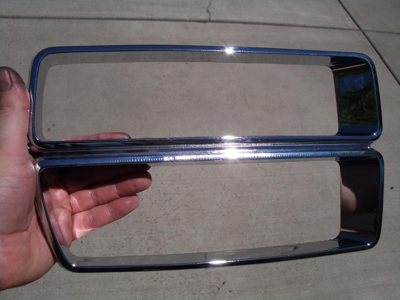

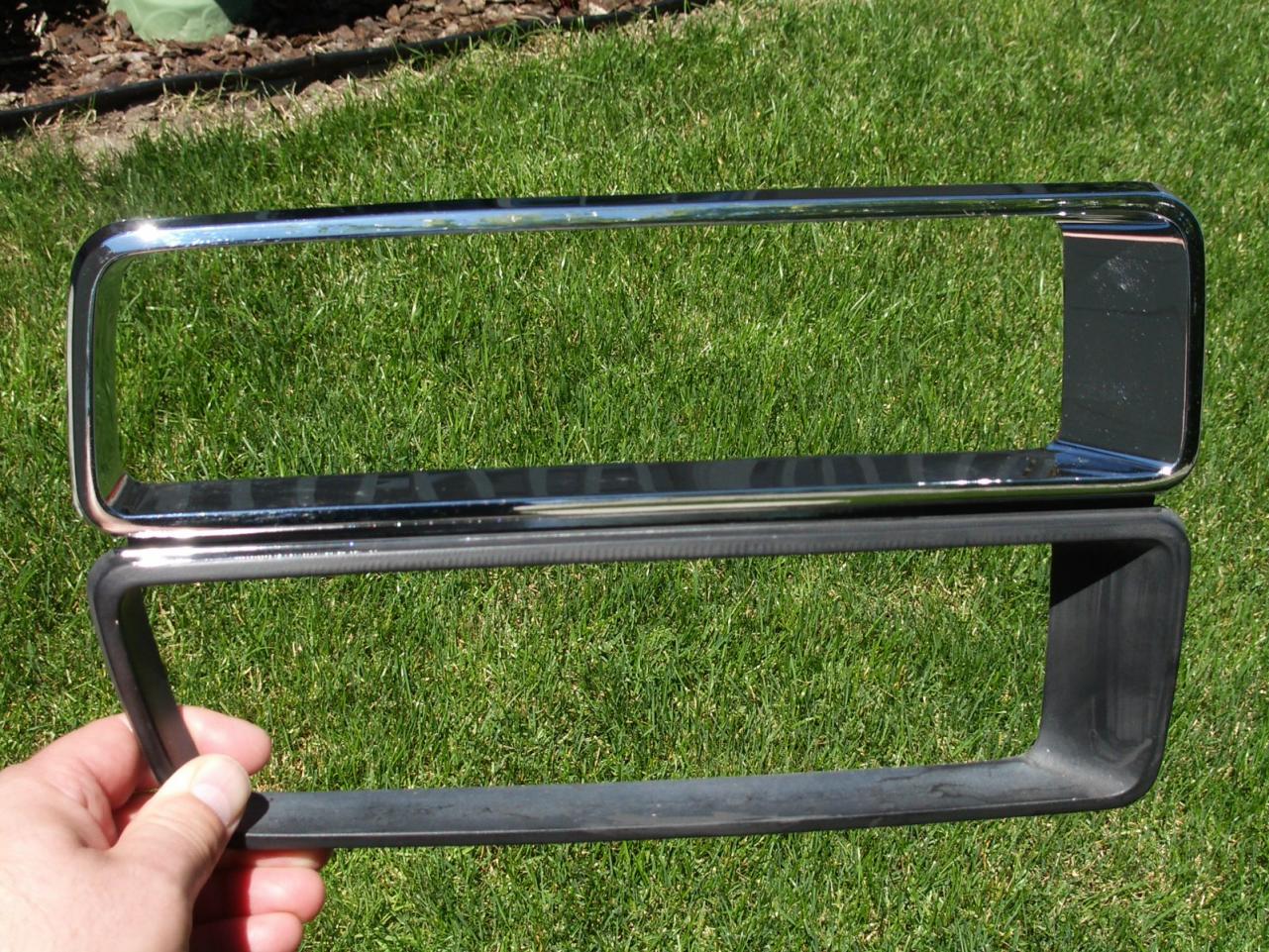

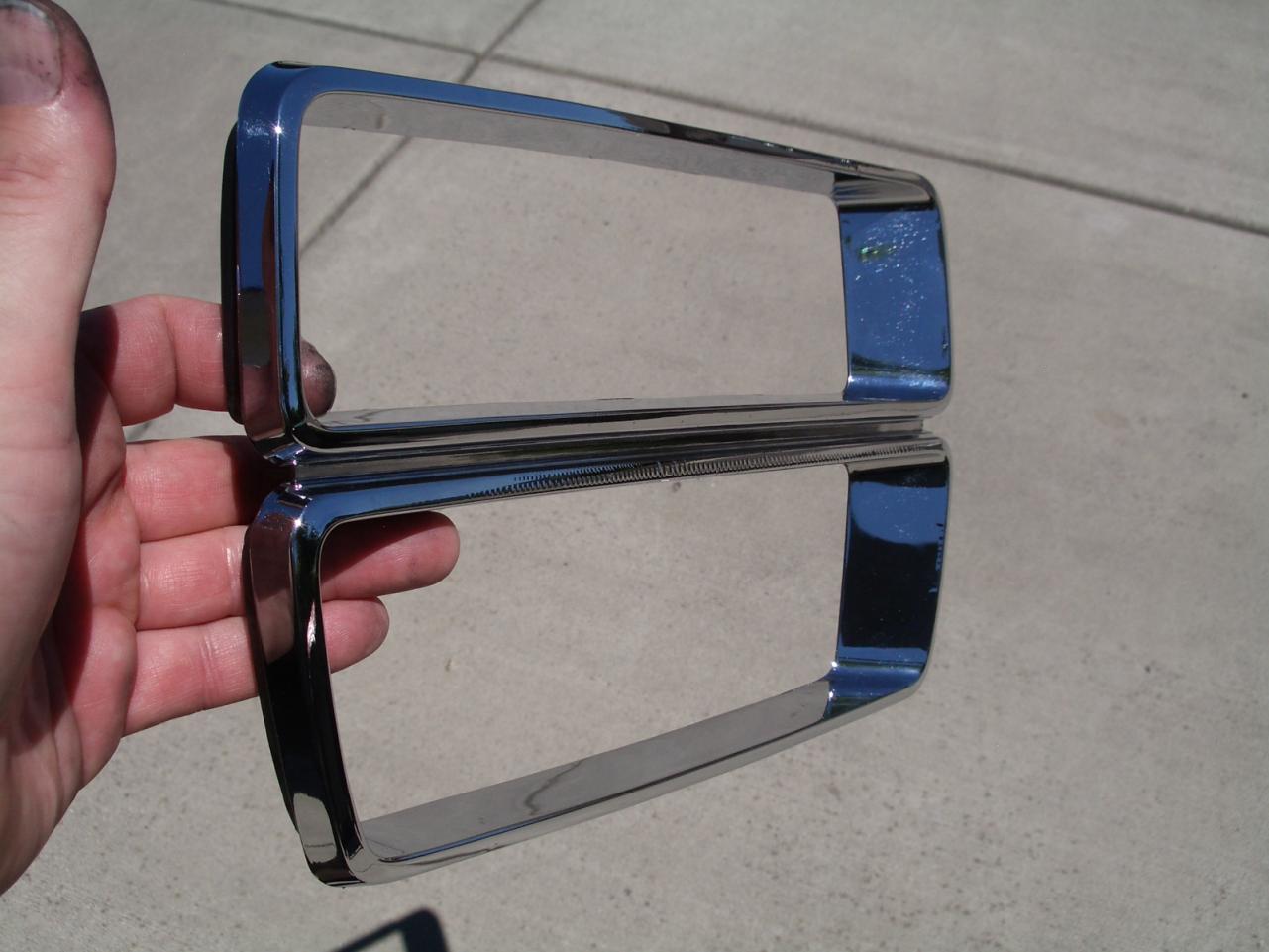

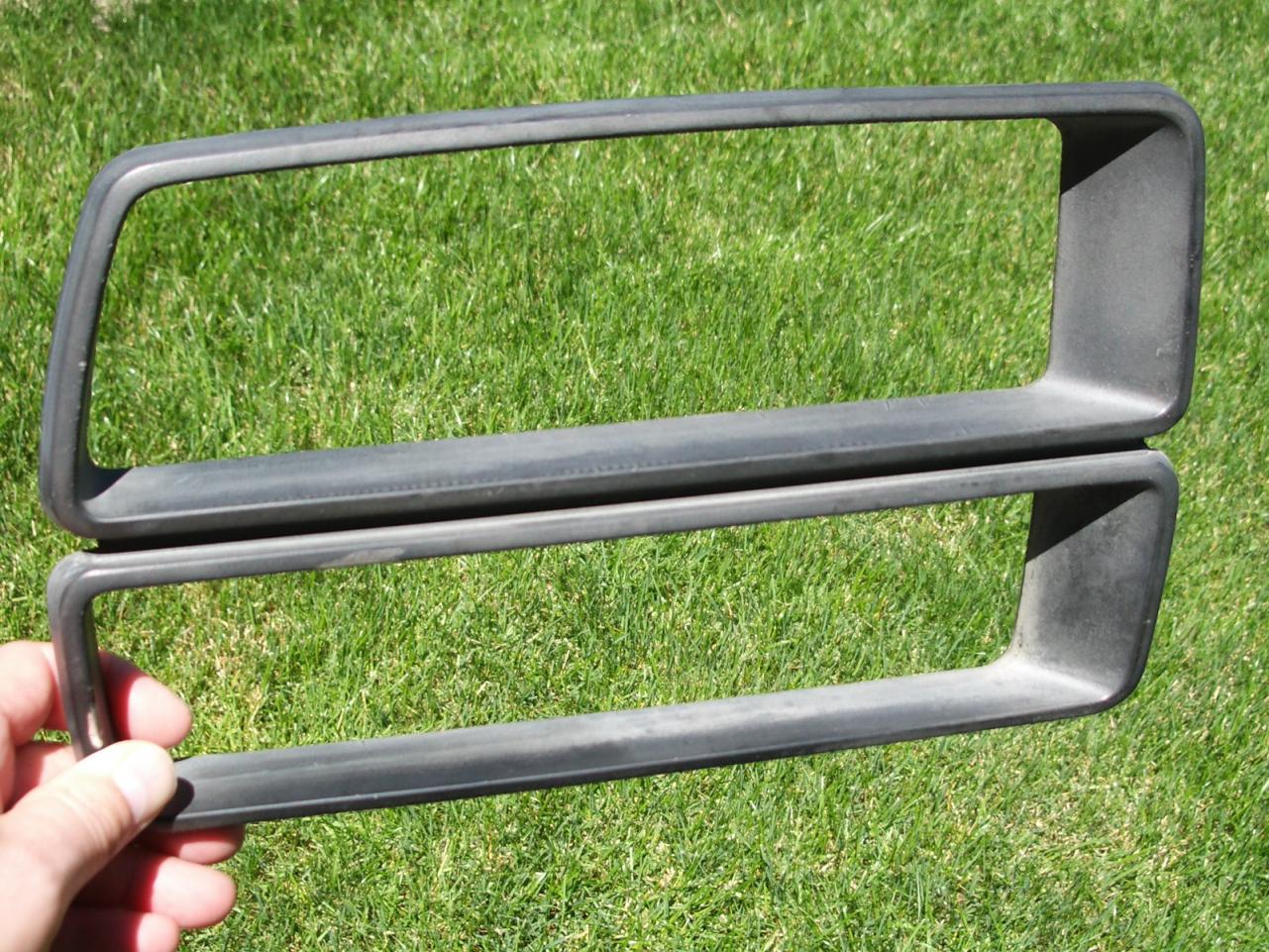

June 15, 201113 yr comment_358757 Removed the 30+ year old black paint from the tail light surrounds of my 260Z using 0000 steel wool and a bit of lacquer thinner. It took about 3 hours to completely remove the paint from one surround. Completed one and got half way through the other. Was cursing some nameless PO but thought better of it after seeing the condition of the chrome underneath. It certainly wouldn't have been in this condition without the paint covering it for all those years. Some before and after photos... Link to comment https://www.classiczcars.com/forums/topic/38099-2011-what-did-you-do-towith-your-s30-today/?&page=11#findComment-358757 Share on other sites More sharing options...
June 15, 201113 yr comment_358863 Wow I wish they had painted over mine now. Link to comment https://www.classiczcars.com/forums/topic/38099-2011-what-did-you-do-towith-your-s30-today/?&page=11#findComment-358863 Share on other sites More sharing options...

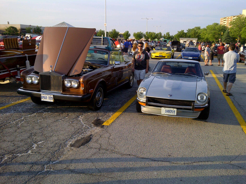

June 16, 201113 yr comment_358879 Look what came and parked beside me:laugh: Burlington Ontario on a Wed. evening. You need an engineering degree under the hood of the Rolls! As usual the only Datsun:cool: Casey Link to comment https://www.classiczcars.com/forums/topic/38099-2011-what-did-you-do-towith-your-s30-today/?&page=11#findComment-358879 Share on other sites More sharing options...

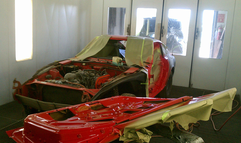

June 17, 201113 yr comment_358974 I visited the car at the body shop. It is finally getting paint! Link to comment https://www.classiczcars.com/forums/topic/38099-2011-what-did-you-do-towith-your-s30-today/?&page=11#findComment-358974 Share on other sites More sharing options...
