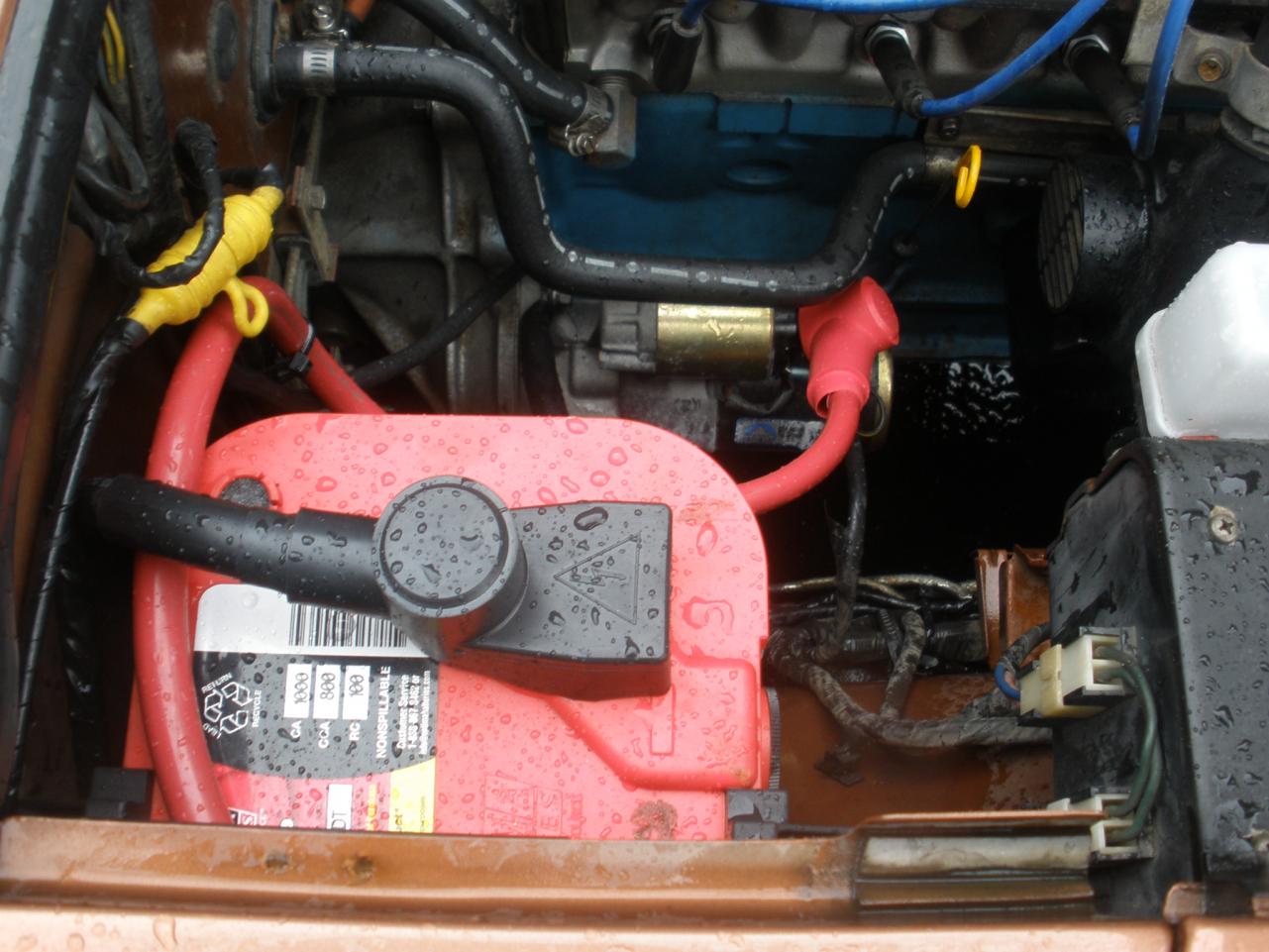

April 1, 201113 yr comment_351724 Finally switched out my battery cables...Used 2/0 ground, and 1/0 starter positive,(replacing the original tiny cables) and additional grounds to firewall(4 guage) and from intake manifold to inner fender(8 guage.) All connections heat-shrunk and new marine-grade terminals,covers, and cable used...Better than new. tommorrow I hope to swap my headlight harness's(originals old and loose-fitting to headlight,potential for meltdown...) and install new marker lights, if they ever arrive... Link to comment https://www.classiczcars.com/forums/topic/38099-2011-what-did-you-do-towith-your-s30-today/?&page=7#findComment-351724 Share on other sites More sharing options...
