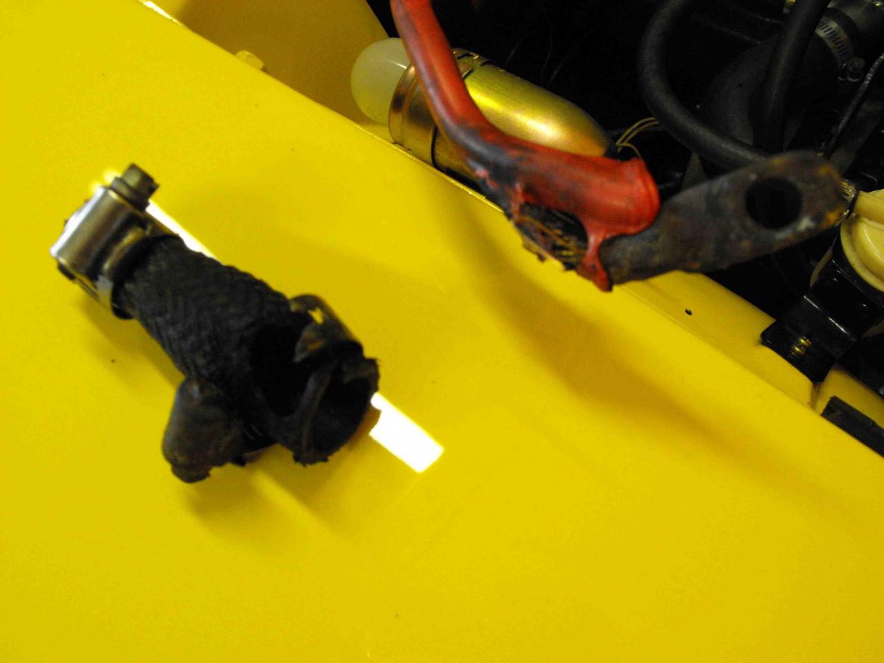

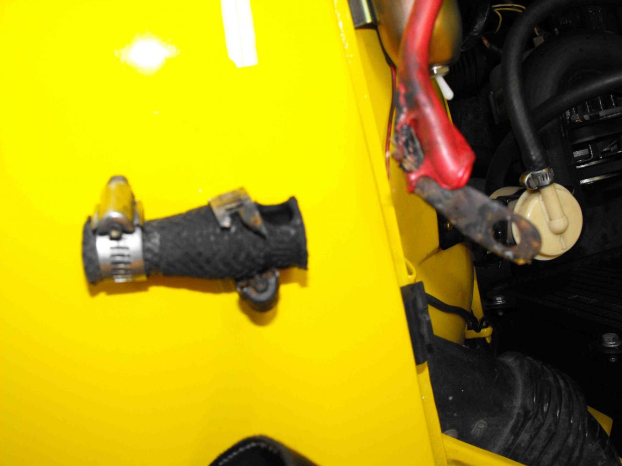

Coming home from work, noticed the engine was hot and steam coming from right side of hood. Pulled over at nearest gas station to find the problem...not hard to find. Looks like a little un-authorized Arc welding took place. Attachment of battery cable to solenoid was loose (even with lock washer), and cable rotated up touching hose clamp that was touching engine block. Circuit complete for arc weld. Totally melted clamp and put hole in hose. Never had that happen before. Easy fix though. McGyver'd it to get it home, then replace clamp, trimmed hose, taped cable and re-tightened. Easy fix.
Not Cool, but interesting. That's a good reminder for the rest of us to check the torque on the fasteners. I'm glad that is all it did you have a nice car and would have hated to see it damaged because a 50 cent nut and 20 cent lock washer went
