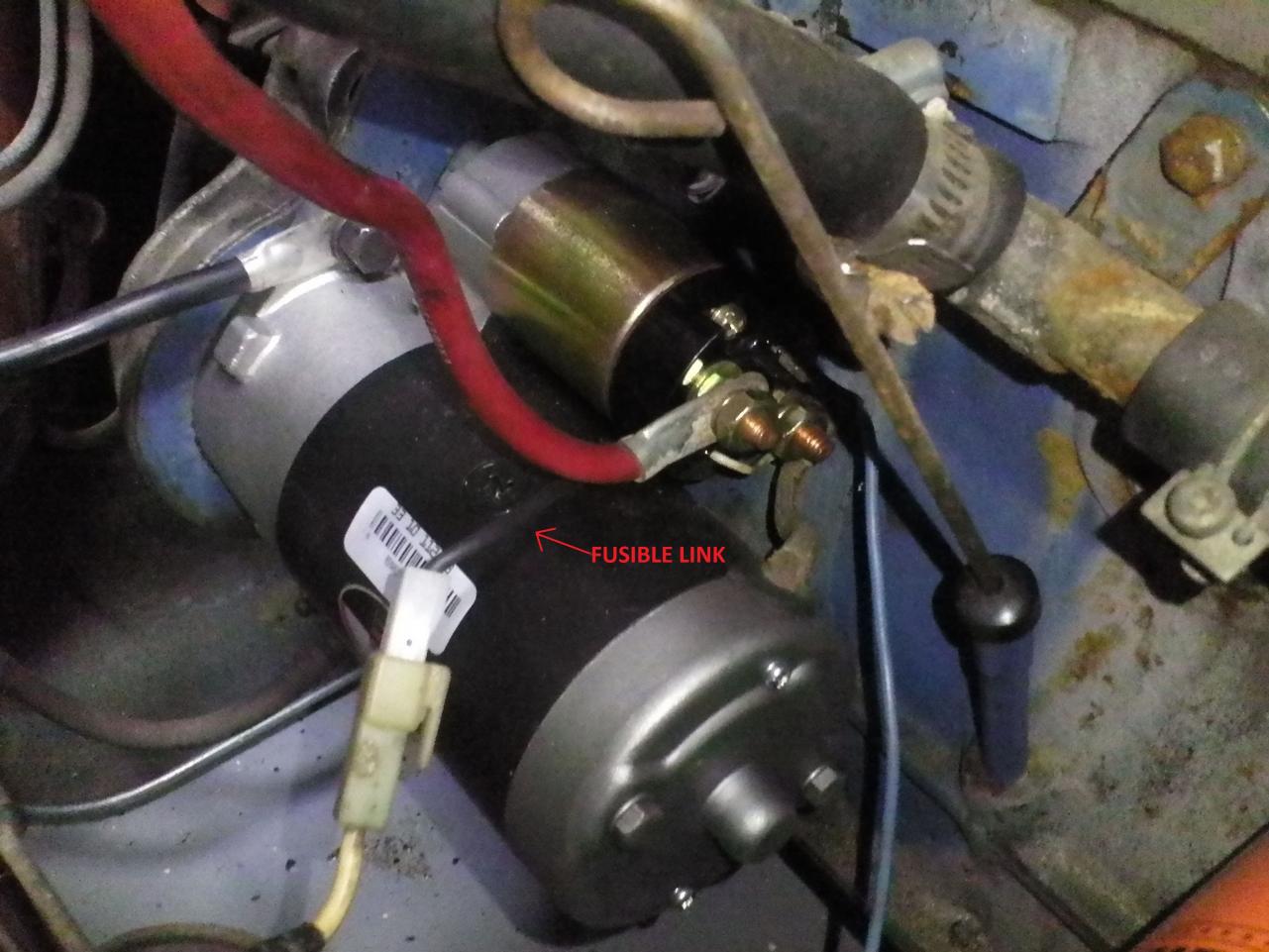

On the starter you should see the battery cable and a small black yellow wire going to the solenoid, the 10 gauge white wire coming from your engine harness should connect to a fusable link or hard-wired to the starter bolt that the battery cable is attached to.
9 times out of 10, the Previous owner has bypassed it or screwed with it somehow. Just look for a 1/4" thick wire coming out of your engine harness and going to your starter, bolted to the same bolt as the battery cable.
