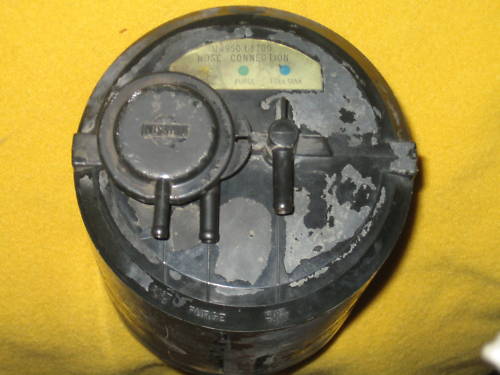

Looks like the PO (Previous Owner) has made some changes...Hmmm...go figure...here's a picture of the "Vacuum Canister"...might help some with the connection for the rubber lines...and another picture with the connections... should be pretty near what you have as it's for a 75 280Z...

Charcoal canister is obviously Not 100% needed but if you want is to all work correctly, then I would likely reinstal one. It's an emmisions part.

Part number appears to be the same...14950-N4800...see following url for part numbers for the various items listed...item #13 would be the vapor canister...
and item #19 for the bracket...item #20 will be the mounting screws (6mm x 1.0 x 20mm) Vapor canister appears to be somewhat universal as I see no "years" listed out to the side...
http://www.carpartsmanual.com/datsunS30/DatsunFairladyZIndex/Engine280Z/EmissionControlDevice/tabid/1601/Default.aspx

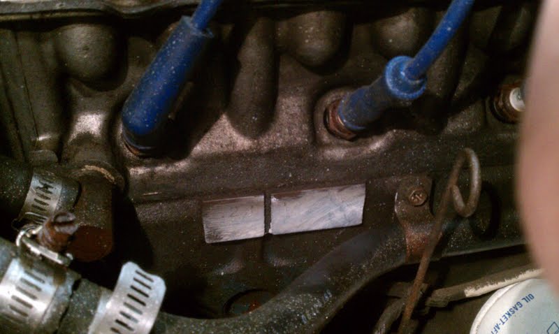

As far as the original engine, there should be an ID plate on the right front strut housing with the engine # on it. There is a stamped # on the block at the right rear area, betw. the 5 + 6 sparkplug area. Compare the two to see if they match. also agree that there is a heater core leak; that is why the coolant lines are disconnected as they are.
Engine Tag reads = L28 100516 - but could not find matching tag on front right strut housing

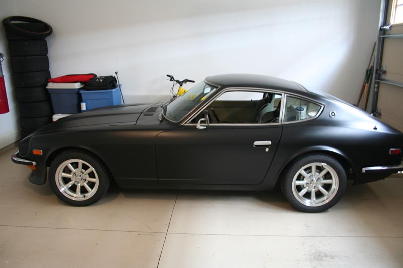

Moonshine from the picture in post 4 your car was originally 302 green leaf metallic like my car. Look at the hood latch for the original color. The color seems to be rare, any way I have not seen many in pictures or in person.
I have a lot of pictures of my car in original condition, if you need me to get some to you let me know.
