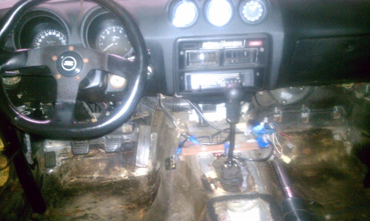

Moonshine from the picture in post 4 your car was originally 302 green leaf metallic like my car. Look at the hood latch for the original color. The color seems to be rare, any way I have not seen many in pictures or in person.

Well, I would say it has a leak in the heater radiator.

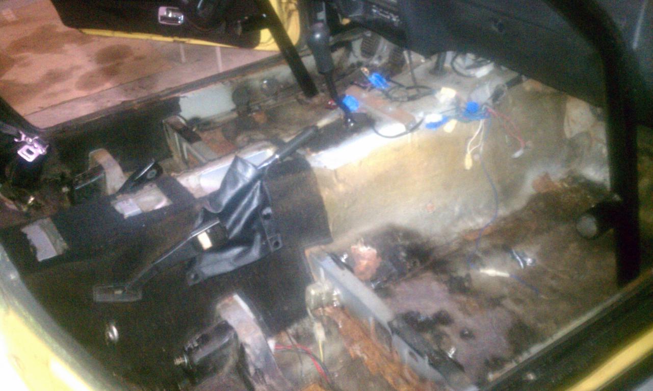

removed many interior components today -after inspecting heater core - seems as if the green stained neon leakage is stemming from the heater hose flanges/heater valve - untightened laziness?? came too far not to have the heater core removed/refurbished - in researching - heater valve usually is the first to go - o-ring inside and seal outside is notrious for fouling - lack of flushing - anti-freeze/water ratio - unbalanced - update/photos to follow - tomorrows project :stupid:
Interior tear down - as previous noted - problem with the heating - during diagnostic - few weak clamps seemed to be the problem - many visible neon green anti-freeze stains on the stems on the heater control valve & heater core inlet/outlet - one unstock hose was forcibly pinched which perhaps caused a weak spot - i would say it is imperative to have the correct hoses in place - along w/ reputable - stainless steel clamps - and most definetely replacing clamp that can be tightened with a socket - phillips heads on originals were corroded - not fun removing and not an easy spot to work in - thorough cleaning of all units - heater coil refurbishing is worth the extra bucks in the long run - one link i found to be very helpful to remove/replace heater coil -

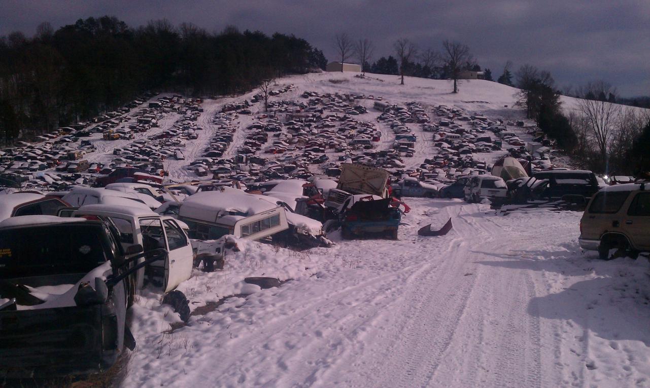

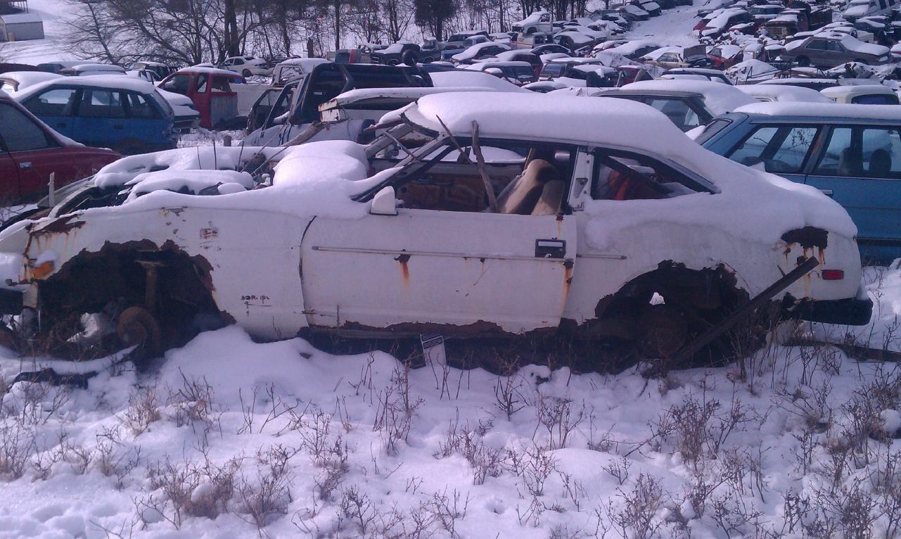

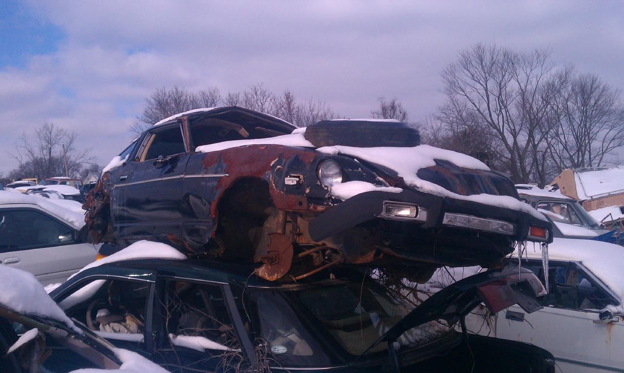

In calling a few junkyards in a 20 mile radius - i found a few Z's - there are some silly misc parts i need for the build - dash bracket, door handles, seat belt covers, emissions canister/bracket, switches.... photos above is a yard a few miles from me - he had 3 Z's - found everything i needed & w/in budget - yet a bit depressing to see these neglected gems in a sea of rust/metal
